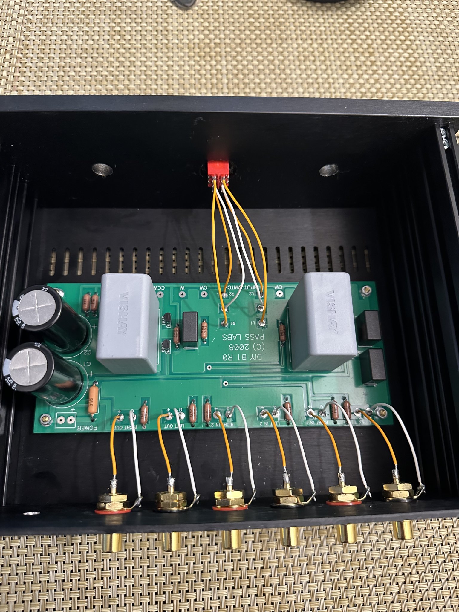

B1 buffer wiring?
Hello all, I have almost completed my b1 buffer and have 1 question about the wiring for the input switch. can someone tell by the pics if this is correct or will I have to do some rewiring
I haven't built it but that looks right according to the text on the PCB. If you want to do a double check, you can check L1 at the + of the RCA to the middle white wire after the switch (I assume input to the linestage) with an ohm meter. Then flip the switch and see if the reading changes. Should be closed or open. Then do the same on the other side.
Nice and tidy build BTW! That is a nice PCB.

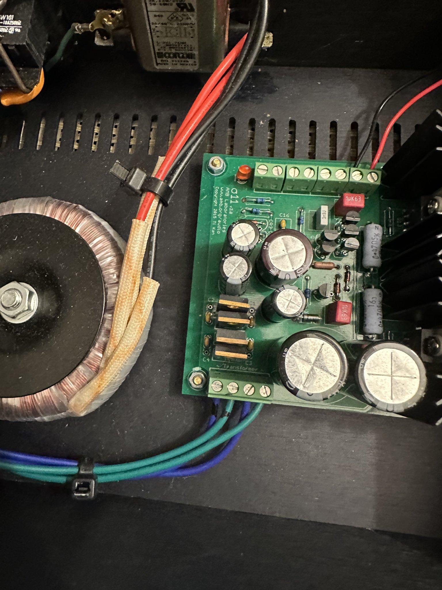

Thank you, although still have a lot to learn about electronics. I feel that my soldering skills are getting better. I have a separate power supply Q11 that's in the same size chassis. Might be a little overkill but I can use the power supply for my new tube korg also. I may also squeeze in a filter in the same chassis...got plenty of room.

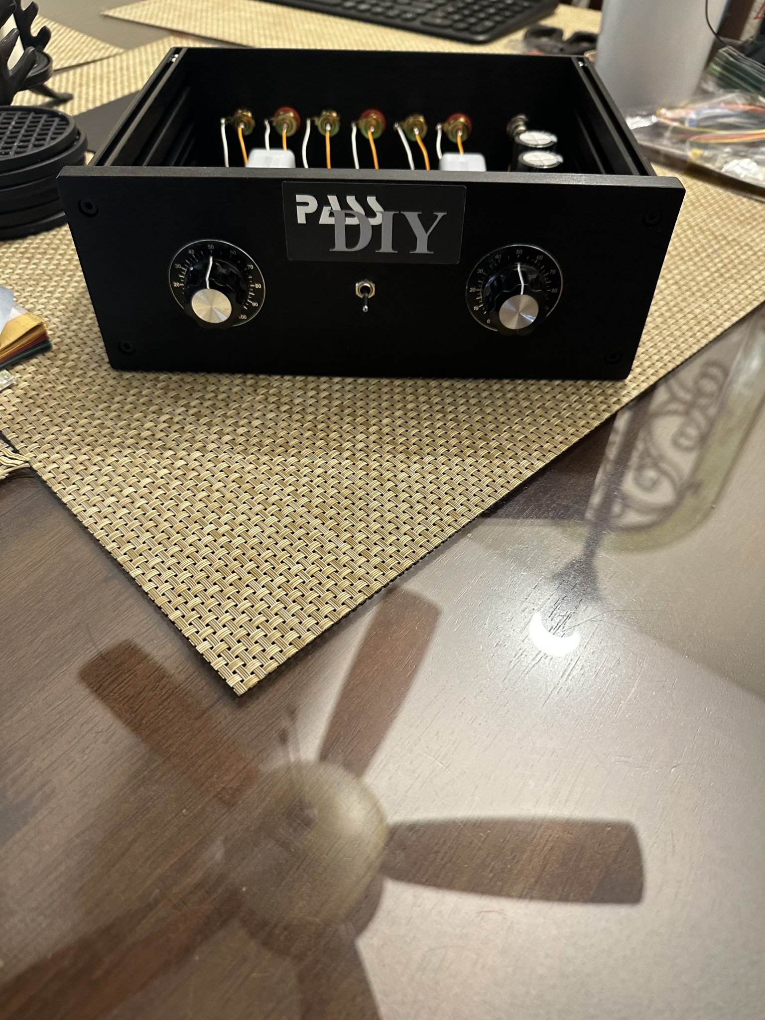

Nothing wrong with giving the B1 a good meal. Shoot some pics when you get it wrapped up. 🙂
