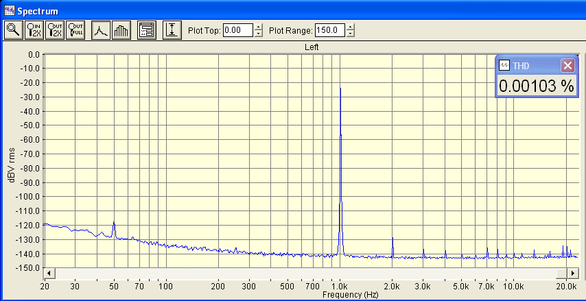

I have found +/- 10V to be optimum subjectively in my non coupling caps version. I have started from +/- 8V, gone up to +/- 15V. It will not be surprising for +20V to be so for the normal version too. Just listen to voltages between 18-24V if possible.
I attach an FFT of my version at half volume knob rotation. Some high frequency minute spikes are present in my card's loop too.
Input=1VRMS=0dB.
Input=1VRMS=0dB.

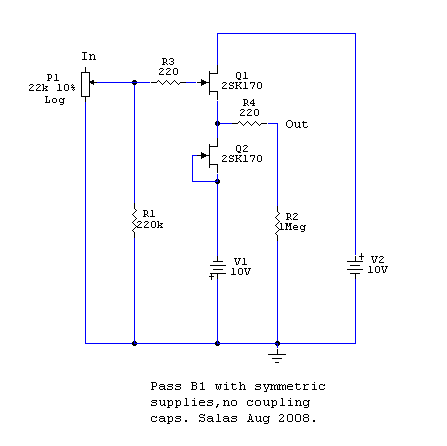

Nice PCB but just a question: are the input and output caps not too close to eachother ? Or it could be that the yellow ones are input caps ?!
BTW You could have omitted input/output caps if you would have used the schematic of Salas ( symmetric B1 ).

jean-paul said:Nice PCB but just a question: are the input and output caps not too close to eachother ? Or it could be that the yellow ones are input caps ?!

No you can't with the original schematic but you can with Salas' version. Please see post #466.

interesting one! more simple with no input/output caps, but have a relay's. for what ?
can i remove this relays if i want to build this version ?
is there worth to build this salas version ? different sound ?
Many Thank's
La Ode
I put the relay there just to avoid possibilities of thumping sounds if turning on the B1 while the main amp is on. Not essential, you can skip it, but do the classic procedure of turning on main amp last, turning it off first. The sound will miss any coupling capacitors signatures, so that will be its difference from a standard B1.

+/- 10V is the best sounding voltage point I have finally chosen.
That ''bleeder'' resistor is to help discharge the timing circuit. The 7812 is powering that circuit. You will have to omit all that part. Only use the 1Meg resistors to ground. Also try 220R gate stoppers and 220R output series resistors if you can attach them directly to the Jfets. It will sound more dynamic.
The concept in brief is as in the attachment.

can i use a little bigger value of pot. for volume control (25K)?
i use stepped attenuator (ladder type).
and what maximum v in input ? can 2V input?
Yeah, that's better schematic picture.

Yes you can use 25k, only make the wiper to ground resistor 270k-330k. Don't omit that resistor! Strong DC will show up at output when switching the step attenuator if without that shunt resistor.
6VRMS input it can handle if with +/- 10VDC PSUs.
Good luck, I hope you will like it. Report your news.

and for R1 = 220K still in use ?
270K-330K ? where i put this resistor ? can you draw me a simple schematic please.
