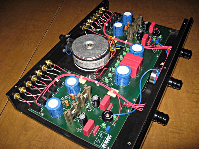

KT, you'll probably have to wait just a little bit longer for an honest answer from me. I haven't finished the B1 yet and someone commented that they had built Aunt Corey's buffered passive preamp and a B1. Between the two they preferred the B1. I haven't had the chance to compare the two but I'm getting very close.
Plus, a friend of mine was a friend of Corey's and designed the buffer and sold it commercially for a while. I've attached the image here. This unit includes a hand-built Penny & Giles pot and Audioquest solid core silver wire.
