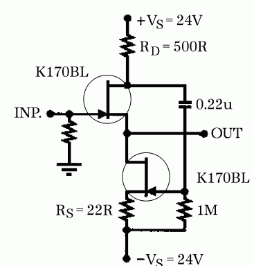

I'm not sure if this would be considered off topic. If so, please ignore my question.
I was thinking of the problem with the low psrr of the White jfet topology. It seems that the problem is that the current from the upper jfet is converted into a voltage that is referenced to the positive supply voltage. The lower jfet, which is referenced to the negative supply, is driven with this voltage. Therefore, any noise between these supplies is amplified by the circuit.
A simple solution would be if a current mirror was placed in the drain of the upper fet. The secondary side or the mirror could have a resistor to the negative supply (I am assuming symmetric supplies). This voltage would be thus referenced to the negative supply, and would therefore have far better supply rejection.
If that would work I'm not sure. In any case the circuit would be not-so-simple anymore as it would need two more transistors and some resistances. On the other hand, it could perhaps be possible to loose the capacitive coupling altogether as it might be possible to use the current to directly drive the gate of the lower jfet.
Any thoughts?
-edit: it occurred to me that my idea would introduce a phase inversion and hence positive feedback. Will have to think about it some more.

Re: Re: would this work?
You need a small load resistor (RD in attached schematic ) on upper FET's drain so that cap can take that voltage swing down to lower FET's gate in order to modulate the CCS (Aleph's CCS does the similar thing) 😉

nope ;
that cap is just for injecting noise from PS rail ;
at least seems logical to me 😉 - if ya can beat them , join them

You need a small load resistor (RD in attached schematic ) on upper FET's drain so that cap can take that voltage swing down to lower FET's gate.
nope ;

Aaahh, you want noisy CCS - to make buffer sound more "analog like" - yesss, what's music without noise, right ? 😀
Better to have clean supply. 😉

Anyway, I don't think that noise scheme will work here - it's quite different from Broskie's implementation in Aikido preamp. Furthermore, B1 doesn't need it - it has a very good intrinsic PSRR already. I know what would make you happy - nice, hot, glowing 6SN7 as WCF 😀
