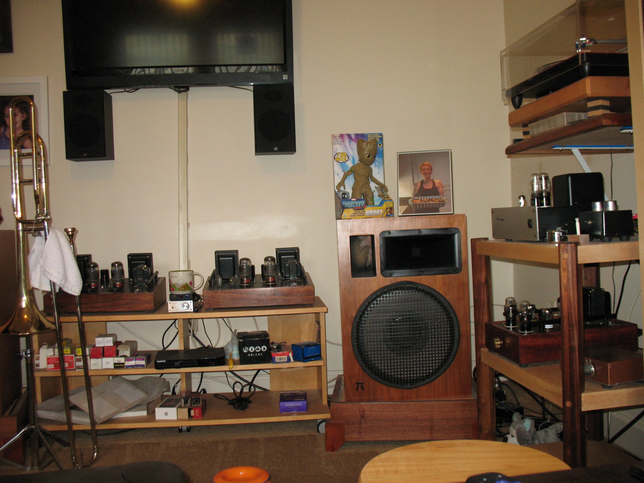

I tried the Schiit Saga+ with the single 6SN7 and was underwhelmed. I have a little box with an attenuator and switch from back in the CD intro days which sounded "pure" in the same rack with a 45 amp but in my current setup, a mismatch with 20' interconnects to KT88 monoblocks. The amps have the negative feedback from the Mullard circuit removed, so as wonderful as the 76 Linestage sounds, a passive is enticing to try.
