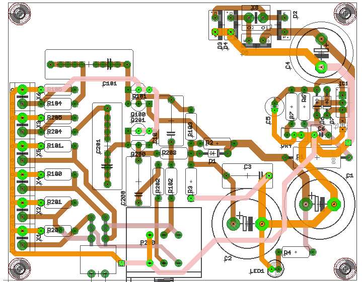

here is an ugly looking draft of B1 with LM317 supply.
what i would like understand is if it would be a good thing to connect signal ground trace only at the LM317's o/p cap (C6). The diode gnd also connects at the same place.
In the attachment all light colored traces (pink/yellow with highlighted pads) represent the gnd signal.
I want to put together an integrated amp using B1 as buffer and JLH 2003. the jlh2003 posted elsewhere, has an option of ground lift resistor.
Would B1 also need a ground lift?
regards
Prasi
any comments please?
to give more details on what I plan,
The build will have 1 big trafo and 2 CRC PSU for the JLH2003. Dual secondary 24VAC for the JLH amp. separate 18 VAC secondaries for the LM317 and buffer.
