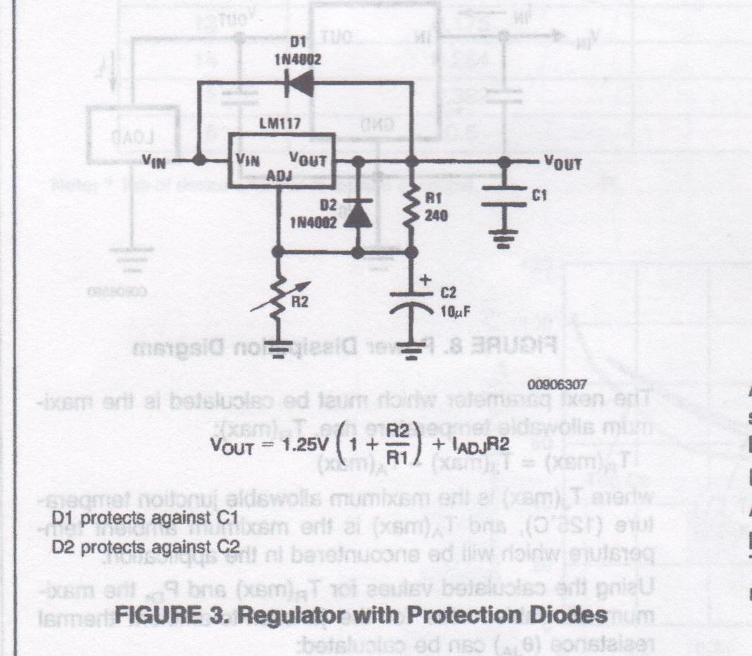

The LM317 MUST HAVE >3V across it to work.
Are you sure 1) The LM317 is OK and 2) The circuit is correct and 3) There is at least 24V at its input.
You must also have the 0.1uF at the input and 1uF at the output as close to the LM317 as practical.
With the huge C1 of the B1 you must also use the two protection diodes across the LM317, failure to use these will result in failure of the device. Failure may not occur immediately but is due to the Load (ie C1) trying to operate the LM317 in reverse.
Andrew/Andy - Yes - Approx. 24V before the rectifiers. 29-30V after. It's just a textbook implementation of the simplest LM317T circuit, with a 1000uF/50 cap after the rectifiers, and a 1000uF cap after the reg. 1uF (in National's dastasheet it says either 0.1uF film cap or 1uF tantalum) tantalum caps at the input/output right next to the 317 legs. 10uF cap across R2, which sets the output voltage to reduce ripple further, again according to the datasheet. Pin outs all correct. I HAVEN'T added the diodes but I wouldn't have thought that would hurt as most leave them out anyways, and 6L6 (posted his link a page back) used the same PSU board and setup as myself with no problems. However he may have used a different brand of LM317T (mine's ST). I think the finger of blame must point towards the 317 really - it just doesn't seem to want to perform when connected to a load, but measures the correct voltage when unloaded. I have another PSU here I can use which I'm going to setup later, but the curious side of myself would love to know what's wrong with it all the same.
http://www.diyaudio.com/forums/audio-sector/149672-universal-power-supply-pcb.html
The National Semiconductor Datasheet says you must use the diodes.
Especially as C1 is 15000uF.

Just because some builders ignore manufacturer's recommendations, is no reason for you to do so.
Noted Andrew - it was advice I actually read on here aeons back, but it obviously has resulted in a damaged LM317T. Lesson learned.

Had another go with the PSU yesterday. Removed the 'old' LM317T and replaced it with a new one (I'd ordered a pair via Ebay). Had the same problem again - measured fine unloaded. But loaded the voltage just dropped to virtually nothing. This was with the protection diodes in place too.
Order some from a different seller. Still 'ST' brand. Arrived this morning - looked a little different from the first two. Different font used on the case, and (what looks like) ST etched into the body over the ST print. This one worked first time - spot on 22v. No sagging under load.
I can only assume the first two I got were either fakes, or I was unlucky enough to have gotten a couple from a bad batch. I'm assuming it's the former.
B1 is up and running and sounding fantastic - thanks for everyone's help, plus Mr Pass of course for designing such a great buffer. Lots of happy hours listening ahead I think 🙂
