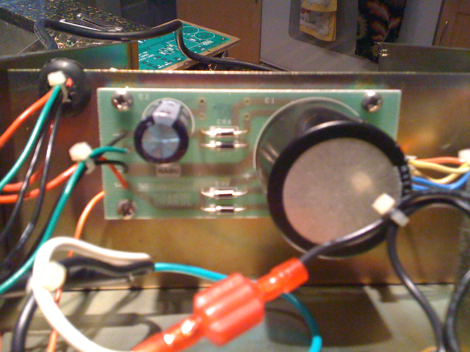

Hello...
I have ordered the B1 boards from Mr. Pass and I also have ordered the surplus chassis listed in post #2056 (thanks Lee35210)... it comes with a transformer which outputs two voltages +5v and +18v.
The site info for the chassis states "Filter capacitors are 22,000mF at 16 volts and 470mF at 50 volts. The end result is a linear DC +5 volts @ 1.0 amps and +18 volts @ 1.0 amps supply" The transformer output goes to what look like 2 transistors that are heatsinked on the back.
First question: Does "linear" mean regulated... is that what the transistors do?
Second question: Can the outputs of both be combined to total 23 volts?
I know I can run it at the minimum of 18 but I would like to try both voltages if it is possible to combine them.
Last question: If I use this PS do I need filtering caps as Mr. Pass has suggested when using an SMPS?
Eddie
I have the chassis in hand and I have checked the voltages of both of the output devices 17.8v / 4.8v. The numbers on the 18 volt device say 342 SFC with 2818RC below the 342 number. I haven't been able to find anything on that device. The 5 volt device says L7805SCT. I found that at Digi-key and it says it's output is 5 volts... http://www.datasheetcatalog.org/datasheet/stmicroelectronics/2143.pdf
The power supply has 2 caps and what look like 4 diodes.
The chassis is very nice and will make a great place for my B1.
Can or should I use this PS???
Thanks in advance for any help!
eddie
I pulled all the power supply past the transformer and used a 18v regulator board from Welborne. Be careful about which leads you use if doing similiar. I ended up using the leads that went to the +5v circuit. The +18 v leads were too high for the filter caps (35v) on the board. The orange wire needs to be insulated and tucked aside with the other unused secondaries. Also added IEC connector/line filter and line fuse holder on back panel.
Combine the voltages?
So, can I combine the voltages from both outputs to give me ~23 volts? Do I need any other caps with this arrangement?
eddie
Sounds like you got yourself a regulated 18V supply. Why not use it?
Magura 🙂
eddie
So you didn't use the output from the board in the chassis... but you did use the transformer. What was the reason you didn't use PS as it was?
eddie
eddie
It's sounds best at 18V, why do you want 23?
Exactly my thought.
Magura 🙂
I din't use original PS board because was concerned about 30yr old caps,etc plus better parts on Reg board did use
