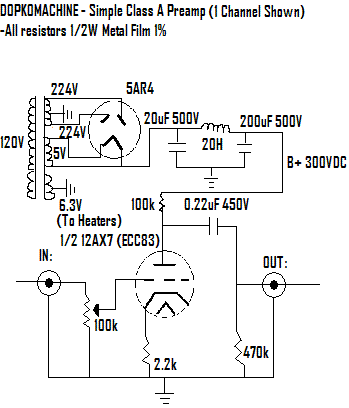

If you want to build your own, this can be done with a single 12ax7 for both channels. The only problem is with this schematic, the output impedance will be very high... i recommend building a SRPP using 1 12ax7 per channel to be able to drive any solid state power amplifier. But here is the schematic that I came up with back in the day.. its very simplistic and will yield very good results considering the low cost of the parts and for it being so simple 🙂
It is an error using the same tube for SRPP-better using one half for the low side and one half of other tube for the upper,and also having two secondary windings of the transformer for the two heaters is quite mandatory!i recommend building a SRPP using 1 12ax7 per channel to be able to drive any solid state power amplifier
what is the output impedance using that tube with that output filter?
and I'm not a moderator here, but is this really the best place to post about a tube circuit?
