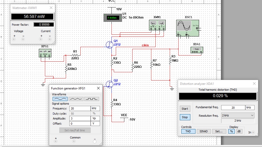

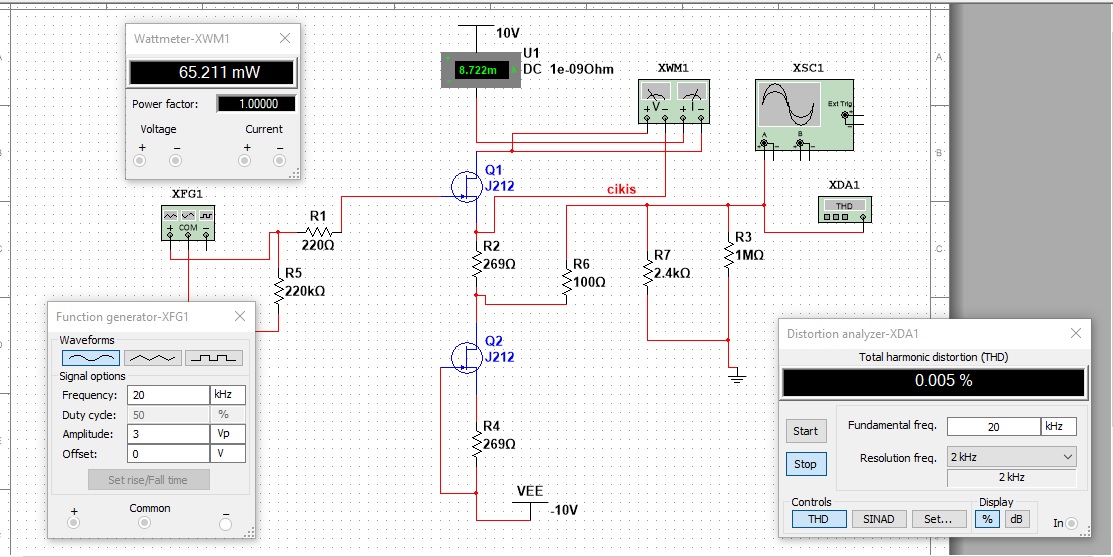

I have made another simulations and it gives lowest distortion at 2k4 load.Less than 10k load.Is multisim accurate?
And at 3v 1MHz 2k4 load THD 0,01 !

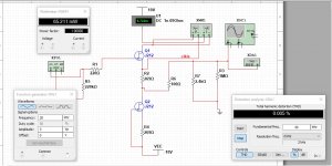

Hi Zenmod!
Because of my Papa is also smarter than their Nelson i could decrease R2 and R4 to 269R and make R6 100 ohms 😀 (R out is 1K at original B1 design as you know)
Yes 2sk170bl may be better (i am regretful that i sold hundreds of 2sk170 and no stock left.I have some hundreds of 2sj74 though,i am keeping them ) but difference seems not too much (at least on simulation) and this is mostly 2. harmonic.If there is no difference on blind test i can live with it.
Maybe you can send me some hundred of 2sk170bls( i heard you have ten thousands of them) as free gift 😀
