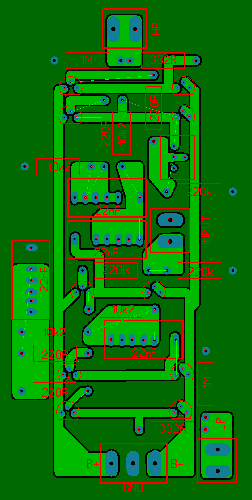

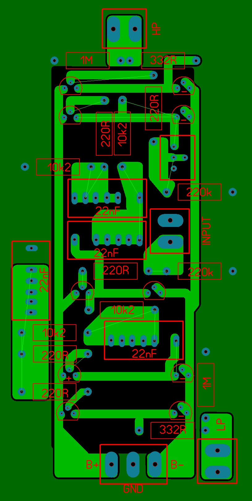

PCB a few options
Guys what do you think?
The only difference between these two is the obvious absence of filled plane in the center. Ground on both encircles the board. In the one that is filled in the center - the fill is not connected to ground.
So let me know what you think about the layout. The board is right now 58mmX115mm.
Uriah

Just another Moderator
Joined 2003
Hi Jaques, I note that Rod Elliot included an inverting buffer in his 12db/octave crossover for the LP section (which seems a bit odd as I would have thought the tweeter would be the one you invert). Anyway I guess the question is, what were you planning on doing with respect to the 180 degree phase shift of low compared to high? reverse the polarity on the speakers for one (as would be done in a passive crossover)?
Tony.
Maybe Rod thought it better to include additional amplifier stages in the LF path due to the added distortion being less audible here?
Anyway, be that as it may, when making this dedicated filter one could as well reverse polarity at one driver.
But, why not opt for a LR4 filter? Have a look at Linkwitz' pages. And as he states, if you do not do correct for other things when running active, it is really no use. Well, have a look at the man's page!
All the best!
RK
Tony.
My plan is to reverse the leads to one of the drivers. I don't see an advantage to doing anything more elaborate than that. For the proper operation of the crossover it is necessary to reverse the polarity of one of the outputs -- it doesn't matter which one.
