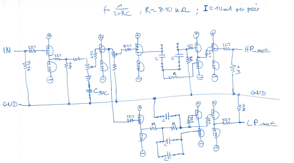

Here's something I sketched up during lunch break. Buffered passive BSC in front of 2nd order (12dB/octave) HP/LP and relative level control for HP.
Should be managable to fit this on half a eurocard. Unfortunately I'm not familiar with pcb design software. What are you guys using?
I'm not sure if a pcb version can be reasonably kept fairly absent of direct use of Salas DCB1 buffer. What's the verdict?

Thanks Dave,
For previous suggested incarnations we have Nelsons permission to move forward.
If we want to use Salas design within the card itself, we have to discuss with Salas his IP on the matter, and compensate him for using it preferably. Using a DCB1 as a power source and output buffer would seem to simplify things. Those boards are readily available with his blessing and support. I am not sure in this design how close or what it barrows from his design.

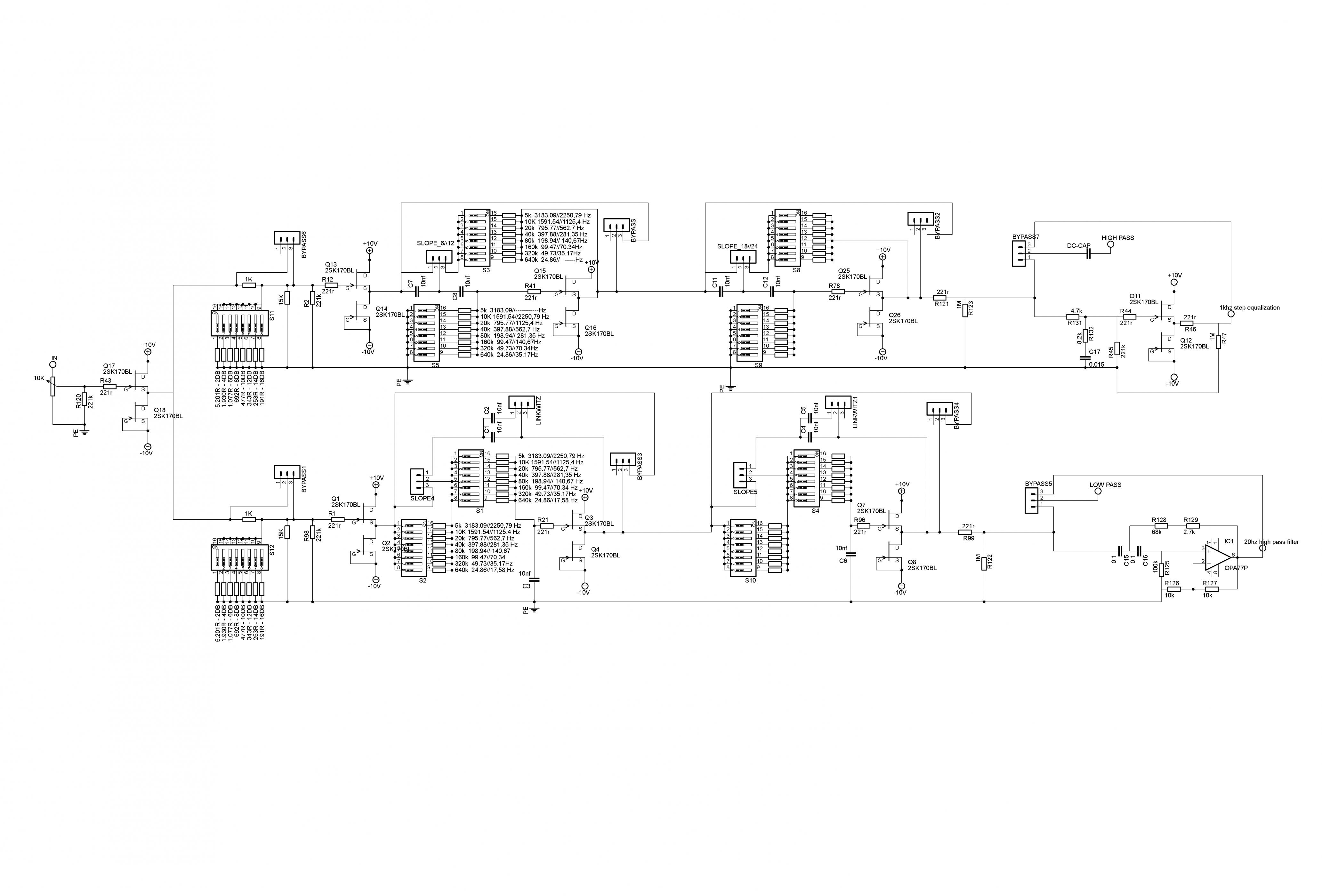

A big !thank you! goes out to the Master Nelson Pass...
We can add a third way, plus Notch filter, plus Delay correction... with some help with opamps or a discrete opamp...
Small changes, for discussion .... from post 395 : http://www.diyaudio.com/forums/pass-labs/156094-b1-active-crossover-40.html#post4272065
Need some help to offer choices of shelving equalization curve, for now only 1khz.
