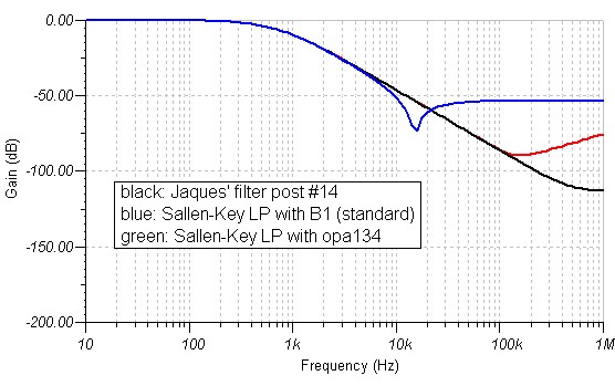

sorry, my question might be stupid: I understand the reason for the insertion of a buffer in the feedback loop to lower the high-frequency level for the LP section. But I am not shure why you did not choose the more easy way, a passive LP filter at the output of the LP section. If I do some simulations, those filter slopes look even better, the phase of the signals is better and for the 4th order circuit you get rif of two buffers.

To Jacques: modelling my filter response through Analog Wizard™ Filter: Home (using model opamps) I do not have the rise in LF after the filter point. Do you expect that this rise will be present also in my future third order filter?

I am not Jaques and I don't know the simulations you mentioned. But if you simulate the Sallen-Key filter with OPs, you will get the same effect but the level will be much lower because of the lower output resistance of the OP.
The reason for the effect is the feedback cap which "bypasses" the buffer and builts a voltage divider with the output resistance of the buffer. This is an effect of the topology itself and you will get it with a Sallen-Key of third order too.
