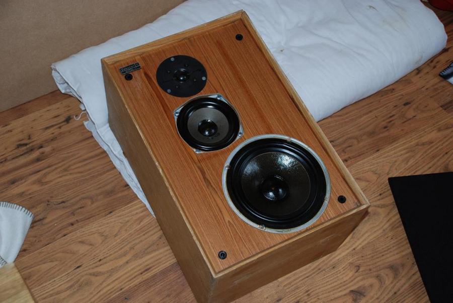

I do have an interest in that speaker. I bought a pair for my nephew for his wedding present.
They were highly rated at the time. Looking back on it, they were a very harsh sound. I think the Kevlar bass was the problem. He has moved on to a lovely old pair of 3 way vintage Celestion Ditton 22:
