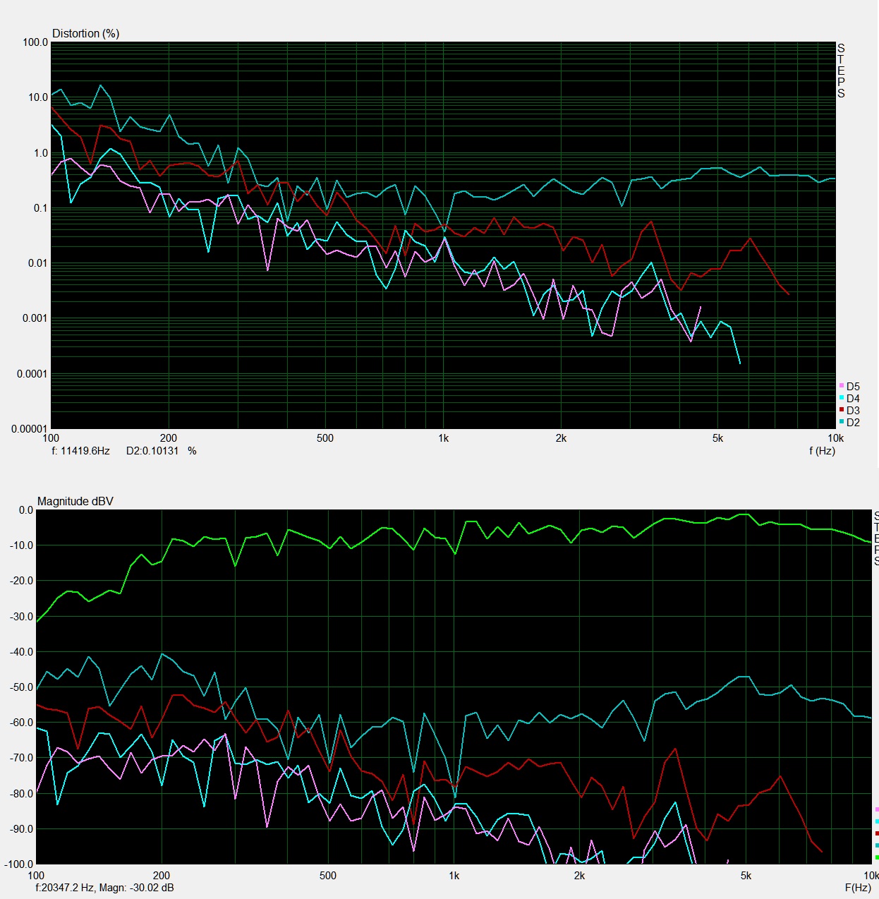

The other main issue is the cone break up.
FST in red.
The cone itself behaves fairly well, but does exhibit a strong-ish resonance at around 3.3khz.
As you can see this causes a large bump of greater then 10dB in the 3rd 4th and 5th harmonics. Luckily this doesn't cause issues further down the response like it can do with metal cones, so providing you crossover early enough you can avoid it. Also you can see that the cone is going through a region of controlled breakup beyond around 5khz. The hump at around 1.5khz is diffraction related.
Now B&Ws implementation has all of those issues presented to the listener and you can see this in stereophiles measurement of the 800D2.
This will no doubt provide you with a certain presentation and could perhaps explain some of the deficiencies or issues you've heard when listening to B&Ws loudspeakers. Of course you may have listened to it implemented in systems not produced by B&W.
This isn't to knock B&W, they've designed a fantastic driver and one that does, on the whole, allow them to crossover how they want (high) without causing too many issues, but it is still a game of compromises.

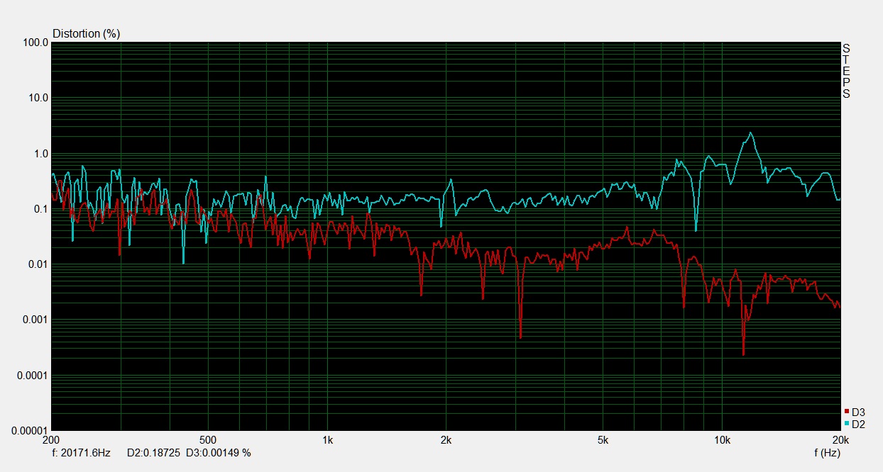

The wave-guide allows the FST to be used up until around 2.5khz without off axis issues and keeps the distortion hump at 3.3khz out of the picture too. With a standard 1" dome you'd be looking at an xover point of around 2khz or lower I reckon.
Here's the distortion profile for the FST + scan/wave-guide, 2nd order @ 2.5khz at what I would consider a loud listening level.

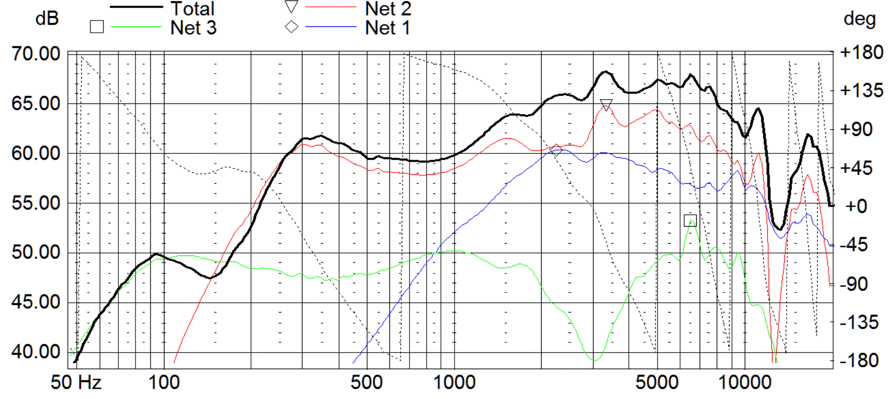

I am not sure (do not have sufficient data), but the difference seen between the on axis listening window and the sound power curve of the FST midrange unit, seems already fully developed until about 2Khz.
Maybe beaming of that midrange unit does not get much worse in the octave from 2-4Khz, due to "shrinking" of the effectively radiating surface area of the cone, if it works virtually like claimed in that particular range ...
Neglecting those resonance issues around 3Khz and the question of smoothing those for now ...
When crossing to a 1" tweeter we can choose now, where to place the blooming of in the dispersion pattern of the box:
- around 2 Khz ?
- above 3 Khz ?
Using most conventional midrangers or woofers i would opt for a lower crossover frequency, to keep discontinuity in dispersion pattern and sound power as small as possible. But now assuming this midrange unit being "a bit different":
Both options will give a different "sounding" and due to absorption in most rooms rising with frequency, maybe the higher crossover frequency is not that unattractive: Sounding less "offensive" above the presence range and give some "detailed", "silky" and also "wide" notion. I mean, we want to sell it, so it has to sound "good", doesn't it ?
Instead of asking whether crossing around 2Khz or e.g. around 3,5Khz one could ask, why not a waveguide is used for the tweeter, to smooth out the discontinuity in the dispersion pattern, that would also occur - possibly in a more moderate form - when crossing that configuraton at 2Khz.
But that does not seem to conform with the "tweeter on top" / "diffraction free" tweeter mounting (and also design and marketing) concept.
At least one could ask the question, why the speaker is not tuned to be virtually flat on axis in the 1Khz ... 6Khz region, and why the on axis response resembles in a way the sound power curve, thereby even worsening the effect.
