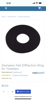

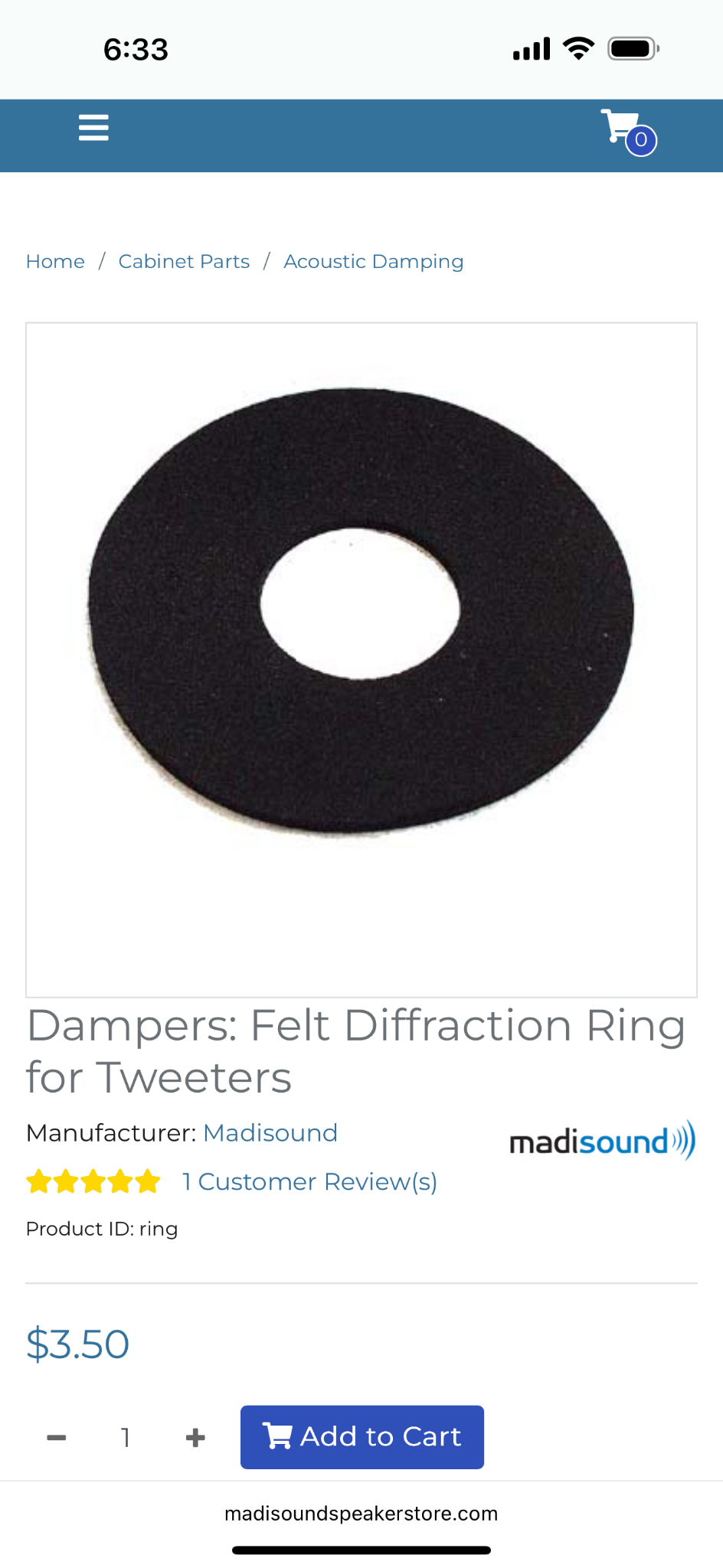

So I had a similar issue with a tweeter years ago. The fix was a tweeter felt ring from Madisound. Or go to a hobby store and cut one out your self. It should have self adhesive on the back. Here’s a picture. It’s a cheap and simple solution. Also a lot of these manufacturers use clad aluminum wire. I found it in my linn speakers of all companys. 😱😞. In their book shelf speakers. I hope this helps? JeffI have some B&W DM 602 S1 speakers. They're about 28 years old. I like their performance, but I've always found them to have a high-frequency range that gets fatiguing during extended listening. I tried the crossover modifications suggested here on diyAudio, but quickly went back because I noticed the original crossover is better. I've now seen a pair of DM 602 S3 tweeters for sale. They can be improved over the original DM602 S1. The other thing is that the ferrofluid is probably old by now. The question is: will replacing the tweeter with the S3 tweeter change the sound for better or worse? Regards.

BTW, I've tried felt rings and capacitor replacements. They are good when you have an itch to scratch. For twetters that have small, ragged peak and dips. If the OP's speakers measure as in the S&V review though he'll need to tame that 9kHz peak first. Then a cap swap may be the icing on the cake.
