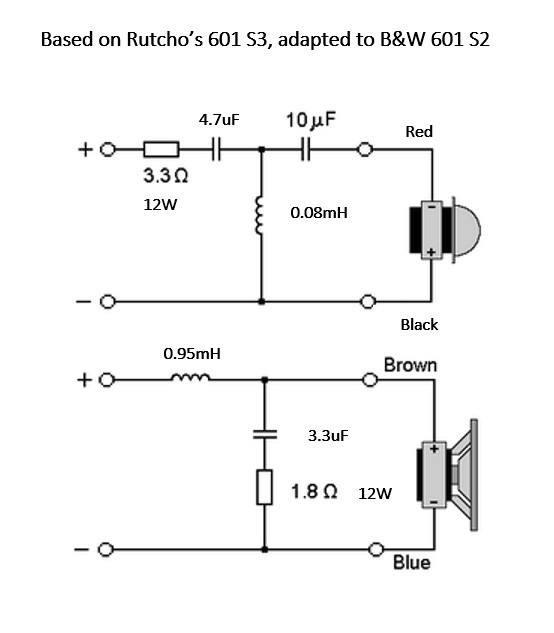

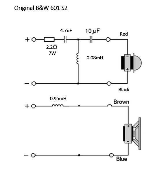

Hi Alpuy, here's my current crossover for my DM 601 S2
Rutcho's upgrade had a 3.3uF cap on the High Pass, and 4.7uF on the Low Pass. I had that configuration for 6 months, enjoyed it, but mids were still muddy. So I reverted to a 4.7uF on the High Pass and 3.3uF on the Low Pass (just swap the caps if you followed Rutcho's design). This change means that the intersecting frequencies for both speakers now overlaps more, lifting up the mids. I also figured if B&W originally used 4.7uF on the HP, there was a good reason for doing so.
A good improvement on Rutcho's design for 601 S2.

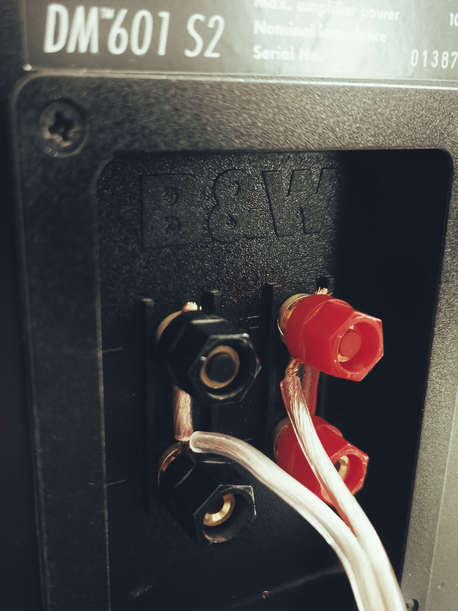

Also, a minor but surprising improvement with the upgraded crossover is to connect the + cable to the + terminal of the tweeter, the - cable up the - terminal of the bass speaker, and replace the flat links with cable. See photo.
Note that this config was not enjoyable when I tried it prior to the crossover upgrade - the tweeters were just too piercing with the cables connected this way.
cawauk
2021-07-08 11:50 am
How is this different to the flat links?
Cable vs. flat link? Probably not much, something I read a while ago, about the materials used for this range of speakers not being the best, and that swapping the links out with good quality cable was a better option. Never did an A/B test. The flat links however once removed did seem pretty cheap. Gold coated steel or aluminium or something like that, very lightweight too.
As for + into tweeter and - into mid range, I read it online, something about impedance, path to least resistance, and that it was better to feed high frequencies first. Honestly I didn't think it would make a difference until I tried it, and it did give these B&W tweeters more power. However prior to Rutcho's upgraded crossover, more power to the tweeters wasn't bearable.

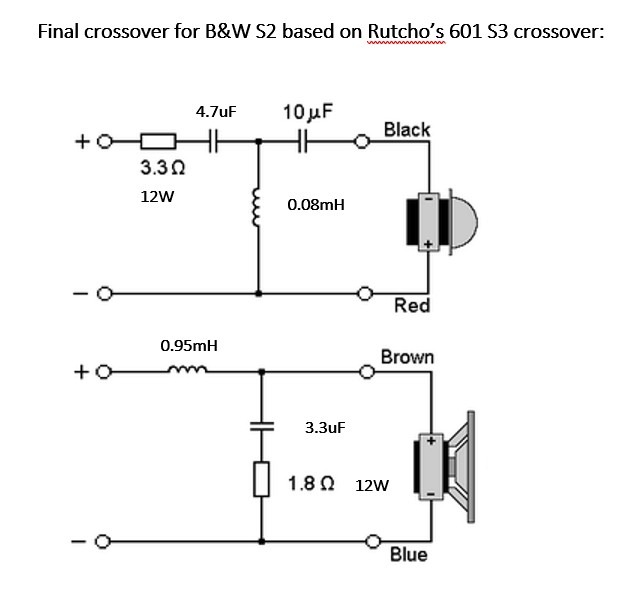

After several experiments this weekend followed by listening tests (swapping around capacitors, adding expensive bypass capacitors, and reversing tweeter polarity) I've come to the following conclusion for the DM601s2:
  • my 4.7uF <> 3.3uF reversal vs. Rutcho's mods is indeed better for the S2s
  • reversing tweeter polarity as per Rutcho's mods is indeed better (for some reason I didn't like it originally when I had the 3.3uF capacitor on the high pass, but now that I have reversed it, and with the 4.7uF on the high pass, it has definitely cleaned up the upper mids/lower highs, plus there is no longer a small dip around the 4-5kHz mark)
  • the 3.3Ω resistor could be swapped out for a 3.5Ω or 3.9Ω to bring down the highs ever so slightly and give these wonderful speakers a slightly warmer tone.
  • bypassing with Miflex 0.022uF paper oil caps just doesn't work (not to my taste), even after 3 days of burn in. With the caps, everything sounds spacial, yes you get increased clarity of highs but they are projected out in front of voices losing a tight silky cohesion to music, with increased lightness and mild echo to singers' voices. Plus, this lightness does not exist on my B&W P7s and Sony WF-1000x3 headphones, so bypassing I think creates a reverb in the highs which I just don't like, especially with the DM601S2's metal dome tweeters. It doesn't work to my taste, especially not with warm live jazz music.

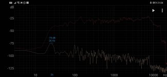

Final recommended diagram attached and a (unscientific) frequency response measured with my phone 50cm from the speaker.

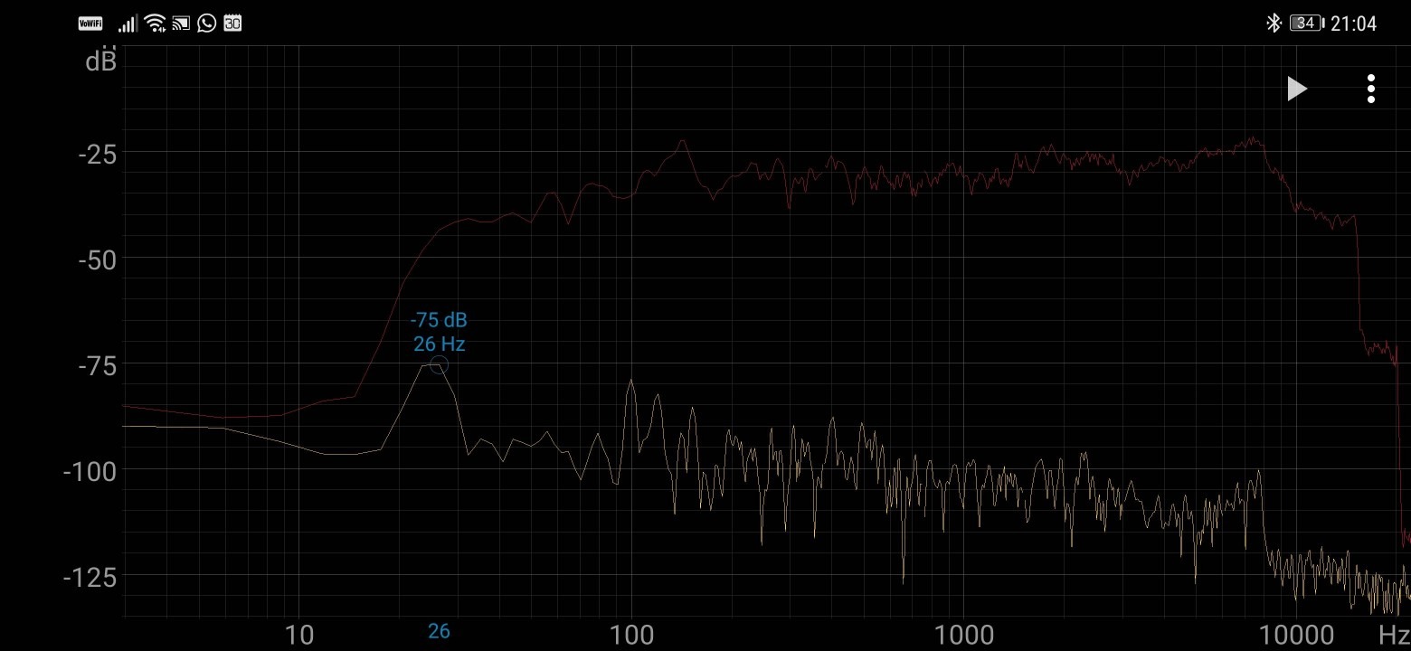

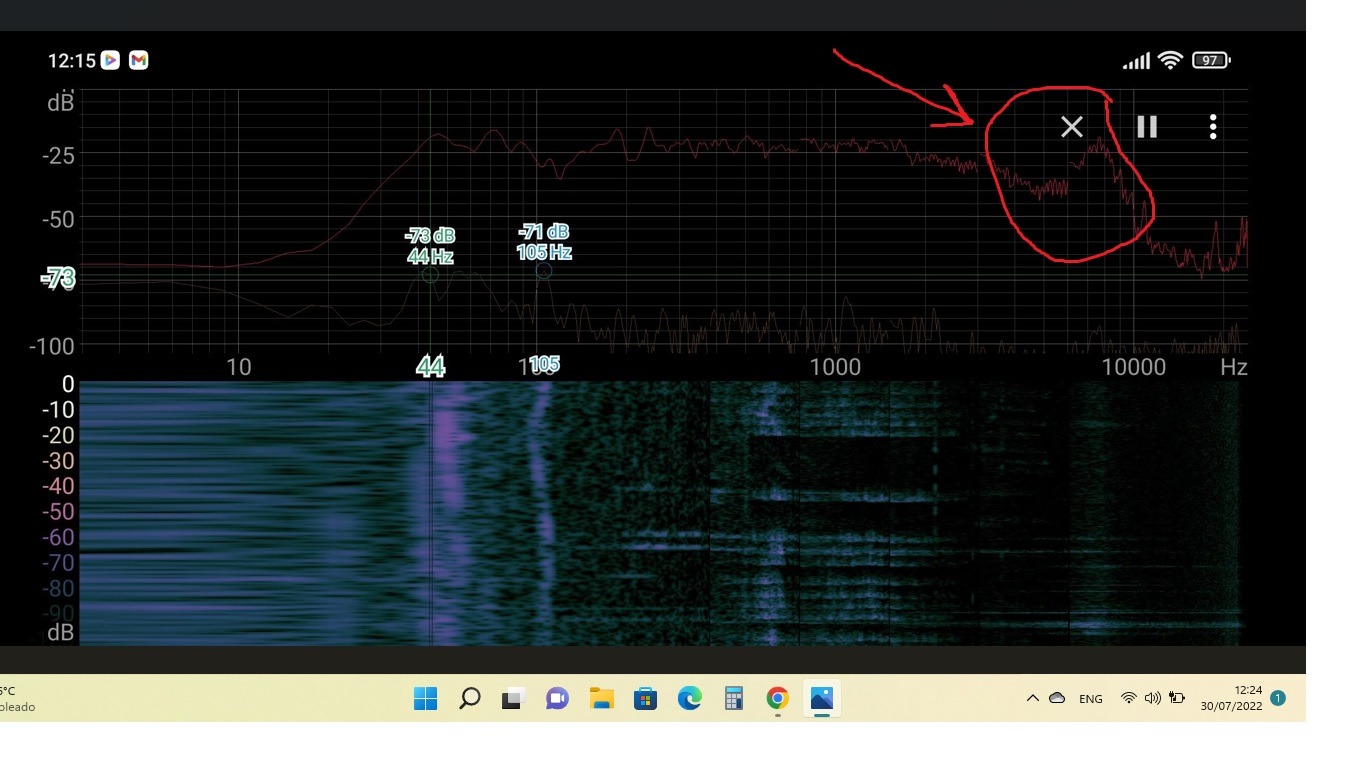

Cawauk, could you tell me how you have achieved that frequency response graph with the telephone?
Pink noise in the amp? What APP?
I use "spectroid" app and play a frequency sweep from YouTube. Now obviously this is hardly scientific, as:
a) the frequency sweep recording quality is unknown
b) I have no idea how accurate the microphone on my phone is (note the HF drop, this happens across all amplifier/speaker tests so likely due to phone mic limitations)
c) I live on the last floor with sloping roof and a huge kitchen counter separating living room from kitchen, resulting in numerous room modes (especially around lower frequencies which can easily be heard moving around)
d) my measurements were made with speakers in their listening positions, i.e. less than 1m from the wall.

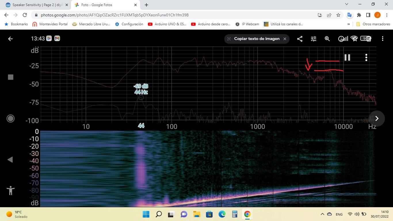

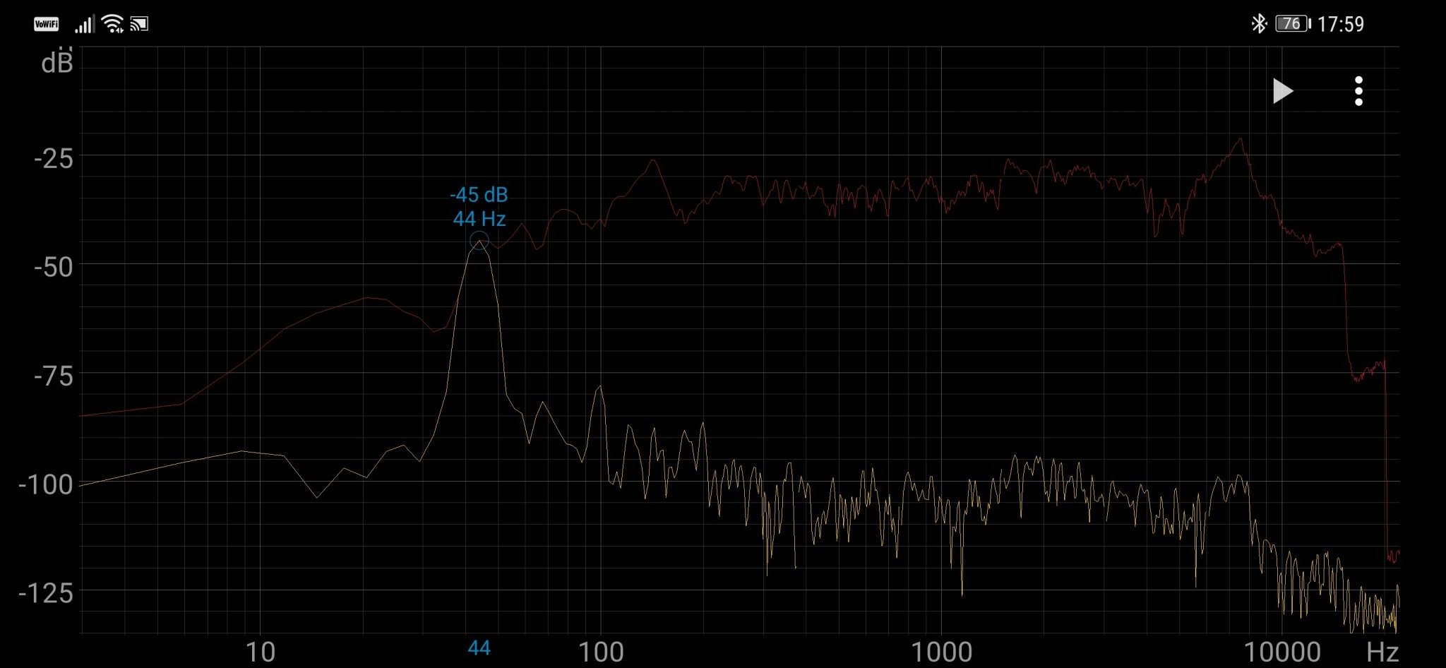

However, this approach is helpful for before and after comparisons using different crossover configurations. For example, I've attached the sweep result prior to reversing my tweeter connections - you can clearly see the 4kHz to 5kHz dip.
