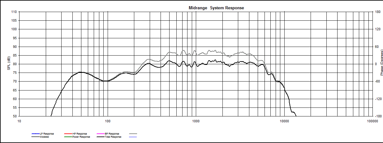

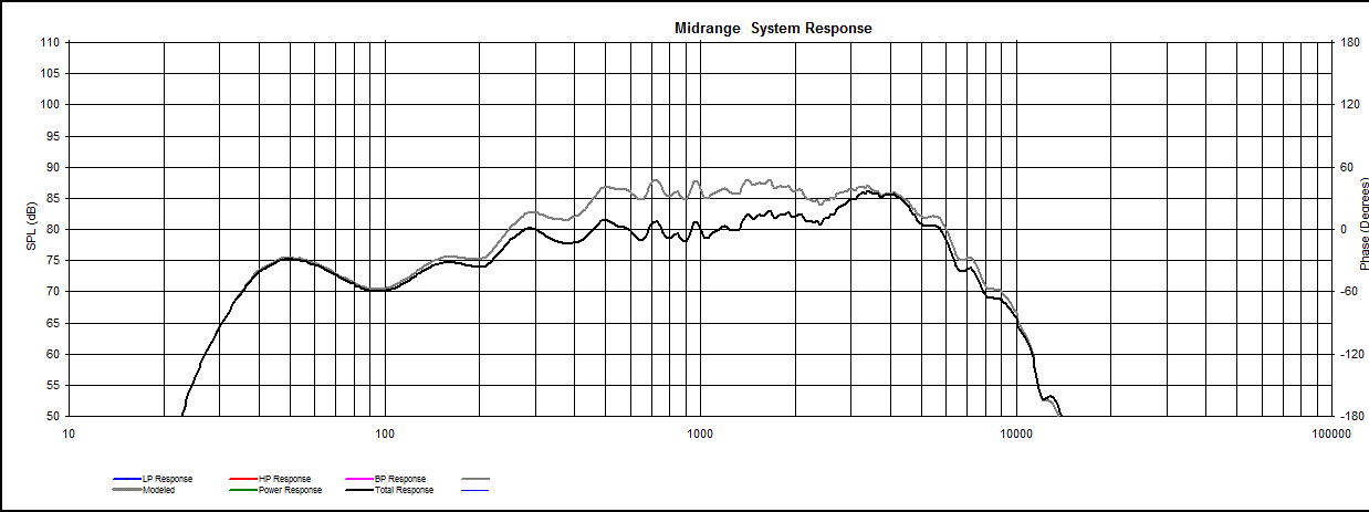

This simulation shows the difference between attenuating a midrange unit with a resistor of 9 ohms before and after XO filter. As it appears, the manufacturer obviously wanted to keep the spl around mid/hf XO point(5 kHz)remain intact more or less, while reducing midrange level from one extreme to another. Seas 5" unit filtered as in service manual.

Hi Lozjek, thanks for your reply. It appears from your Graphs that the first option gives a smoother response without the rising response towards the MF/HF crossover point. I was considering moving the attenuation before the network, what do you think?

Hi again. Went with the attenuation before network, which provided the best integration with the other drive units.
