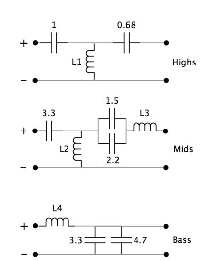

So I disconnected the smallest tweeter, the top one that has sort of a transparent plastic finish.
When I play them without that tweeter, the fizzy distorted sound is gone.
So clearly that is at fault for the trashy sound.
However, the remaining sound is a bit "hollow" and not very crisp.
Is this just normal, could the crossover capacitors be shot, or are the woofer and mid range gone stale or what could this be?
I was really hoping to make good use of these speakers, so any help is appreciated 🙂

What I would do is use a good multimeter on the crossover and measure some capacitor values, but I am guessing those capacitors are OK. Look for dry joints. Put a 1.5V battery over the tweeters to see if they make a satisfying crackle.
You'd have to unsolder the first capacitor in the supertweeter crossover to test them running on just bass and tweeter properly. They actually would probably work ok just on the Celestion HF1300 tweeters if you took out the last coil on the tweeter section, which probably just rolls them off so the supertweeter can take over.

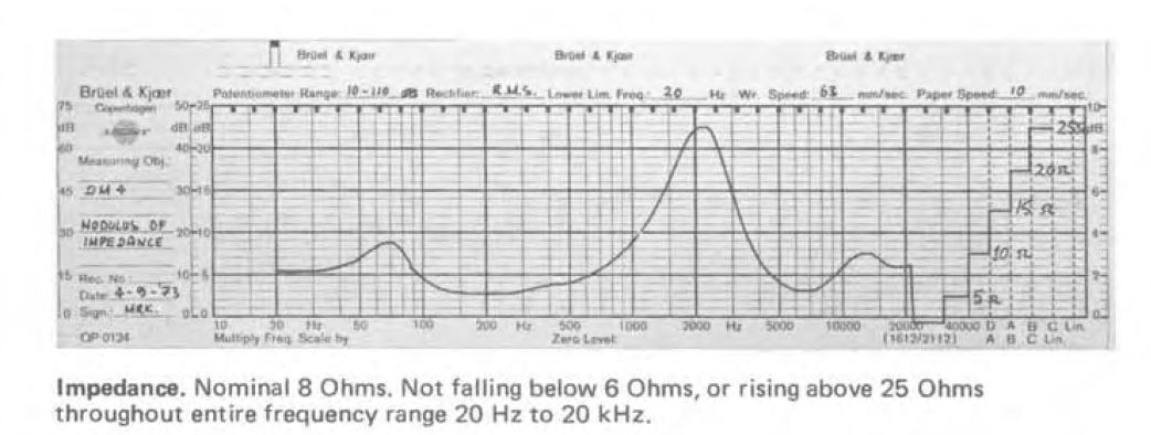

I read on Troelsgravesen.dk his review of the Spendor BC1, which uses the same woofer/mid/tweeter setup, and he rated it at 84db/1W/1M, and ohms ranging from 10-16 range.
Could it be that at 84db sensitivity, these things are just too heavy to power for my single ended KT88 amps? They are about 8-10 watts or so.

It couldn't be anything resonating through the crossover, but originating from the woofer or something else, or something in the crossover is bad?
Eivind, the DM4's have a very awkward impedance for a valve amp, so yes, use a transistor one for testing!
I've already suggested you disconnect the supertweeters for testing. That means unsoldering the first capacitor in the supertweeter. Also short out the L3 coil on the tweeter. The HF1300 really should sound quite OK on its own. There's actually little call for a supertweeter with it.
