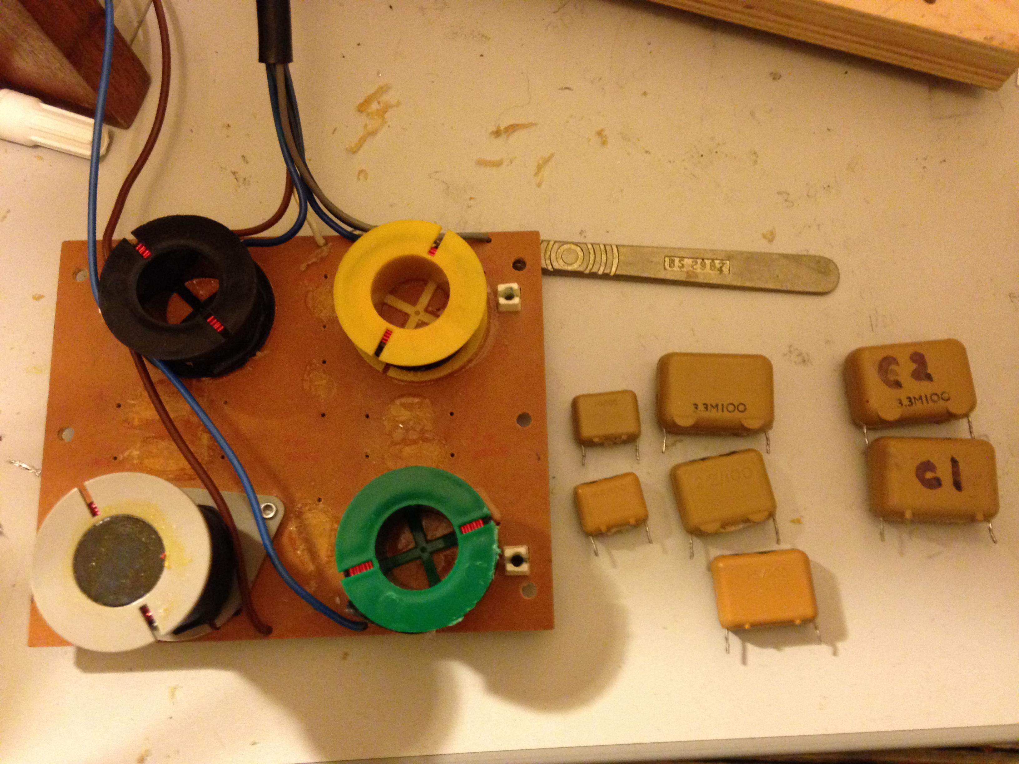

All caps finally extricated from xover board without any serious damage to pcb, tracks or caps, real pain to get off as were glued to pcb & to each other when in pairs, as well as having leads bent over on solder side.
Capacitance values:
High filter:
C6: specified 0.68uF, measured 0.675uF
C7:specified 1.0uF, measured 0.962uF
Mid Filter:
C4: specified 2.2uF, measured 2.37uF
C5: specified 1.5uF, measured 1.45uF
Low Filter:
C1: specified 4.7uF, measured 5.32uF
C2: specified 3.3uF, measured 3.63uF
Capacitors were all marked xuF/100 on one side & ITT GB PMT/2R on reverse, which from web search eg

They all look to be within 10% except C1 which was 13%.
How does that sound, I dont have ready access to pspice or other simulation software.

Capacitors look OK, unlikely to be problem with coil.

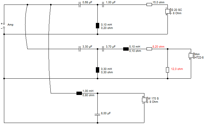

I really don't think the crossover is the problem. It's the HF1300 which isn't loud enough. It actually does most of the work above 3kHz!

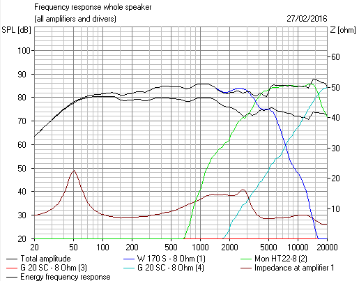

I did think a Monacor HT22-8 was a good substitute after some modelling. This is a £6 cone tweeter much like the HF 1300 in response, if not dispersion. Available at Blue Aran.
I modelled it very roughly tonight. It's gonna look a bit like this. BTW, I found a 0.1mH on the Coles 4001G tweeter was better, but not a biggie. Bottom line, is you attenuate the Monacor and keep it round 16 ohms load. It's a 92mm tweeter with a near 63mm cutout plus leads. Big spade connectors. Resistors should be less than £1 a pop for 10W wirewound aka ceramics. Doubtless some fiddling for level required.
I don't think there is a strong case for changing the Coles 4001G supertweeter or 0.2mH coil, but the diagram shows how you would do it for an 88dB 8 ohm substitute.
My intuitive methods frequently have other people here throwing there hands up in horror, but TBH, I've never had a disatisfied customer. 😀

Surprisingly, and I just can't explain it beyond noticing it works with the 3.3uF to produce a 8kHz resonant peak, removing 0.1mH L3 actually reduces the top end output of the HF 1300. So not recommended.
I'm just using the soft-dome Visaton G20SC as a modelling guide, since tweeters are tweeters IMO. I just like to get a feel for how the circuit works. But actually, metal domes like the SEAS 19TAF/G are better on detail IMO.
But keep the mylar Coles 4001G supertweeter as it is, I reckon. Nothing wrong with it.
Glad you're willing to have a bash with the Monacor HT22-8. It works well enough on 2.5kHz crossover. I like it a lot. Metal dustcap, you see.
Personally I might also shunt a, say, 33R 3W across the Coles for a better supersonic impedance, which is something I can hear, making the amp more stable and making for a cleaner sound.

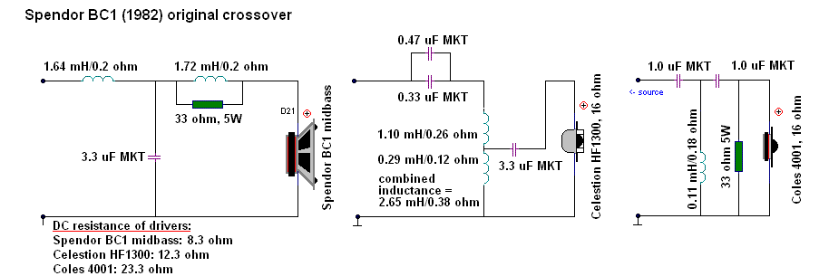

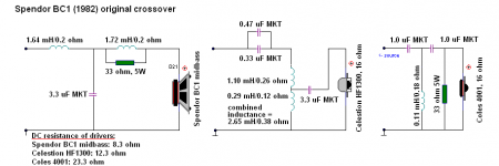

Ive noticed a discrepancy on the B&W circuit diagram and the circuit & photo of back of xover pcb from earlier post from Malefoda, the 2 capacitors 1u & 0.68u in the hi pass filter are reversed. System7Steve could you model the 2 filters to see if there is any significant difference to the hi freq response, if Malefoda's is better I will change round the caps. BTW what modelling sw do you use, any recommendations?
Traditionally, the 0.68uF comes first, before the coil. The bigger 1uF one is after the coil. Simple as that.
I was scratching my head why the HF1300 is negative polarity. That is not what you usually get with 6" bass and tweeter. By my reckoning it works better positive polarity. The Coles stays negative polarity.
