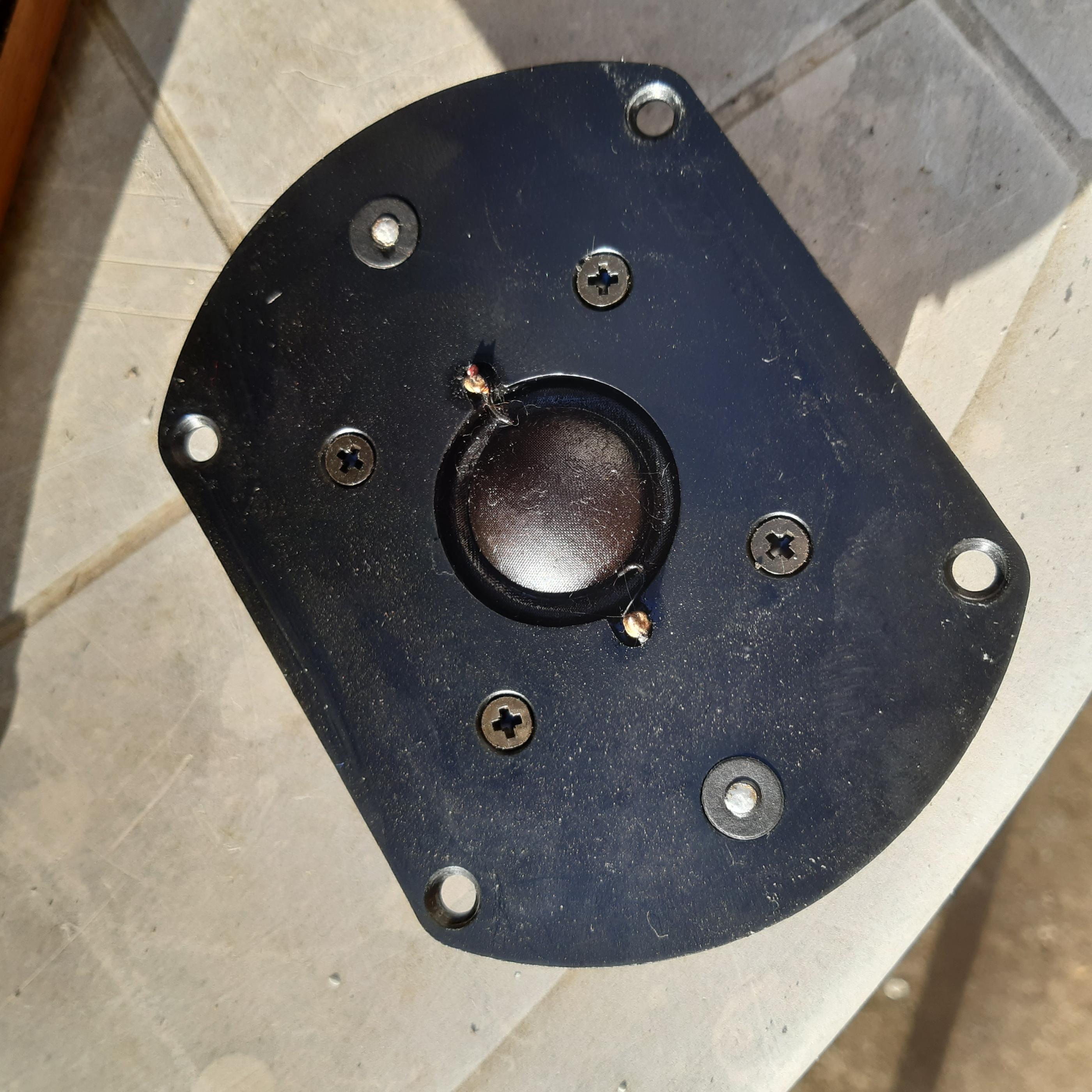

Found that B&W DM14 on the side of the road. This sealed 2.5 ways made from chipboard two 18 cm polypro like cone and a 2.5 cm tweeter sounds a little boxy but I find the high mid and treble to be very nice. Quite heavy box assembled September 1980.
Shouted some pics of the drivers and the internal for Diyaudio archives:

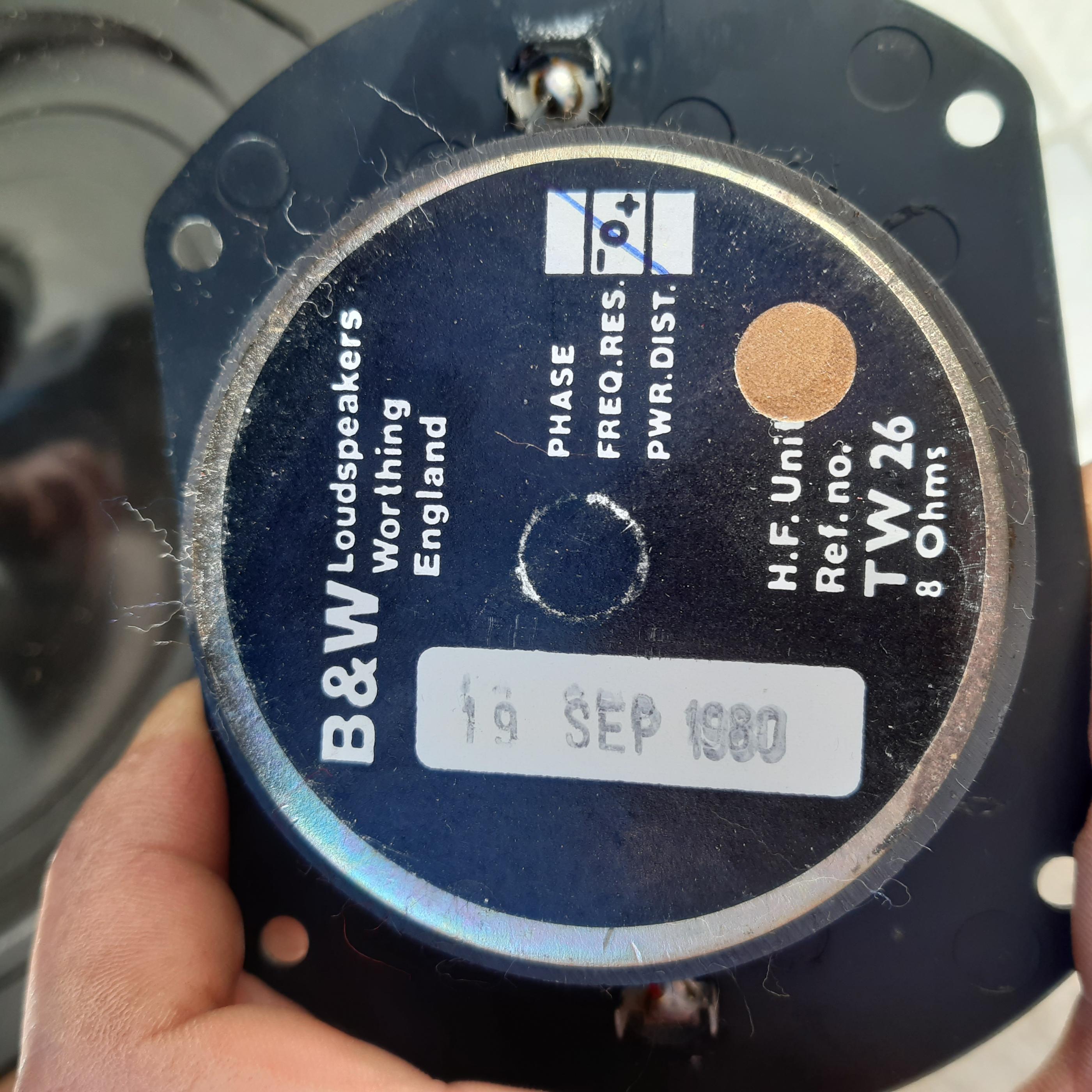

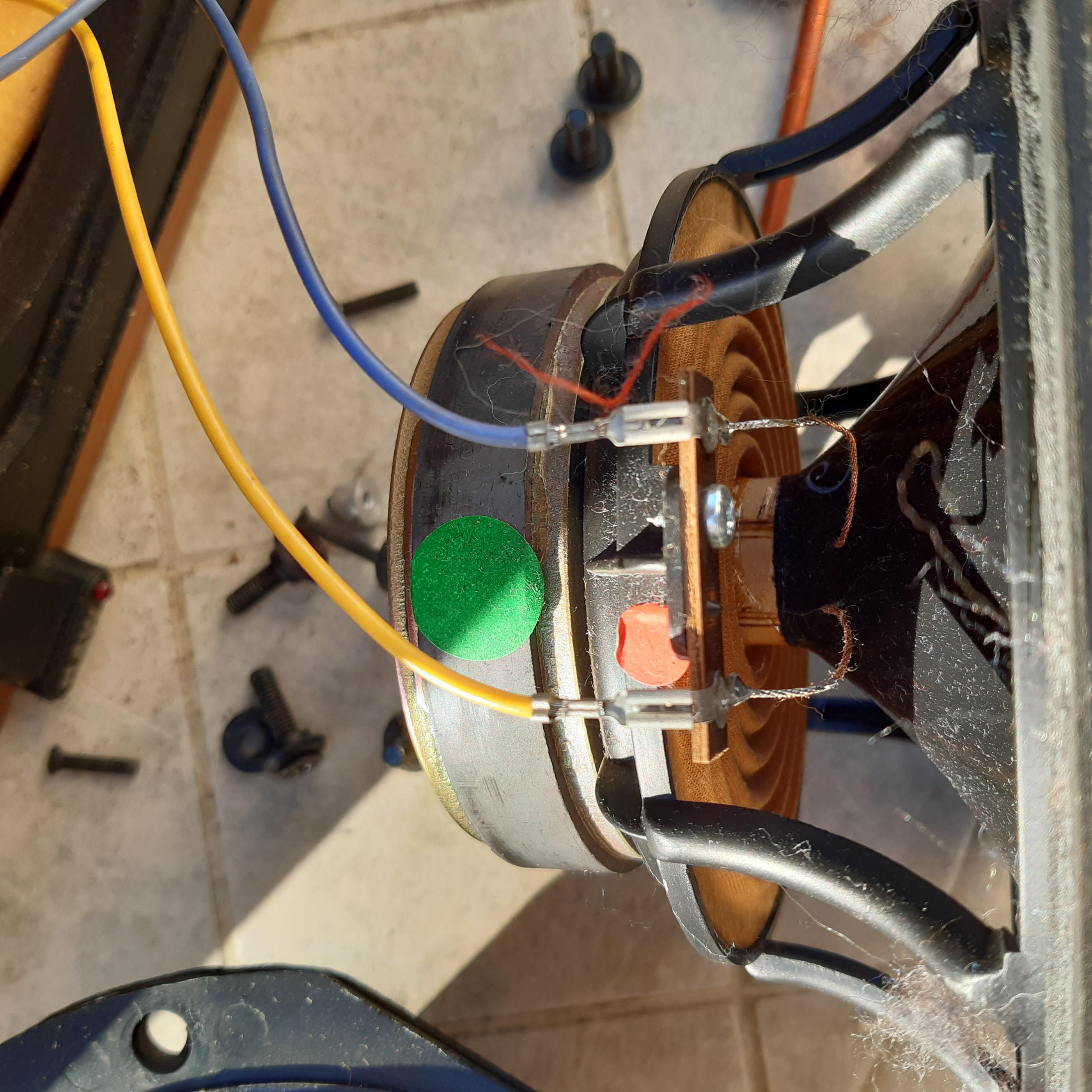

1" (2.5cm) tweeter : TW26, 8 ohms soft dome, seems hand coated and is a little bright for a fabric dome. The dome is very soft at finger push but recover its shape back.

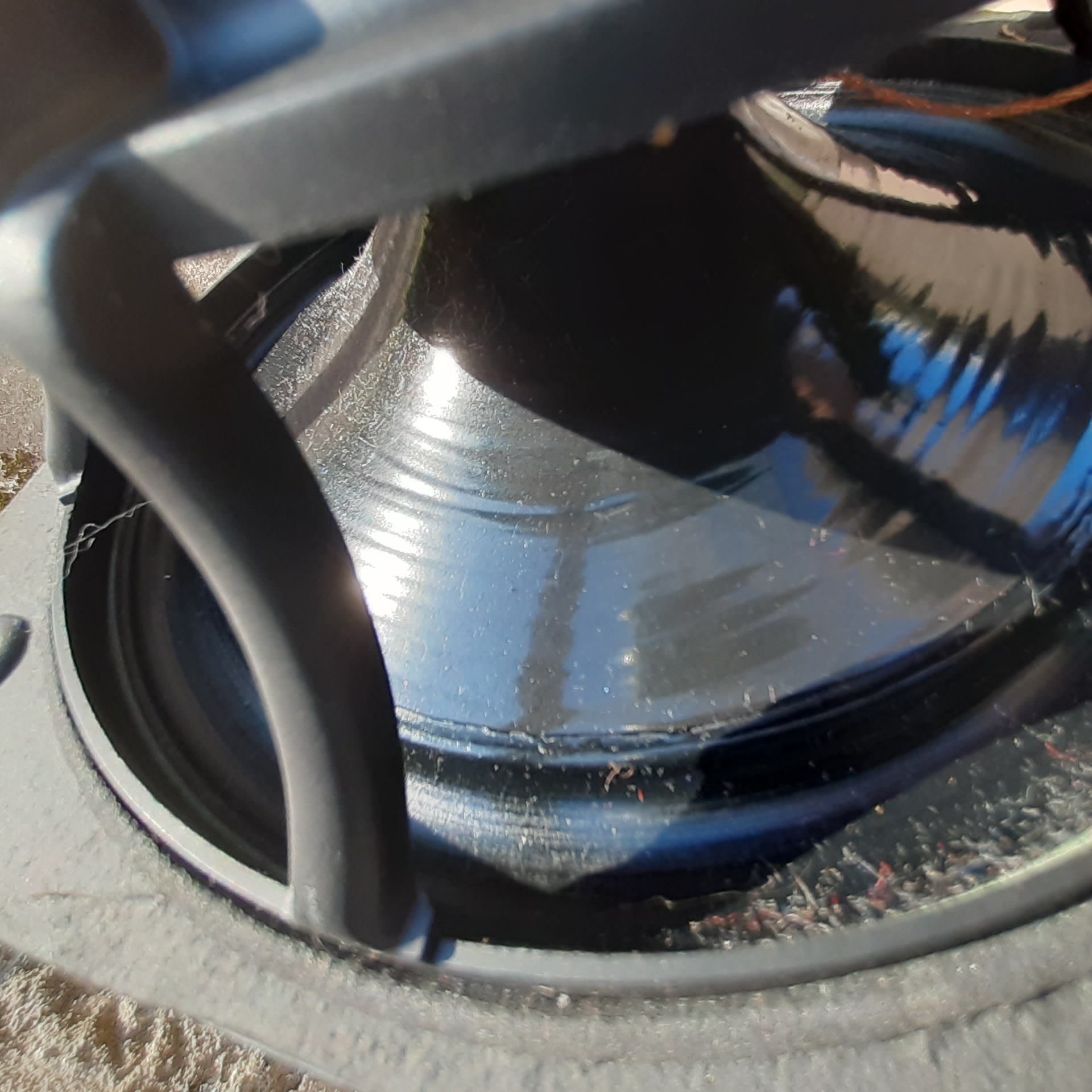

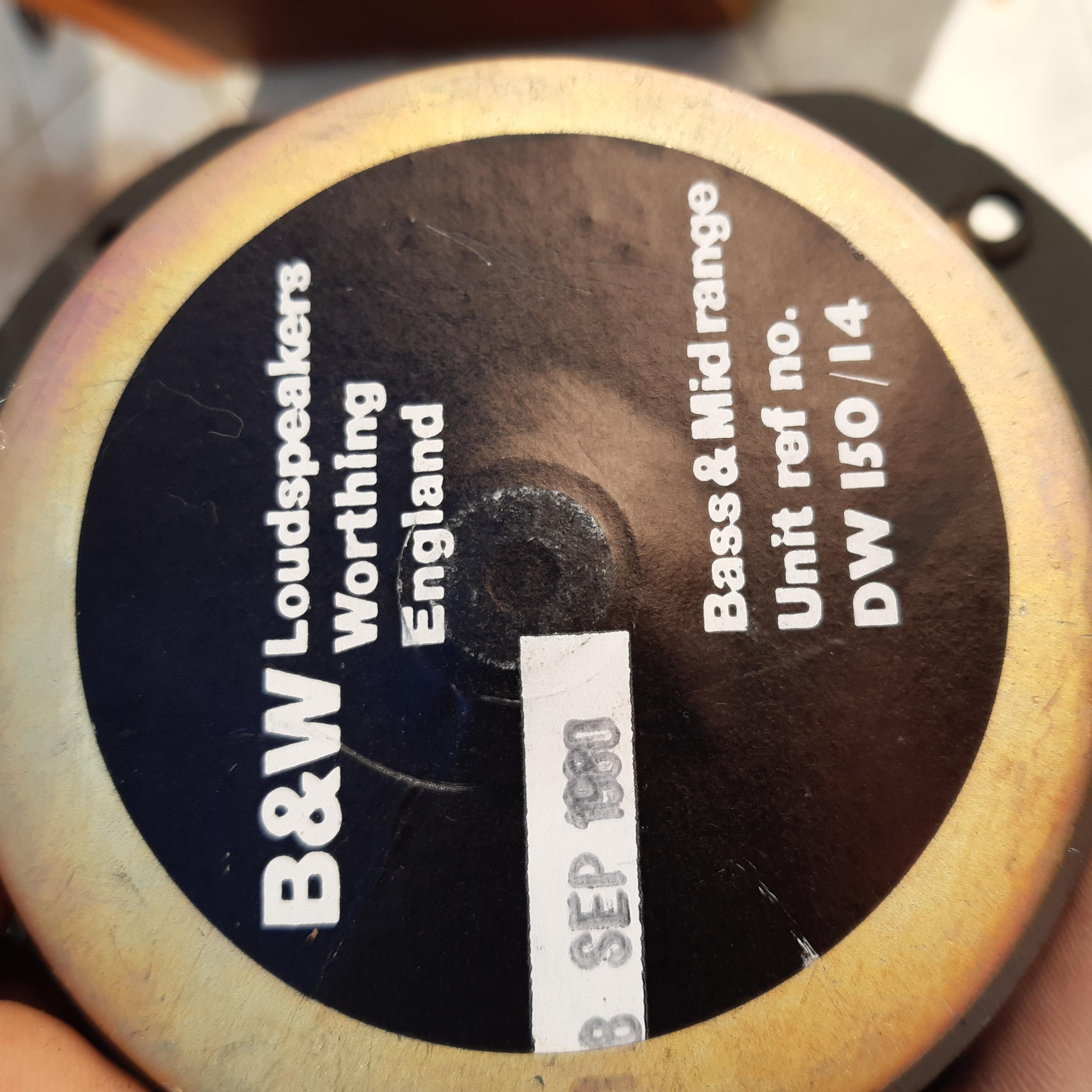

7.3" (18.5 cm) mid-bass x 2 : DW150/14 (14 ohms?) from the half of the surround it's a 5.76" (14.5 cm) polypro cone. back of the cone has a sort of wave a little like plastic coated paper but front cone suggest it's a full plastic cone. Not sure what the dust cover is : hard coated paper ? Surrounds are butylene, very light and thin... Speeder is weak, aging or born like that ? Qm should exhibit a high number. My ears are saying it has a good high mid and mid but not so a good bass. Perhaps the load, the drift value of the caps changing the crossover characteristics ? I can't say.

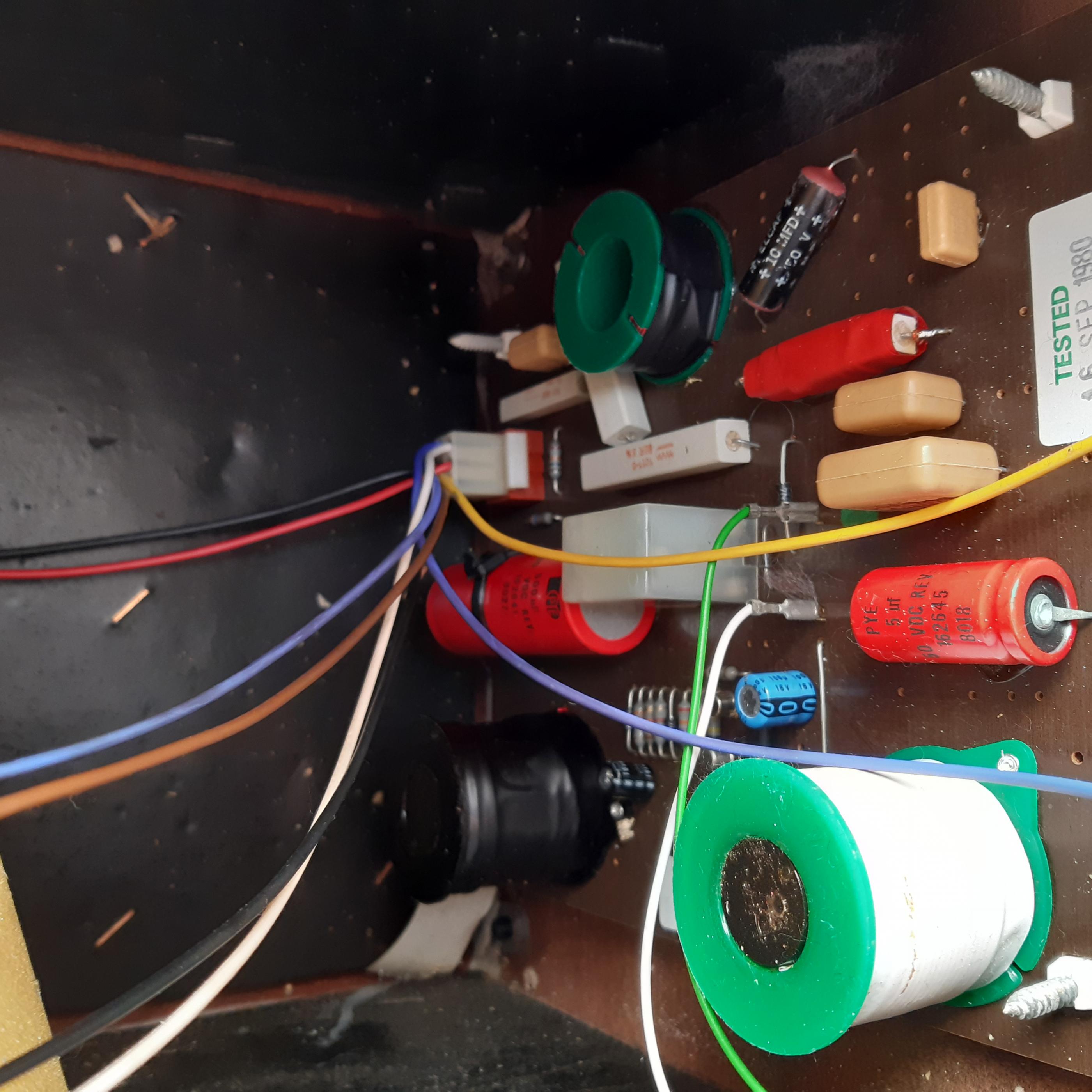

Not studied the filter yet. Lytic caps are PYE brand cap (the red 560 uF & 5 uF), some MKT or Mica (the browns) and mkp (10 uF) There is a little resistors network probably to supply the red led of the loudspeaker in the low left edge as it's not an active speaker and just mono wired.

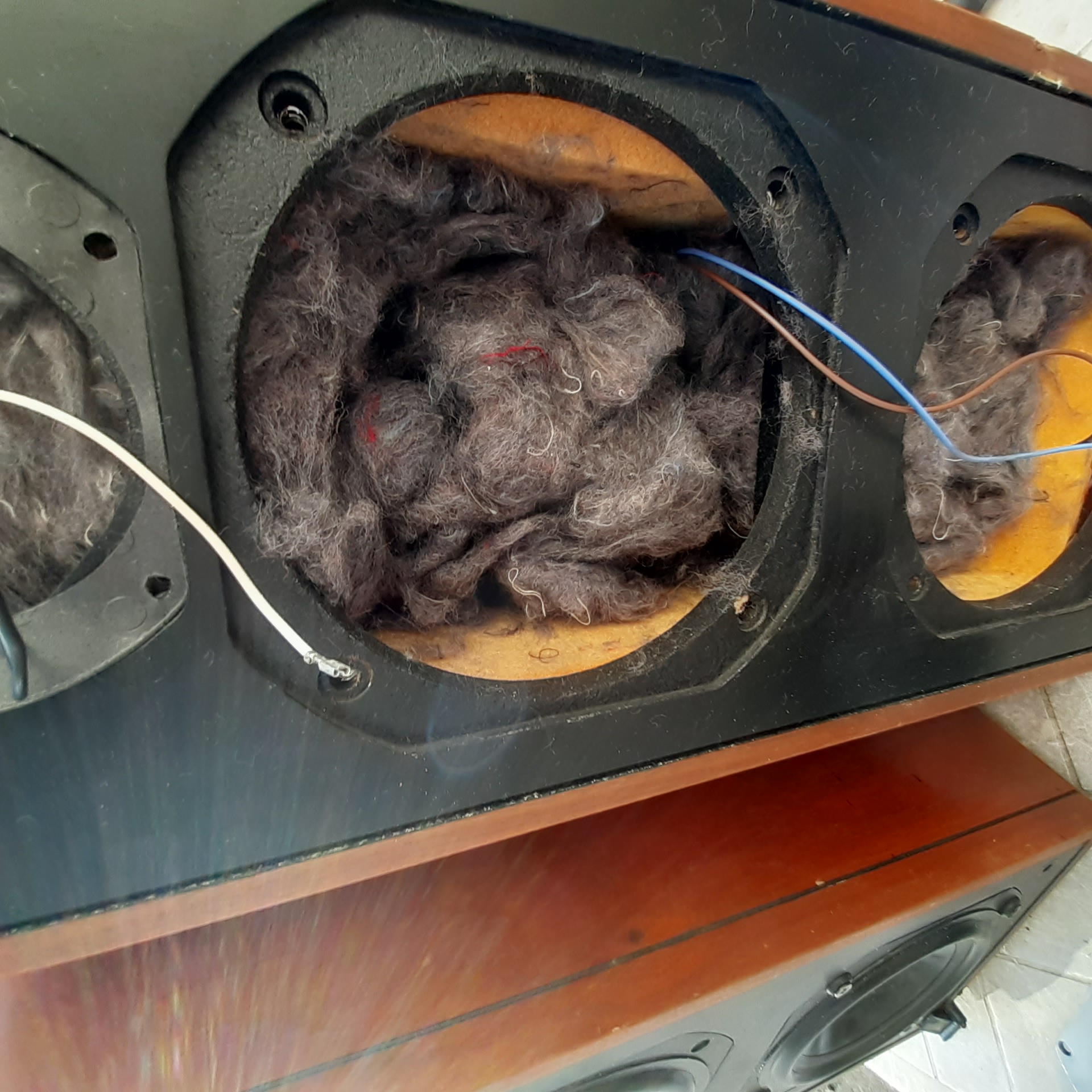

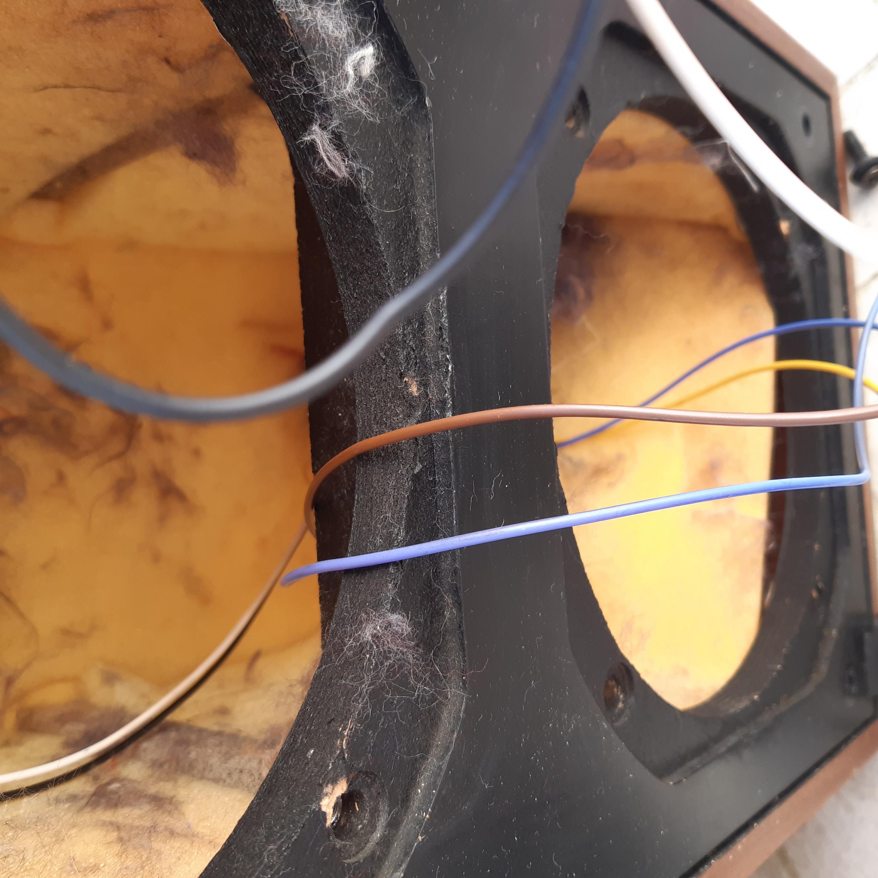

Veneering varnish reacts to the methylated spirit. Enclosure has two U pieces of dense foam to line the walls and the top/ back. Full of stuffing, synthetic wool. Enclosure is 57 cm x 25,5 cm x 28 cm (deep)

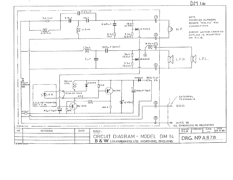

I can help with the crossover. Top section. Simple third order tweeter with a slightly rare 0.22uF snubber network (aka KEF Acoustic Butterworth) designed to fix the Fs resonance of a soft dome cloth tweeter. A 8.2R / 0.68uF zobel network to tame the harsh top end.
Middle section. A 2.5 way (Heavy 6dB bass bafflestep) bass network still in use to this day by people like Zaph. Bextrene is considered a bit passe and unrevealing these days, but worked. The late great Jeff Bagby approved this circuit too.
Disregard the bottom section electronic protection circuit. A luxury incorporating BC107A low power transistor and BC177A medium power transistor, all powered off the bass input by 1N4004 power diodes and kept powered by the 100uF capacitor.

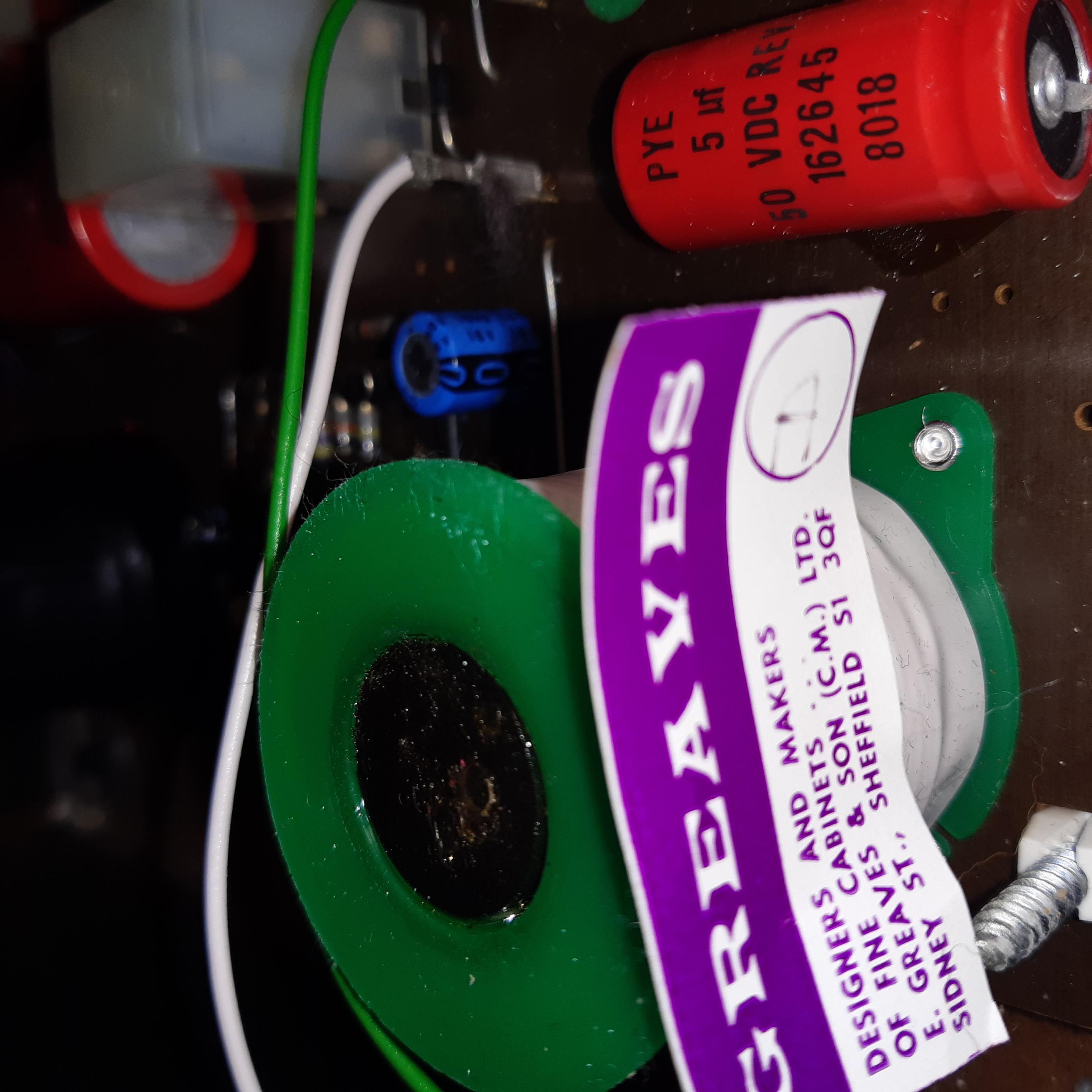

Shaun, I wish it were an ESL63 :D, For you and meanma1964, I found the owner manual if not having it.
look also what I found in the cabinet, the cabinet supplier was abroad... Sydney, strange ! (this cabinet where never opened before I did)
