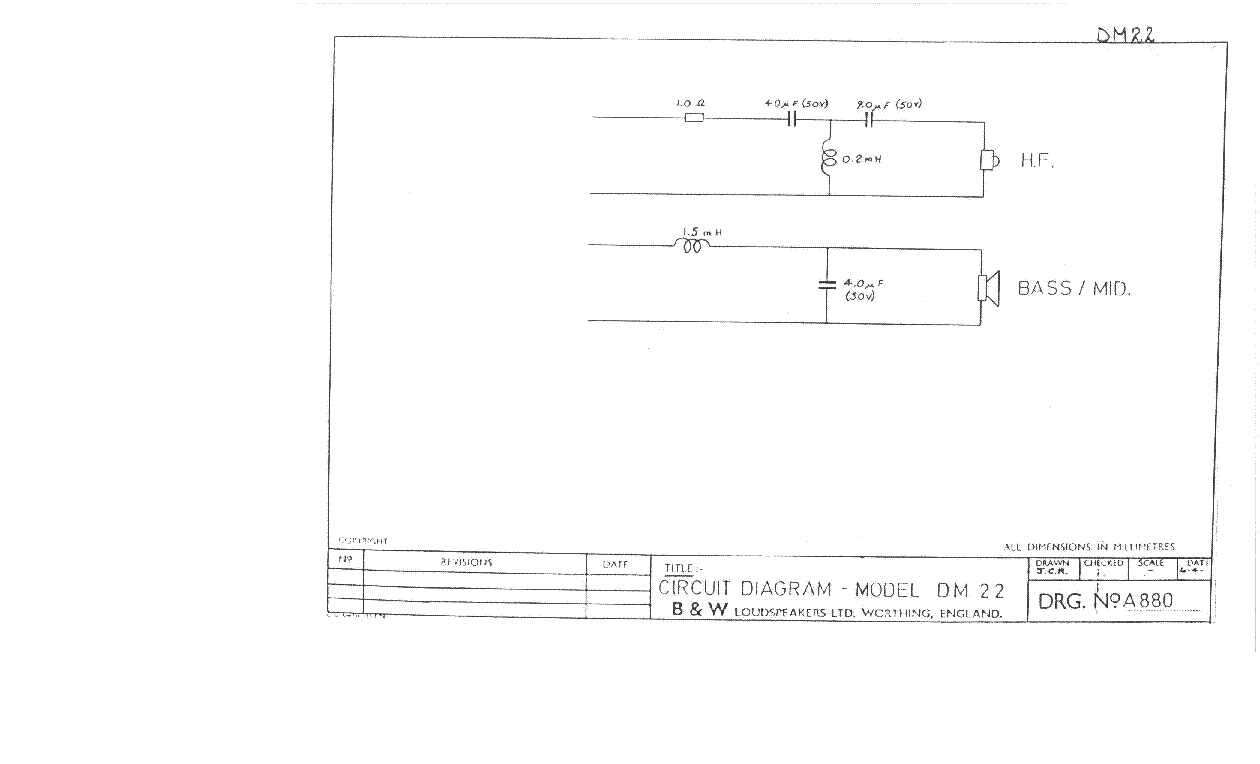

Attached are photos of my DM-22's bought on "Parts Only" basis\. The crossover was apparently going to be upgraded and parts are loosely soldered but looks very tacky soldering..... So I need assistance to assemble please. As well as components pictured, the Tweeters each have another Mundorf 4.7uf cap in the Positive lead just near the Tweeter. I could maybe patch something together if I have a schematic of the circuit. any advice will be hugely appreciated.
A fairly conventional mid-sized stand mounted 2 way. 2 inductors, 4 capacitors and 1 resistor. No circuit board.
Are you able to trace them out in their current connection scheme or is that what you'd like assistance with?
The sound of your speakers (after being modified) will be different. You will be noticed the different in sound for every 0.5mH difference in inductance or 0.6uF difference in capacitance (if you have good ears like mine).
