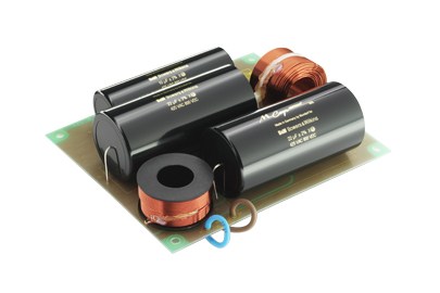

It is a first order electrical and there is a service manual on bwgroupsupport. Ideal candidate for a crossover tweek.
It seems to be 1.4mH bass coil to a 6" woven and coated Kevlar driver with a phase plug in a reflex box. 4,7uF and 0.5R optional level adjust to a 4 ohm tweeter. Positive polarity.

That's correct Steve! The picture I attached was purported to be a CM5S2 (i.e. CM5 Series 2) crossover - not a CM5 crossover. 🙂I'm not sure that picture that m'learned friend Galu posted looks quite right.

Thanks everyone for your help. The tweeter conked out on one side, but the tweeter itself is okay; so perhaps it's just a matter of replacing one capacitor.
I'd be surprised if a Mundorf 4.7uF capacitor has failed. Much more likely a break in the wiring or soldering.
To test a tweeter, just connect a 1.5V AAA battery across the tweeter terminals and listen for a scratchy sound. Tells you there is life in it.
Then examine all the connections.
This is a biwire crossover, so you can work with the top HF connection from the amp. Nothing will break. BTW, you usually need a wired link between HF and LF with single speaker leads. Just how biwire works.
