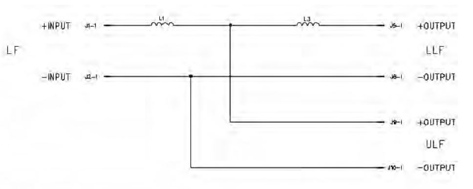

So a 4khz point was chosen for the sake of minimizing baffle effects on the tweeter. OK, so we drop the tweeter down to 2.5khz.

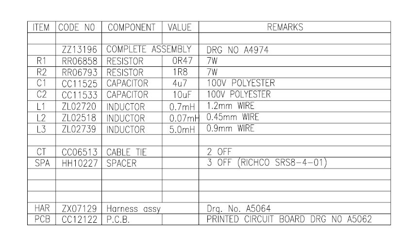

Take a look at the Low and Low Mid crossover.
What capacitor values will achieve a 2.5k tweeter crossover point and how can you steepen the Low Mid top roll off ? What would the choke value be?
Is that the filter? Goodness. Ok, well, it would be to add another inductor, possibly, and/or a shunt capacitor after L1 (and LLF) and before ULF. The whole system needs to be considered.
