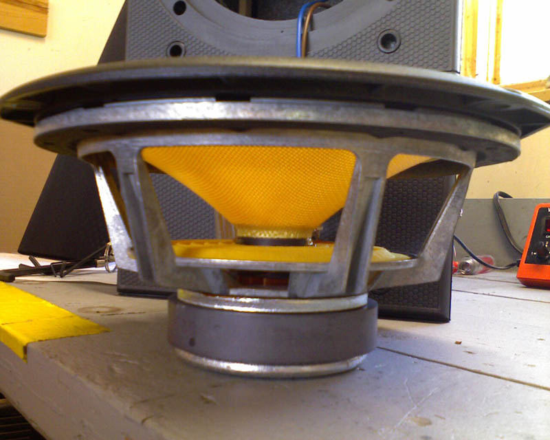

A quick look at the woofer itself. Kevlar cone, black pointy dustcap (not shown). cast frame. vented behind the spider. Not vented out the back of the pole piece, but the voice coil former has holes in it so air can move in there.. not sure if that's normal or not.

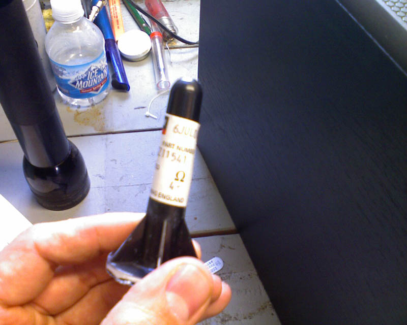

Tweeter is next. It's a 1" aluminum dome thinger.

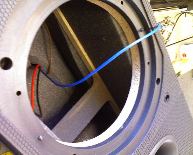

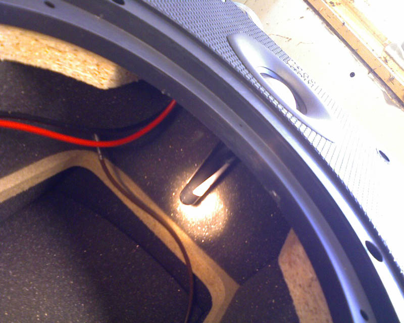

Looking inside you can see a little bit of nautilus inspiration trickling down into their lower line. The tweeter has a tiny TL rear compartment.
Upon closer inspection it looked as if the little plastic compartment was not straight. I reached in to feel it and sure enough, it was loose. The glue had mostly come off. Gotta wonder how long it's been like that!
I pulled it the rest of the way off and looked closer. It's got a little taper to it, and is stuffed with a tiny bit of acousta-stuf-style damping. Very cute 🙂
I re-attached it with some adhesive/sealant.

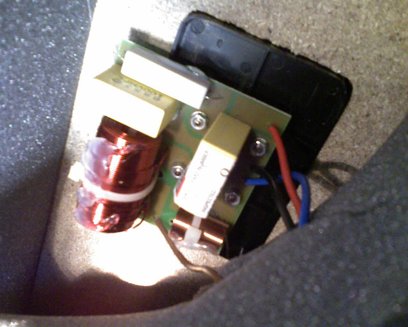

I took a peek behind the damping at the crossover. Very simple.
5 components. Looks to be a basic 2nd order with one resistor to match the level of the tweeter to the woofer. Since they're not my speakers I didn't go so far as pulling it out to check on the component values to see if I could work out what they were using for a crossover point 😛

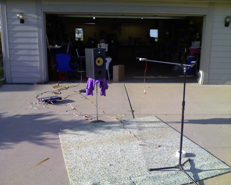

After the adhesive had cure on the tweeter's compartment, I put 'er up on the stand.
You can see here my EXTREMELY sophisticated measuring setup, complete with car-audio amplifier running off a radioshack 12volt switching power supply. I have the parts to build me a bench chipamp, but the car amp is nice for the time being as it has a very flexible active crossover, so I can do some basic initial listening and playing with crossover points.
The mic is a WM-61A capsule wired normally (without the Linkwitz mod). Sound card is an E-MU Tracker Pre. I'm using HOLMImpulse to take measurements. It's such a wonderful little application.

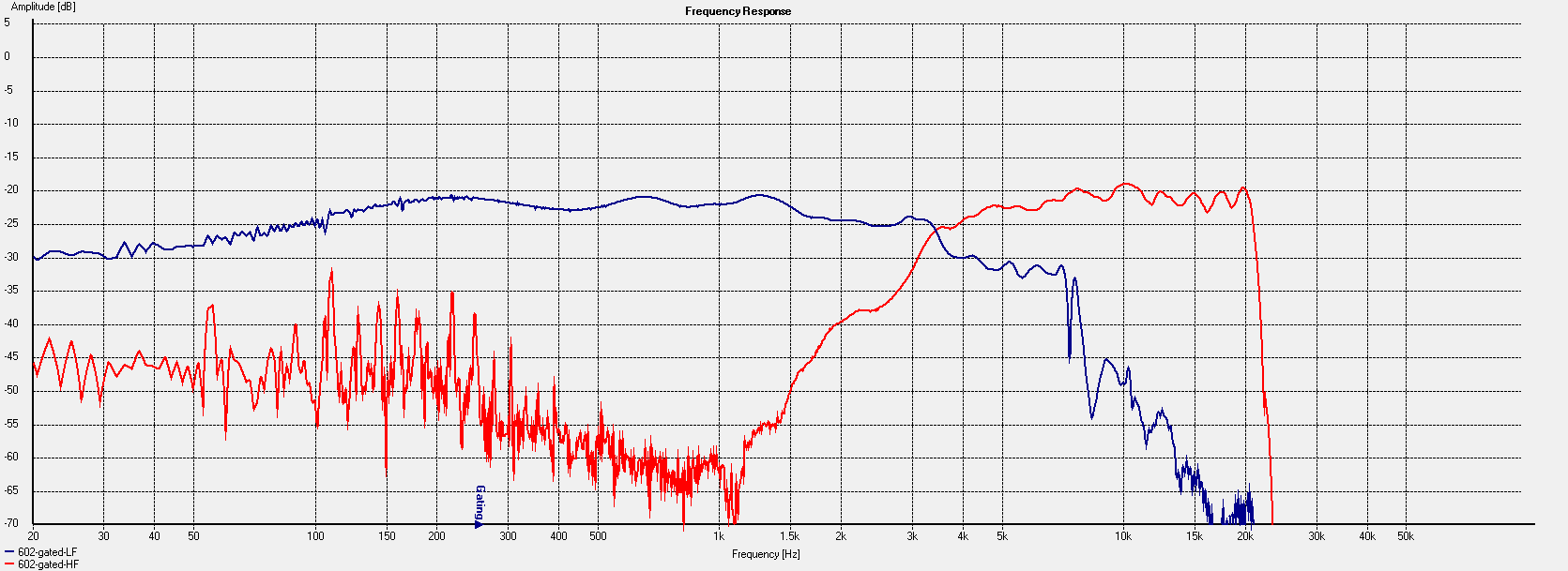

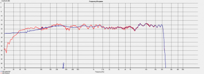

The first screenshot is seperate measurements taken of the woofer and tweeter seperately; the speaker has seperate binding posts on the rear for each, so you can bi-amp if you so choose, but you're still going through the crossover.

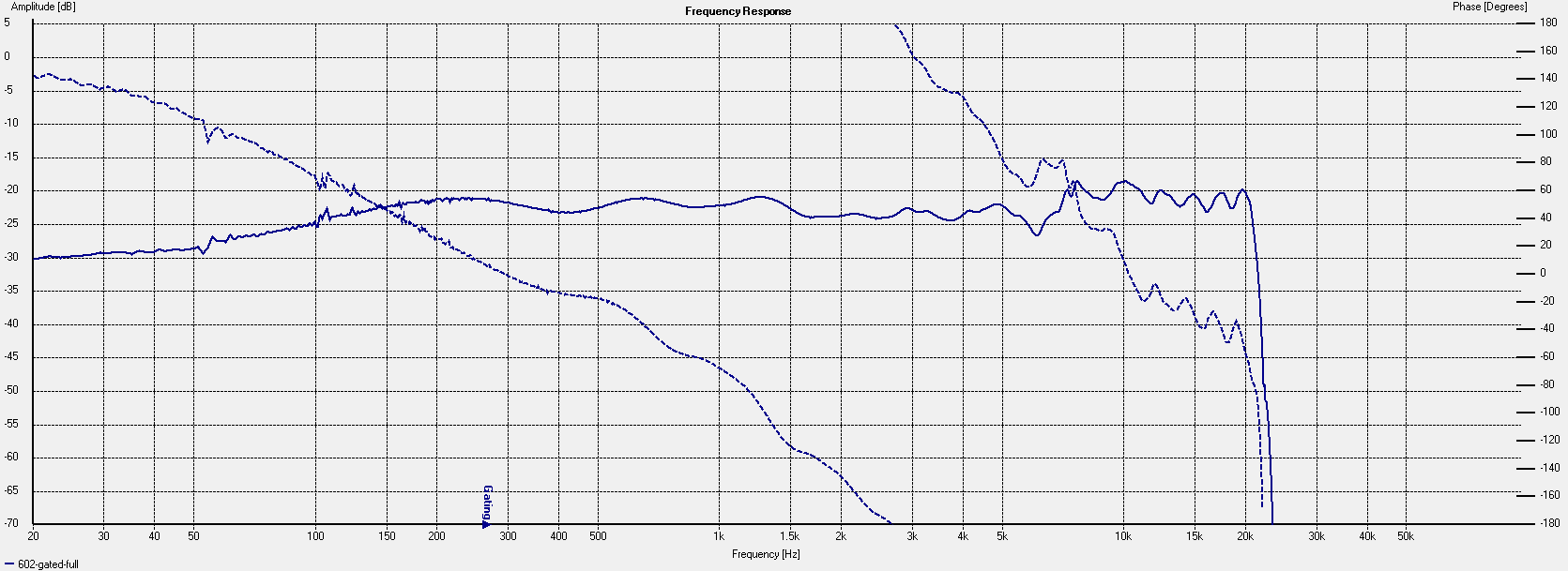

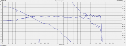

The second screenshot is both drivers together. I've overlaid the same measurement both gated and total response. Measuring outside is nice! I only really have the one reflection off the ground, so the total response is not out of hand.
The speaker does indeed measure quite flat! The tweeter runs a db or two hotter than the woofer, it seems, and that little dip at 6k appears to be a bit of crossover phase whackery, as both drivers measure nice and smooth in that region. It's pretty tiny though.

Also, i just now realized I forgot to show phase information. Lemme do that real quick...
