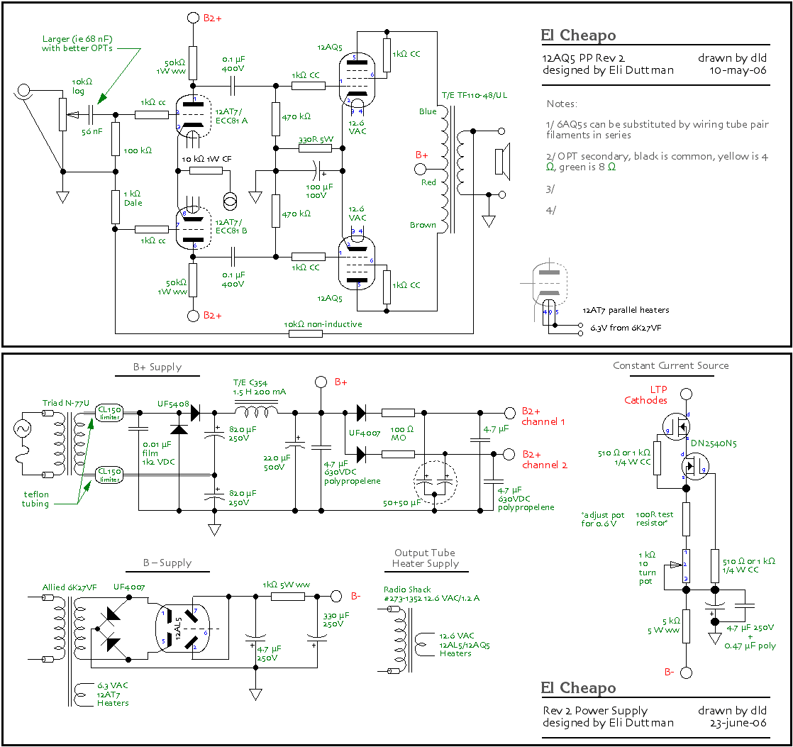

FWIW, take a look at "El Cheapo". Notice the 100 VA trafo used to provide B+ to 4X "12" W. tubes. That PSU is no small part of the design's success.

if i've got this right......................your load lines are in an area of the graph were the lines merge in to crayon.

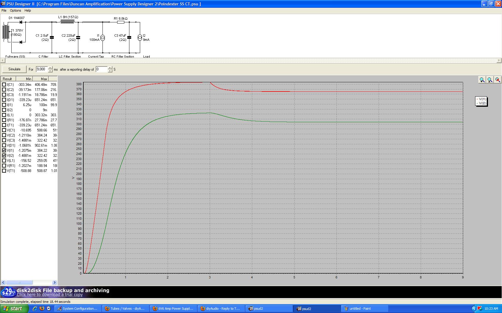

PS PSUDII schematic attached.

Hello Boywonder,
In my opinion the sag you are seeing is the amount of sag I would expect to come from the choke when you are fully loaded up at max power and pulling a 100ma of current through the choke. Your results support this as you did see about a 5 volt reduction in drop when running with smallest original power transformer. When you beefed up the transformer the first time you improved from a 20v drop to a 15v drop. Now the principal cause of the drop is the choke and no longer the power transformer. The only way you could reduce the sag further would be to go with a lower choke resistance value. Obviously this sag can be eliminated with a decent series pass regulatore but thats a whole different situation then the one we are discussing.
Mickeystan (aka Doug S.)
The schematic is too low rez to see component values, so I can't Spice it. However, I can tell it's a basic CLC filter. Based on your results with the transformer sub and description of the scope test, I agree with Mickeystan. The sag is very likely to be a combination of the series resistance of the transformer and filter choke. A 15V drop from idle to full load is actually pretty good regulation. I wouldn't worry about unless you have other symptoms.
