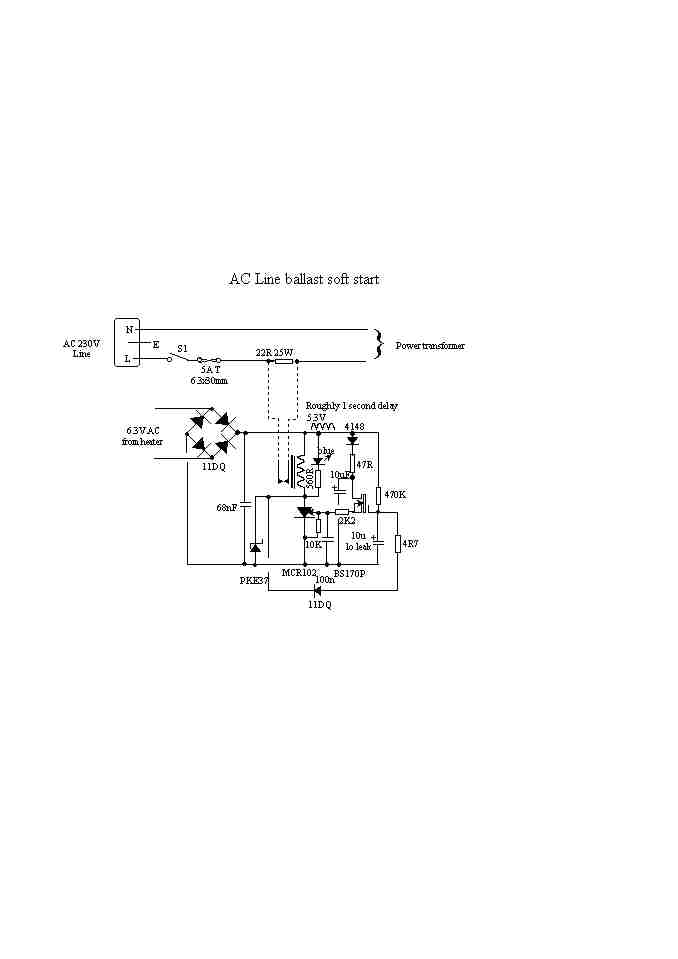

Using high VA transformers, that timer in post #1 wouldn't be any use where I live. The long C time constant in that circuit (C1,2) would keep relay closed some time after mains voltage has dropped. The wobbly plug problem is a nasty test but as it stands would simply blow the primary fuse.
Delayed transformer primary current limiting is the proper approach to avoid repeated fuse blowing on brown-outs and other AC line problems. Post 2ndary regulation can come after. The approach that Morgan Jones gives is one solution, but with considerable complexity.

Not sure where the warning is here. In the real world, after years of use, a 1.5A fuse has never blown. If I do end up with a wobbly plug (poor design perhaps?) and blow a fuse, this is not a bad thing.
Purpose of the timer is to allow the tubes to heat up before applying B+. Brownouts need not apply, the tubes are already warmed up, and will stay that way for 15 seconds with a complete power outage.

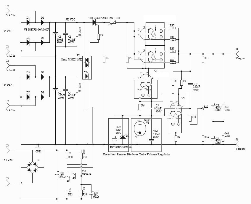

In my amp, I use an 8051 to switch a solid state relay on the primary side of power transformers. Very simple electrically, but there is some software to write.
What is the goal in delaying B+? The general thought is that it will avoid cathode stripping, but there are other problems that are created. If you apply power to warm tubes and you have a large time constant in coupling networks, you can couple a nice big current surge of more than a second into the output stage. That can't be good for the power tubes. It is worth considering the possibility that applying B+ to cold power tubes might be easier on them. I don't know. One would have to do an expensive controlled study to know for sure. I'm not willing to fund one.
I opted for total control in my amp. I have it set up with three power transformers; a filament transformer, a high voltage transformer for the voltage amplifiers, and a high voltage transformer for the power stage. I turn on the three in succession. The first transformer to come on is the filament transformer. Then when voltage amplifiers are warm, B+ for them comes on. Bias supply is also on this transformer. After bias and anodes of VAs settle down, I switch on the power tubes. No current surges or cathode stripping(which I am not convinced causes much damage at start-up in these non-transmitting tubes anyway).

I suppose that's a reason for some people. I use it for when I have a quasi-choke input power supply (which is most of the time) coupled with SS rectification (which is some of the time). Without a delay, the B+ would rise to very high values until the power tubes conduct.
Application-specific, but very necessary IMO. Nothing to do with cathode stripping.
Yes, that's a very good reason to delay B+. I just fear that many are running away from the cathode stripping ghost only to meet something worse.
I've been playing with Maida regulators with C-input filters and am very pleased with them. My only complaint is that the damped oscillations from diode reverse recovery make it through to the output. Haven't tried RC snubber yet but I have just completed measuring leakage inductance of the transformers, so that is next. If I can get that out of the output, I will never look back. AB output stages really like the low supply output impedance. I sure don't miss that huge choke.

Circuit hints: I use this one for all primary inrush snags from 100-1000VA. It trips out as fast as relay permits i.e small frame relays around 20mS. Thyristor held into conduction by back emf of coil.

Rich, I like your circuit.
