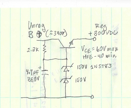

Hopefully B+ can be regulated w/ something simpler-
Penciled something up linked below. 'Net research doesn't seem to like series/shunt designs for hi voltage apps... but I'd think the series'd zeners change the operating range dynamic from total V to affected V..
Thoughts?

Most of the capacitance is bootstrapped, anything between 100 Ohms and 1K will do as a grid stopper.

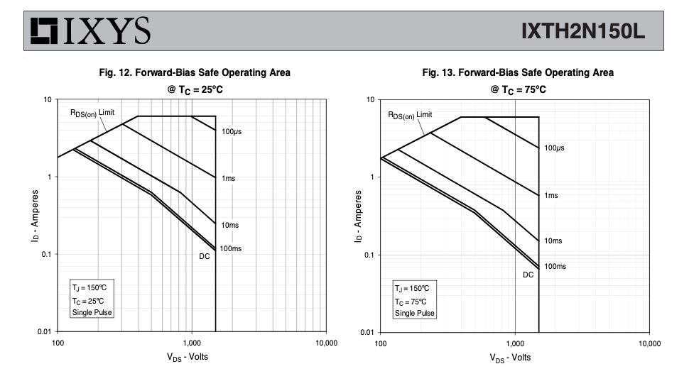

Id be more concerned about your choice of mosfet. There are some specially made to work as DC regulators, the IXYS L2 series is an example, these have higher DC overload potential and hence are harder to kill. This part is expensive but hard to kill
IXTH30N60L2 IXYS
I suggest a modified circuit with transistor current limiting and an additional RC stage between the zener stack and the mosfet.

Problem w/ FET is gate voltage headroom needed- I don't have it unless I build separate reference circuit...
I'm bridge rectifying 240vac to dual 330uf(s) PI network to extract much E as possible. The shown 340V is product of 240 x 1.414- no load. Since FET's require 8-10vdc of gate E over target out of +300, I chose Bipolar to maximize I out- sorry for not being more descriptive.

"I built several using various MOSFET’s, one of them does 600 VDC @ 500 mA (continuous load...)." When I looked at building a regulated screen grid supply recently all the mosfet's I looked at have very low current capability at high voltage. Look at any SOA graph's for high voltage mosfets and you'll see what I mean.
If you use a bipolar not many are rated for high voltage and those that are have very small hfe, the best series pass device for HV is a valve or valves in parallel.
There are several design's out there for HV regulators but not many have really good SC protection.

Not sure if Vce will ever see hi voltage? Seems to me that value would be delta V, or 60V max Vce. Perhaps during warm up- but if properly biased Vcb, then emitter should follow and all voltages should come up at similar rate- unless a big current change during warm up.
Think I'll try circuit w/ NTE376 and monitor voltages. W/ Vce of 300v, there's safety margin. Yeah it's kinda pricey.

if you don't need the 1500V capability, stay with the 5-600V devices.
I use the 75V 80A part in my regulator for 833 not because you need that much safe operating area in that application, just because its a bombproof FET and has some nice behaviour around 5A
