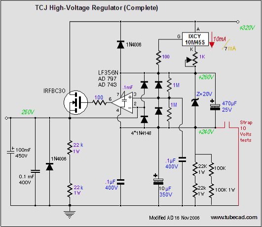

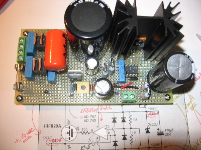

Bengali,
A nice new design from John Broskie:
http://www.tubecad.com/2006/11/blog0087.htm
I did build 2 of these for 250DC volts and 50mA load for my phono stage
Working real great!!
These can be called "regulations..."
I did use a LF356N as IC and 7mA in the IXCP 10M45 {could use a DN2470}
Ripple invisible at the scope... and no variation of output voltage between
0 and 300mA... done tests until 1.2A
regards.
Alain.

I like the Design, any chance I could sneak a peak at the schem?
