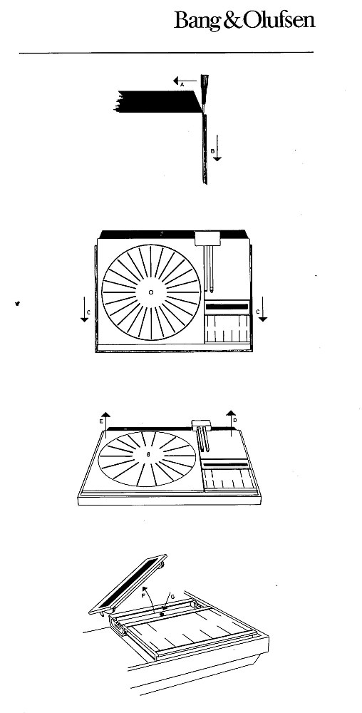

Hi.
I have acquired one of these.
Can anyone tell me how to dismantle it ?
I can get the turntable off but cannot see how to dismantle further.
The belt is off and it does not appear to have any life.
Any help is appreciated.
Andy

Hi Andy,
It's been years since I seen one but, if my memory is correct, starting with the platter removed, the outer wood trim slides towards the front about a 1/4 to 3/8 of an inch. Push from the back corners of the wood trim towards the front, (I can't remember if there were two flat head screw in the back corners that held it or if the dust cover had to be removed)
The small aluminum rectangle on the right side needs to be removed first. Once the wood trim is slid forward, the right edge of the panel should lift up out of the slot on the trim assembly that holds it. Once the right edge is up and clear of the trim it will slide to the right unclipping it from the table.
The front edge of the aluminum square around the platter forward should be able to be lifted from the slots in the trim assembly. Pivot the front of it up and slide the panel forward to unclip the back edge.
Definitely remove the cartrige before attempting this. It is slid into the end of the tonearm. You can probably get a look at a cartridge at Vinylengine.com
Hopefully this works, like I said it's been 30 years. I used to service them under warranty.
Let me know what you run into, or if it works.
Regards, Mike.
Hi Andy,
Please find here a scan from my very old archives, it may help you.
