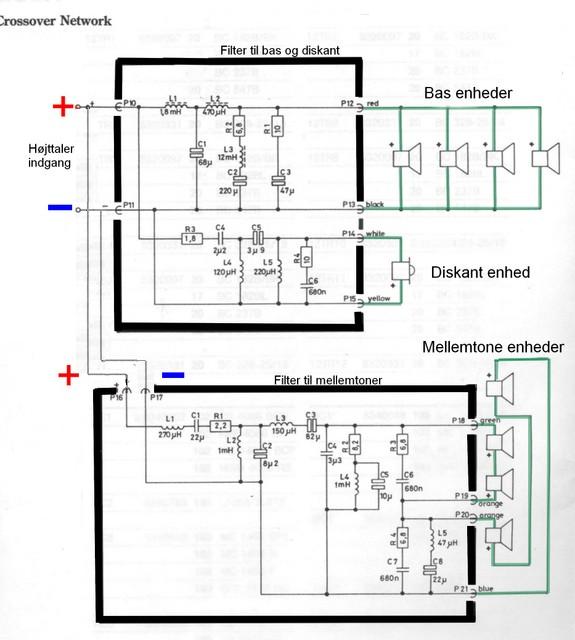

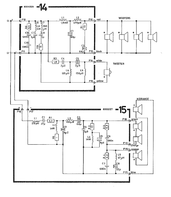

The B&O Penta was updated two times, giving v1, 2 and 3. For v2 they updated the crossover and I was hoping some people could share knowledge on what the changes have done.
The speaker units for all versions never changed. Penta has always had a weak mid-range response and a less than bright top-end. Did they try to fix this in v2/3?
(the one with 14 and 15 is the newer version).
Crossover points for the original were 700Hz and 3,000Hz. Not sure if it changed for v2 and 3 and can't find spec sheets.
