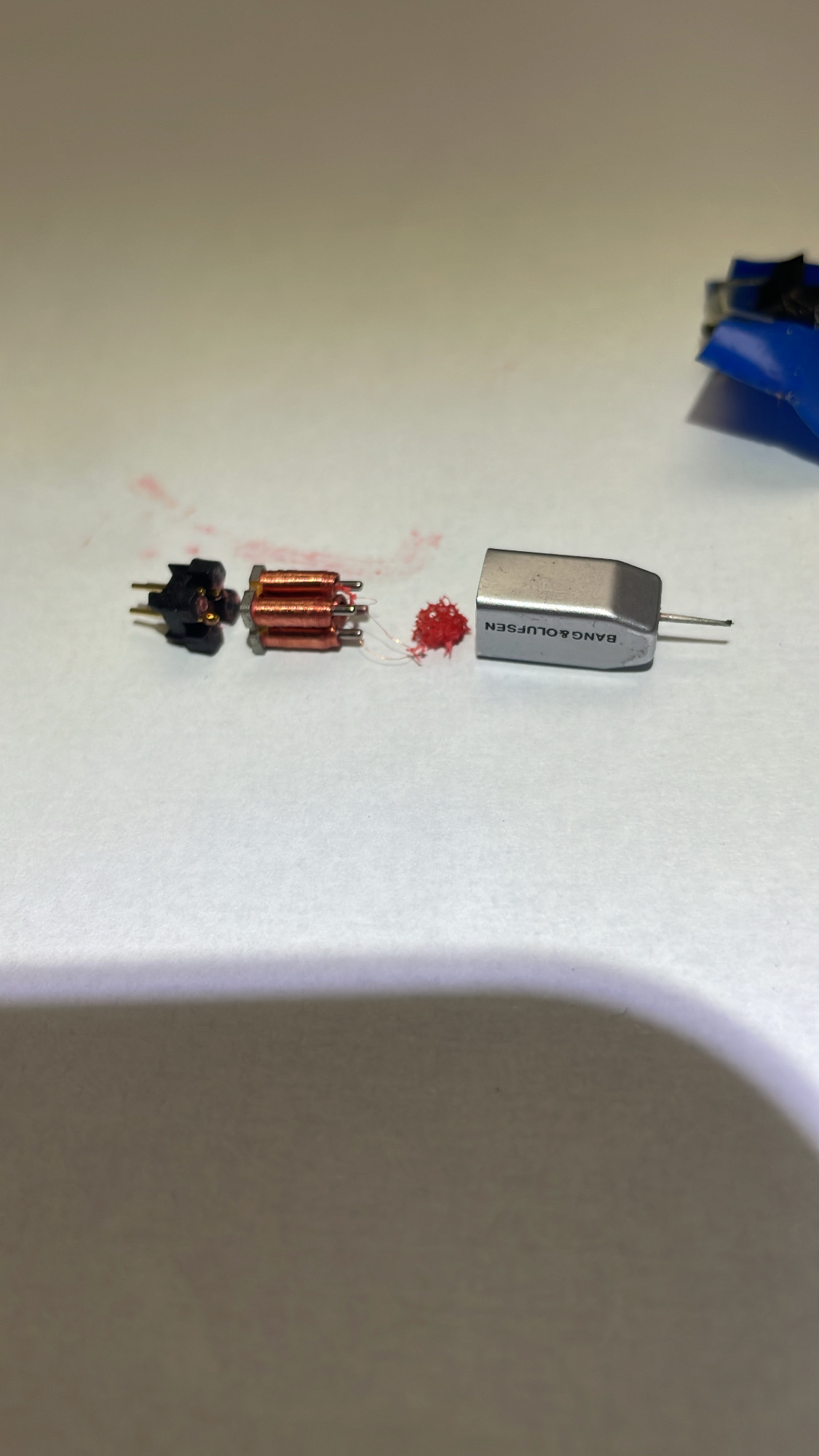

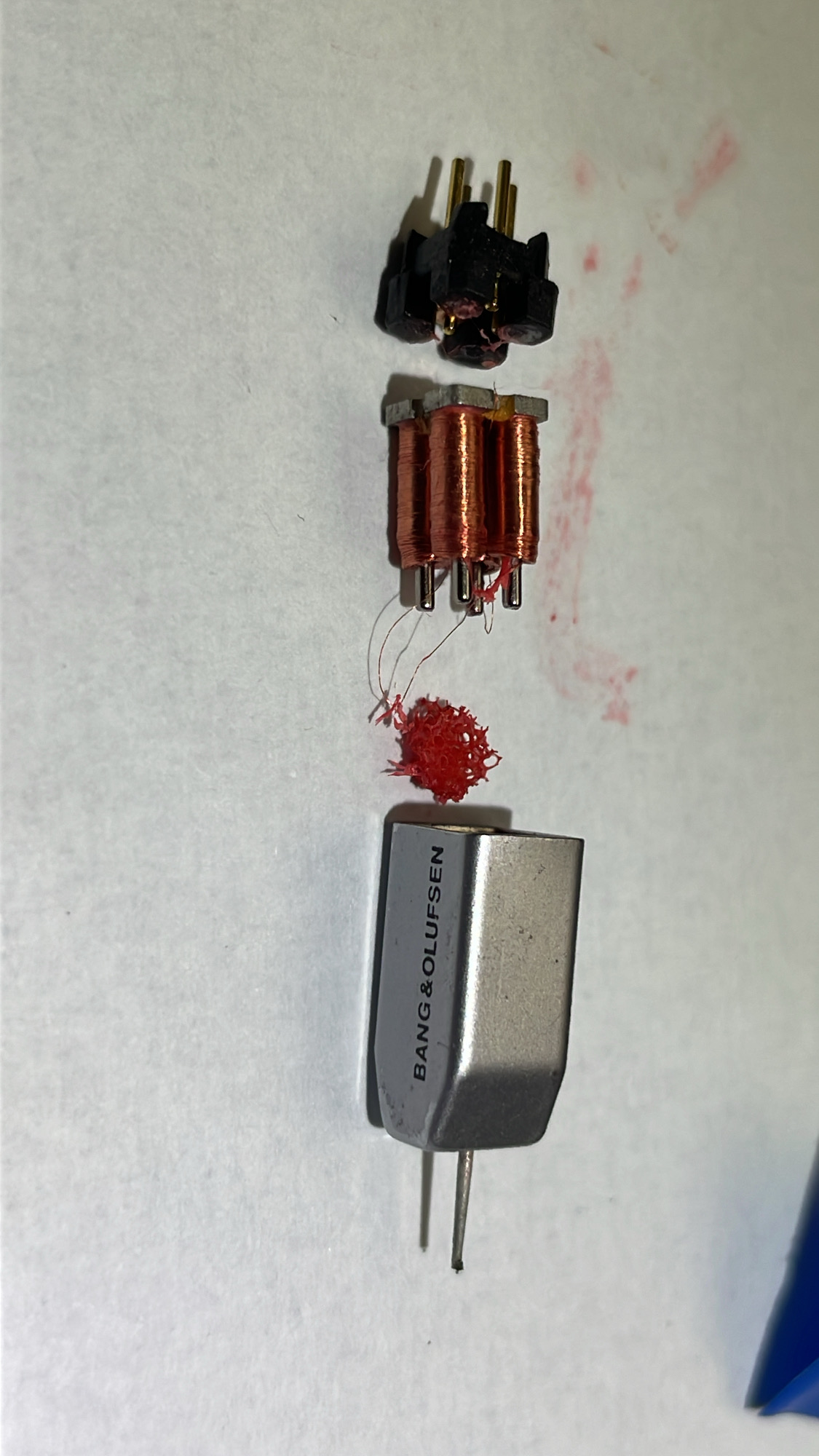

Hi, i have an mmc4 stylus which had one channel not working/had very very low output. Since I’m too curious not to, I thought f*** it and opened it up.
Can anyone suggest how it is supposed to work?
I can’t find resources/ drawings or anything about the “wiring” of the coils.

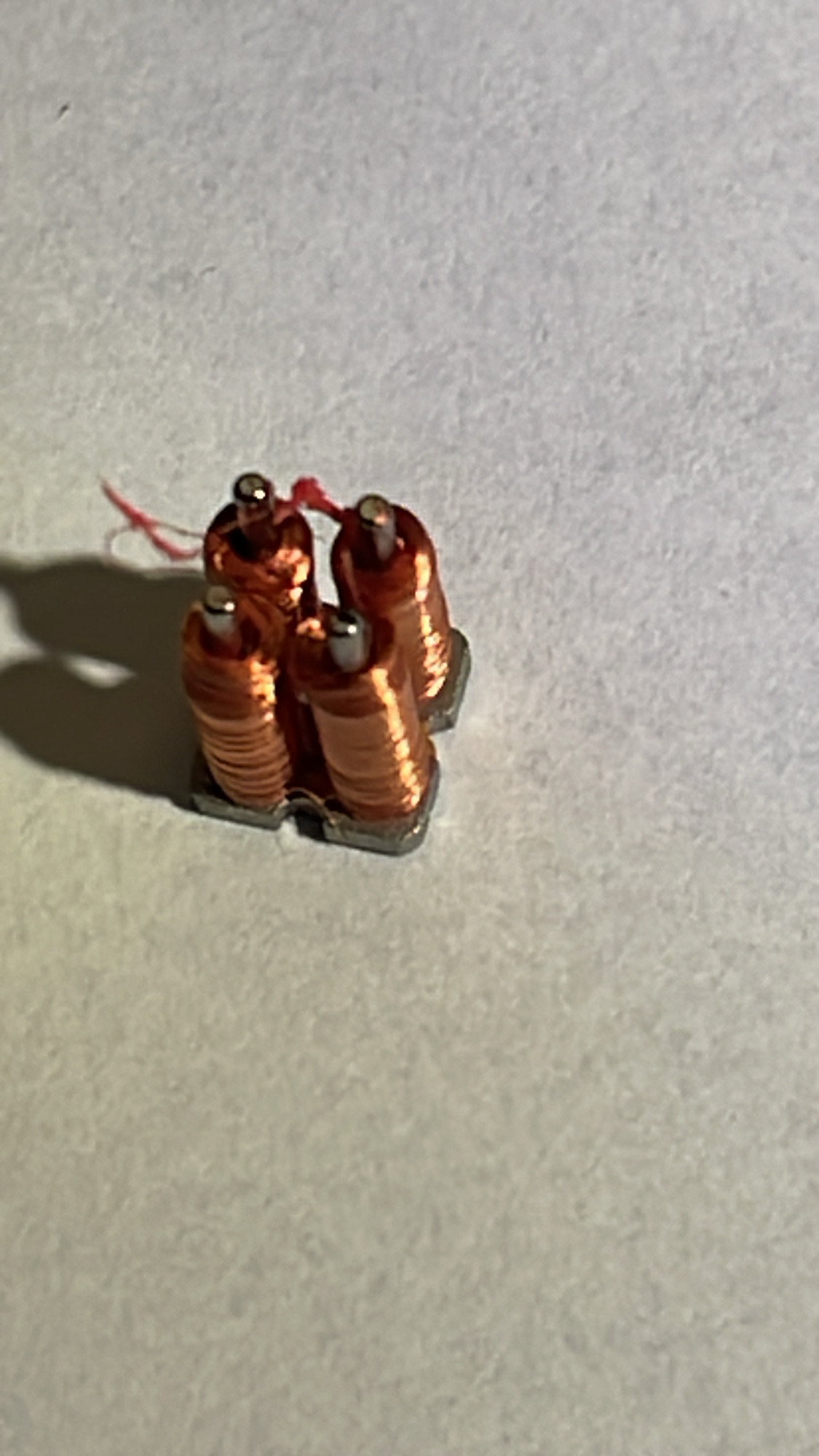

After extracting the coils i noticed that part of one had become loose/ potentially even has a break in the wire except its so tiny i’ll need to get a magnifying glass.
Any advice on how to do surgery on it (if its even possible)?

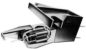

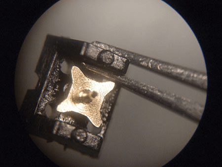

The MMC stands for "Moving Micro Cross". The cartridge is a moving-iron (not moving-magnet) design as described in this article:
https://www.stereophile.com/phonocartridges/408sound/index.html
"Moving-iron designs ... use stationary coils and magnets and a small piece of "moving iron." In the original B&O design, what moves is a cross-shaped piece of ultra-low-mass, high-purity iron attached to a soft elastomer damper stabilized in a plastic frame. The iron also incorporates a minuscule tube into which the cantilever is inserted. Each arm of the iron cross is associated with a fixed-coil/magnet structure and as the cantilever moves, it varies the distances between the four arms of the iron cross and the four fixed-coil/magnets, thus inducing tiny voltages within the coils. The advantages of this arrangement include ultra-low moving mass, even compared to an MC design; relatively high output (because the stationary magnet/coil structure can be made large); high suspension compliance; and low vertical tracking force (VTF)."
Here's an image of the moving micro cross:
This a cutaway of an MMC 3R:
Soundsmith is the leading authority on moving-iron cartridges.
In India, in the early days of quartz watches, I have seen people rewinding the tiny stepper motor coils, the wire is thin.
They used magnifying glasses, and 5 Watt soldering irons.
But the labor price in your country will be high, better get a new one, you will get a new stylus also, I think...
Rebuilt will perhaps get you a worn out or different profile stylus.
If you can not see or measure where the wire is broken, you can throw that thingie into the thrashbox.
Its not true that B &O makes rebuild. The declined the service therefore more than 10 years ago! Complete!
Soundsmith sells spare cartridges, i have no idea if they are good or not.
Worn out stylus do not deliver no sound on one channel, they are usually louder due distorsions.
@Galu yep, perfectly aware of it! I was hoping there could be a way for a diy fix but seems like I'd need lots of studying, a microscope, steady hand and way more patience than what I have. And rebuilding services cost as much as a working one so it doesn't make much sense i guess... Still, really interesting design. The soundsmith article is a bloody interesting read, thanks for the link!!
