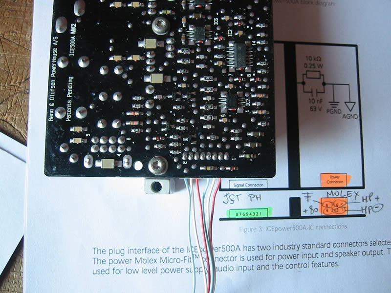

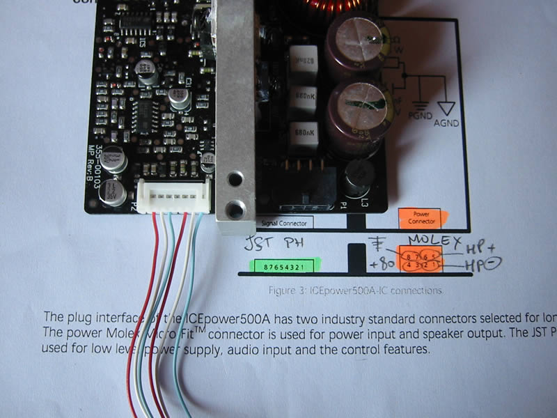

Hello
I build a 500A
http://www.icepower.bang-olufsen.com/files/solutions/icepower500adata.pdf
I doubt on connecting connector JST
the data sheet said something (page 3/16)
and serigraphy said something else
where is the pin 1?
Thanks !
