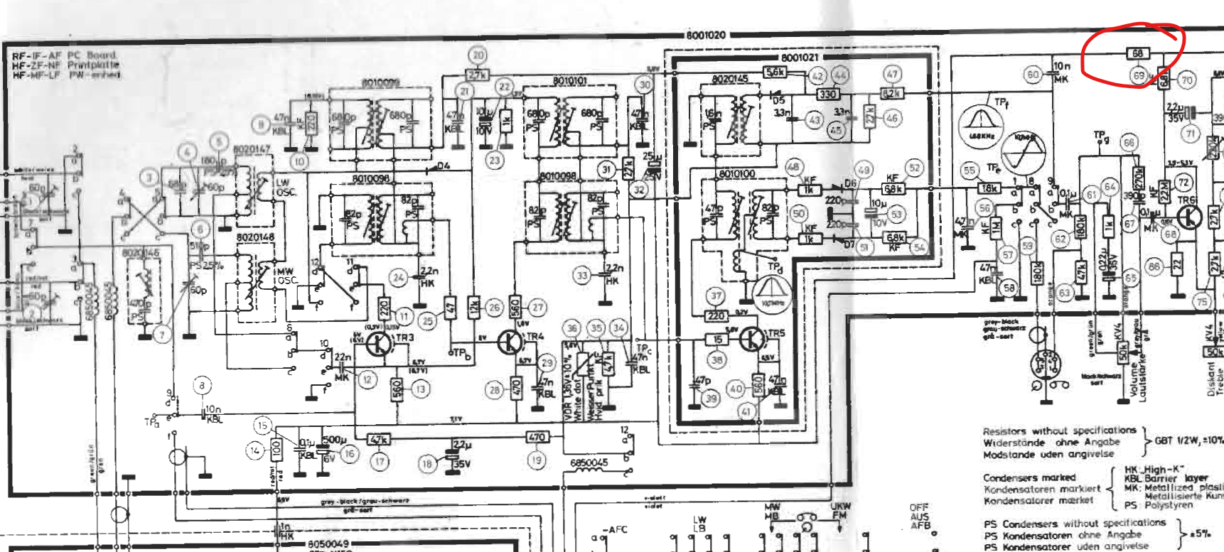

It's definitely not an audio fault. Took a little while to prove it because it turns out that you have to press FM and MW buttons down simultaneously to connect to the DIN socket, but once that was done audio burbled out. A bit tinny because the covers were off, but definitely present and correct. Time to check DCs in the IF strip etc. I am rapidly losing patience with the idiot who shows the PCB layout from the component side (which is difficult to probe), rather than from the foil side which is entirely exposed and easy to probe. I'd scan it, mirror it, enlarge it and print it, except the legends would then be back to front.

Good, cleared the audio section. Low B+ in the IF is a classic, also the front end. It can work, but with very low signal levels. Open bypass capacitors usually cause oscillation or bursts of RF at other frequencies. But all bets are off as to how a circuit reacts to however a bypass capacitor went defective.
If the DC is all normal, bypass each bypass cap with something like a 1 uF film (or whatever you have handy). A change in performance means you hit a bad one for sure. No soldering required, this is a quick check.
