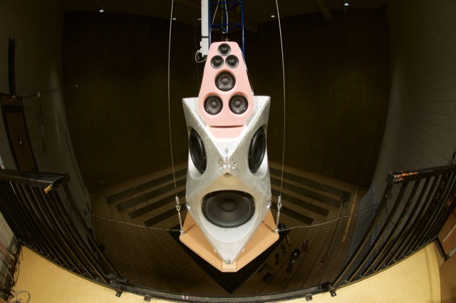

I fail to understand how the polars can look as constant as it does on page 15 and 16 (narrow and wide) when multiple drivers are used in a cluster. That would normally lead to lobing in both planes. Would be nice to see independent measurements.
Yes! That's what I'm perplexed about. Horizontal directivity, I can understand due to perhaps the properties of the phased array (judicious cancellation and delay to yield smooth directivity characteristics) and B&Os DSP. Vertical directivity? I can only imagine large amounts of lobing.
EDIT: Geoff Martin, the designer, provides further details of the DSP setup:
'The point of the rear-facing drivers is to interfere with the front-firing drivers. However, this is done in a very controlled fashion using an individual FIR filter customised for each driver. Consequently, at one frequency, the back drivers may be cancelling the front in a given direction whereas at another frequency, they are “helping”. The magnitude and phase responses of the filters are the result of the measurements of the drivers in their locations, and an optimisation algorithm designed to find the best possible solution to the target of a given beam width.'

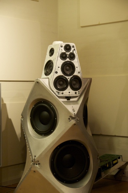

I meant to say that smooth horizontal directivity is IMO fairly achievable with such a design, but I doubt the vertical performance. To put it another way, vertical lobing is a bigger problem with this design in my opinion.
I know you referred to the horizontal, but I don't see how it's much different than the vertical. As you can see from the picture below, the drivers are also placed next to each other. They are placed in a triangular fashion that minimizes the spacing a little but it doesn't solve the problem.
attachment.php
So normally, even with the narrow setting, there would clearly be horizontal lobing and combing. This will increase when choosing "wide" and using the drivers on the side. But both the polars look great. Either they have solved this somehow or smoothing is covering it.
Bjørn:
First off all, I think you are right about the vertical response. It has to be somehow affected by the number of drivers. However, the energy response in such a setup will benefit from the kind of dispersion control you have in the horizontal plane.
So if we look at the horizontal dispersion control to begin with, you can say that lobing will occur if drivers are spaced far apart, but then again, you only need 3 drivers to get perfect dispersion control at one frequency. So what BO is doing here is that they have two narrow band dispersion control speakers facing forward, one with midranges and one with tweeters. The three forward facing tweeters will work together to control the dispersion in a relatively narrow band, much like the first 3 rings of the ESL63. The band that is not covered by this is at a significantly lower frequency band. This means you can successfully extend the dispersion control with the additional tweeters on the side without running into serious horizontal loobing problems. The midrange array is slightly larger and can therefore perform the same task at lower frequencies.
Then if you imagine a mic in front of the speaker, and you lift it upwards you will off course get lobing. If you place the same mic behind the speaker, you will get almost nothing at all. If you start lifting it, you will need to lift it pretty high up before it starts picking up a significant amount of energy from the front. This is a good indicator that the energy response is pretty nice too. However, how nice it actually is will be up to the interaction between the vertically spaced tweeters and midranges.
