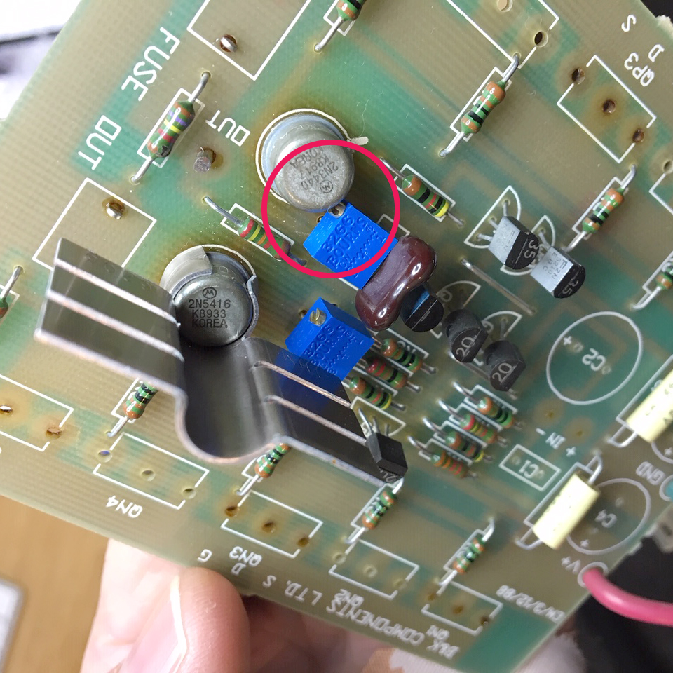

Parts are here. Problem on trimmers.
The trimmer legs fit perfect into the board. I don't have to move them. However, the trimmers aren't as tall as the original Piher trimmers, which are Amphenol Piher now. One trimmer is okay and I can reach the trimmer tool to adjust. But the P2 (DC offset) trimmer adjustment screw butts into the BJT transistor, and that's without the heat sink on it.
So now I find myself needing taller trimmers and wondering if I should just buy the Piher style, instead of the Bourns??
The trimmers in the pics are just loose fit, not soldered.

I don't know what I was thinking ... the trimpots are on the solder side of the boards ... but there is still the fuse/fuse holder to contend with. I can use the trimpots I have, but they are too small and require positioning at an angle in order to get the adjustment tool in. I'm going to order the larger trimpots. They'll be at least equal to the Piher single turn that were in there, if not better. I'm guessing better based off my experience with Bourns.

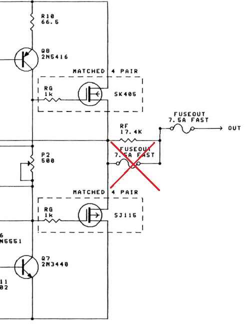

Why not eliminate the speaker protect fuse that is mounted on the board? You already have speaker protect fuses in the back panel of the amp so the board mounted fuses are redundant and not needed. Remove the fuse then desolder and remove the fuse clips and solder an 18ga wire across the old fuse location. Then you can use the trim pots you have.
"the board mounted fuses are redundant and not needed"
Read my last post again.
You have speaker protect fuses, two of them in series per channel (4 total), you only need ONE per channel (two total)! Eliminate the board mounted fuse and keep the one in the rear panel above the binding posts.
Irregardless of what you do with the pots you should eliminate one of these redundant fuses because they do hurt sound quality.
Okay. I remember someone on this thread mentioning that the speaker terminal fuses aren't all the effective.
If I remove the fuseholders, that the schematic shows to be 7.6 amp fast-blo ... does it make sense to put that value fuse at the speaker terminals?
I modified a picture showing how your amp is set up. Eliminate one of those.
If the point of the speaker protect fuse is to protect your speakers then a 7.6A fast blow is just about zero protection. This fuse value shouldn't be spec'd as it should be set based on the speakers you are using. I provided a link to a hafler manual in an earlier post many many posts back in this thread that had some decent info about speaker protect fuse sizing. You may want to refer to that.
Its not going to hurt anything so I'd leave the resistor in place.
The only reason I can think of that B&K included the resistor paralleled with the fuse is to ensure that the speaker out has no stored charge on it if the speaker protect fuse blows. If you want the same protection then add a resistor of approximately the same value across the rear panel mounted speaker fuse holder once you remove the board mounted fuse.
Just to be clear do not add a fuse across the AC mains fuse holder, only the speaker protect fuses.

Yes my suggestion would change, eliminate the speaker protect fuses completely once the protection boards are installed. With the DC protection pcb kit you do not need speaker protection fuses.
If this is what you plan to do in the future then bypassing the fuses on the output boards now while they're apart is the right thing to do. This is because all you'll have to do in the future is reroute the speaker wiring to bypass the rear panel mounted fuses once your protection circuit boards are installed.
I can't tell right now, but I assume that when I remove the fuse holders, it will be obvious which two solder points I connect with 18g wire?
