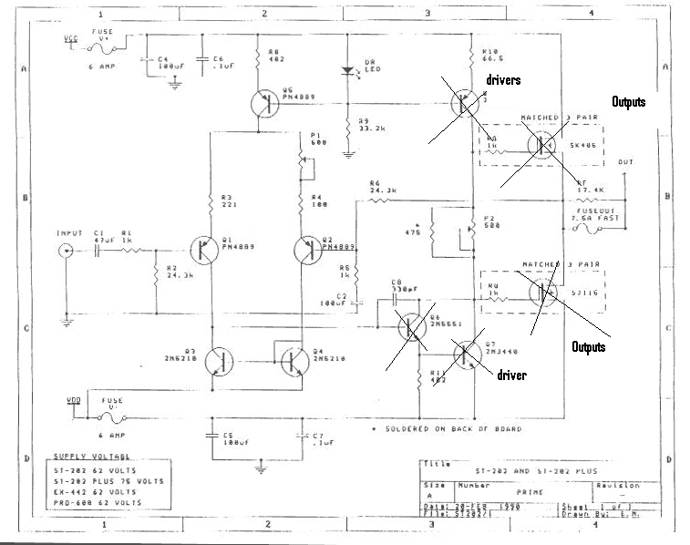

I have a really clean wonderful sounding ST-202 Plus. Only problem is there is a low level hum in the transformer ... not through the speakers.
When I first got the amp, I powered it up (unconnected) to check dc offset. DC offset was around 160mV on one side and close to 240mV on the other. Didn't take much to dial P1 trimpots down within spec. At this point, it had the hum.
Then I hook up to DBT and variac, power up, no hum. What??
I haven't checked bias. But when I hook up the amp to preamp and speakers, I get the hum again. So it is only when the amp is connected.
Visually, components look good, with no bulging caps or signs of overheating. As I mentioned, the sound is really nice.
Any ideas where to check, if not bias first?
[ UPDATE ] The amp is fully functional now! The culprit turned out to be a loose end of the R channel fuse holder on the PS board. I deeply appreciate the help of forum members to help, especially Chamberman!

No. B&K instructions include some items I don't have. For instance, they say to place a current meter across the fuse clips, which I don't have. Then connect an 8 ohm load to each channel and supply an input signal of 100 mV RMS @ 20 kHz ... I don't have the setup.
you can weld a 10 ohm resistor on each positive rail fuse dc of the power supply and then measure the voltage drop to transfer this resitance and then deduce the current.
or weld a 10 ohm resistor on the bias adjustment potentiometer (between the base and the brush) and measure the voltage drop across this resistance
or, if you have an ampere meter, you remove a power supply fuse and then replace the fuse with the dots on your multimeter to Ampere dc

Here's the reason I don't think bias is at fault here, and speaks to the inherent ground loop problems sgrossklass mentions.
The power cable on the amp is two prong. My DBT and variac are three prong. When the amp is plugged into those, there was no hum.
Second of all, the heat output on the amp is good, not what I would expect if the bias were too high. And as I mentioned in my first post, the sound I'm hearing is blowing my mind ... I didn't expect it to sound this good. I ran the amp playing a few cds with different types of music from low to high volume levels. No distortion of any kind. Just clean sound.
I'll use a different set of interconnects (Canare LV-61S coaxial) from the preamp, that I can twist.
I don't have a female to female adapter, so I can try sgrossklass' other test.
If I can't get the hum down enough, I'll consider the last suggested modification of moving one or both rca jacks, and rerouting ground returns.
I appreciate the input guys! I'll report back as I am able to get updates.

I forgot to ask. Anybody know where I can find the schematic? Hifiengine doesn't have it. Only a sheet on setting bias and dc guide.
