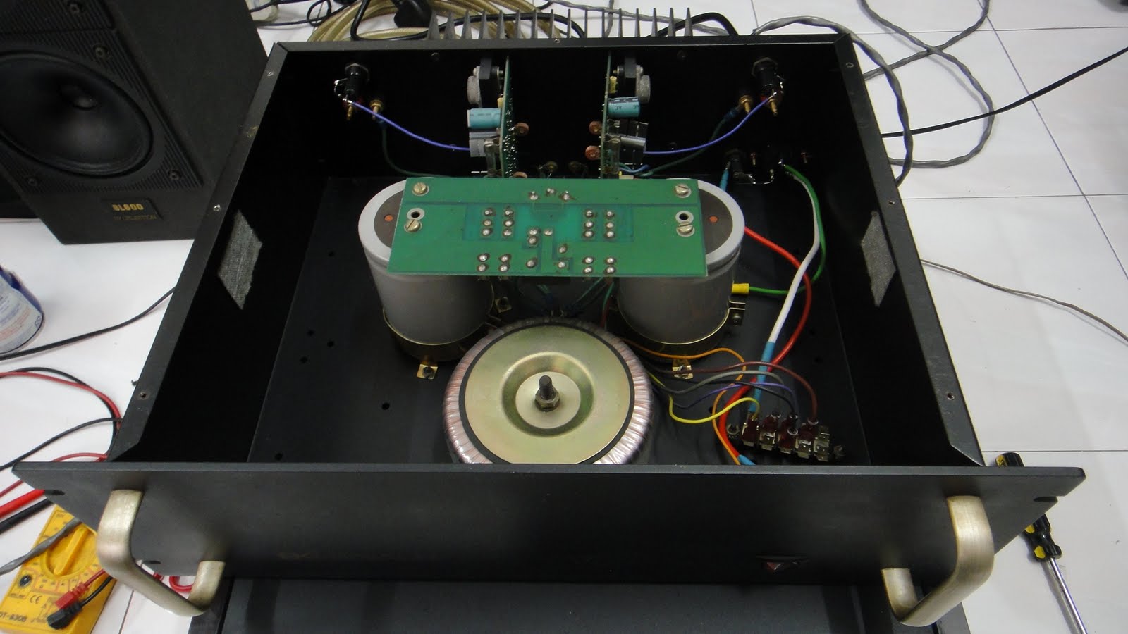

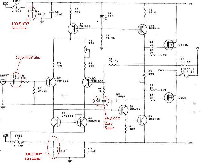

B&K ST-140 schematic
This one needs a lot of tweaking to perform high end
A very big and heavy empty box.
good luck!

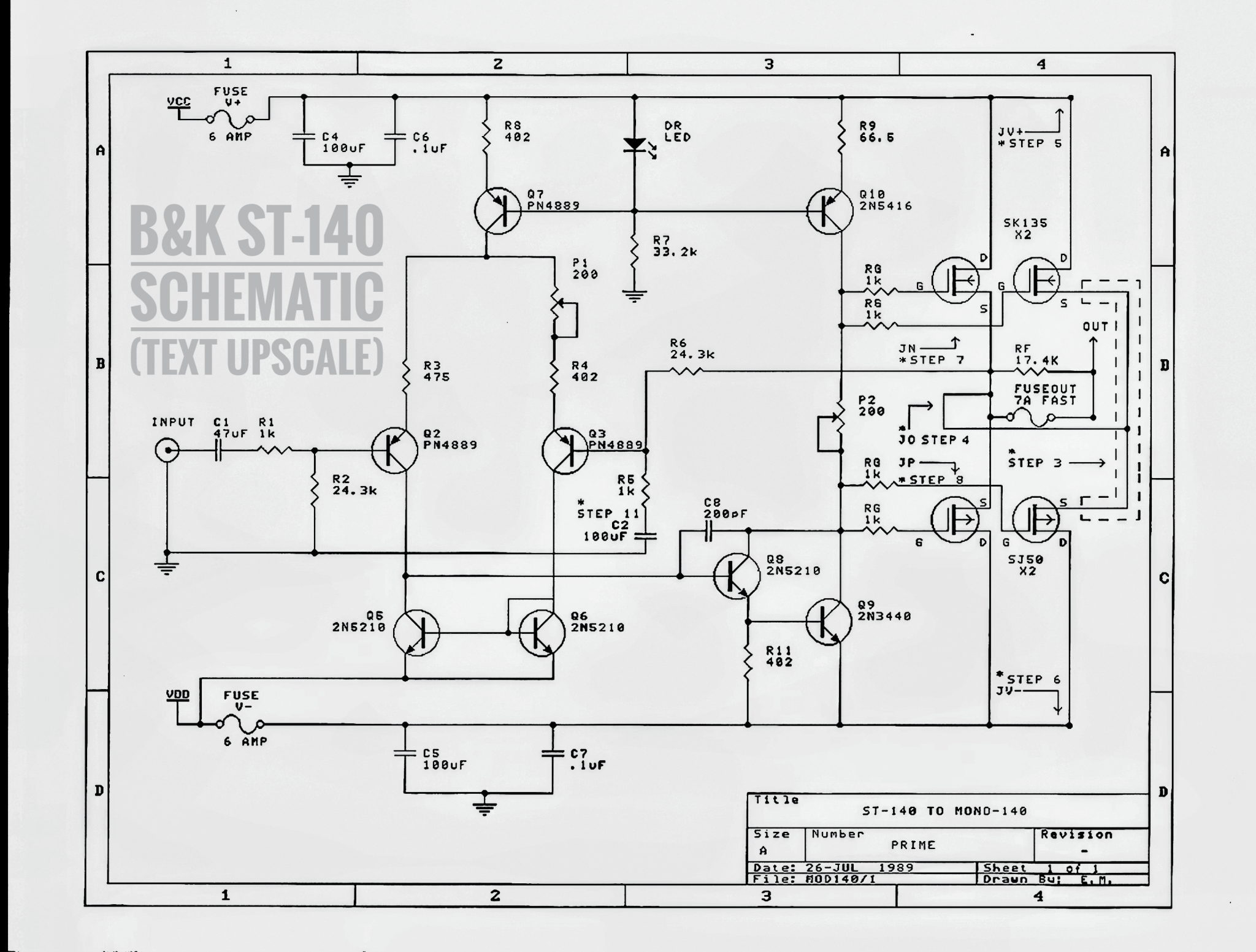

For anyone needing a schematic of roughly the first several production runs of the ST-140 (pre-1990). I went ahead and upscaled the text and image contrast for easier viewing.
I also have the post-1990 schematics and write up as well if anyone is looking & interested. Message me if so 👍🏻

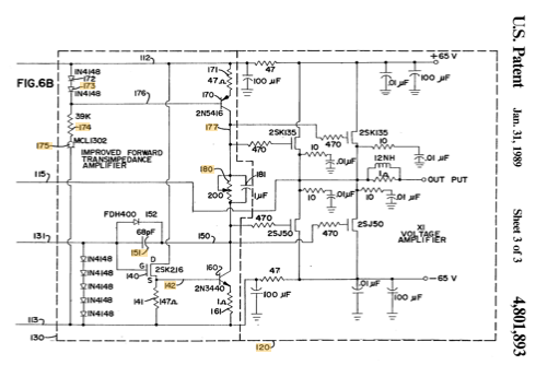

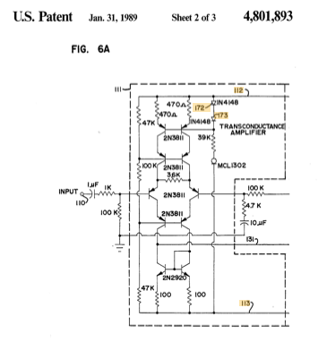

I dare say from Kevin O'Connor's description from above that the original B&K ST140 was a copy of the Van Alstine mosfet amplifier, for which a patent was granted. I seem to remember a bit of a stouch between the parties over intellectual property, which may have resulted in B&K changing there design to a simpler front end (as shown) when Frank threatened to sue. I have included the patent schematics which pretty much align with Kevin's description. It is interesting to note that B&K went back to a similar complex front end in their later models such as the ST202+ and the EX442. Also at the time Trevor Lee's imported or used (perhaps without permission, Trevor was always cagey on not showing the schematic, his tech Dallas did though) Frank's boards and built up amps here in Australia, calling them the Transcedence Series. I had two mono amps built using the boards with a 625VA transformer, 3 pairs of outputs and 120000uF of PS caps. Drive anything but it still didn't have that special something that some tube amps convey, so I sold them.
