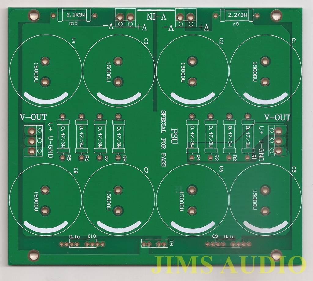

Let's get this show ( your build ) on the road and later talk about something else, my power supply board arrived today and is damaged so it's going back... can't get a break...

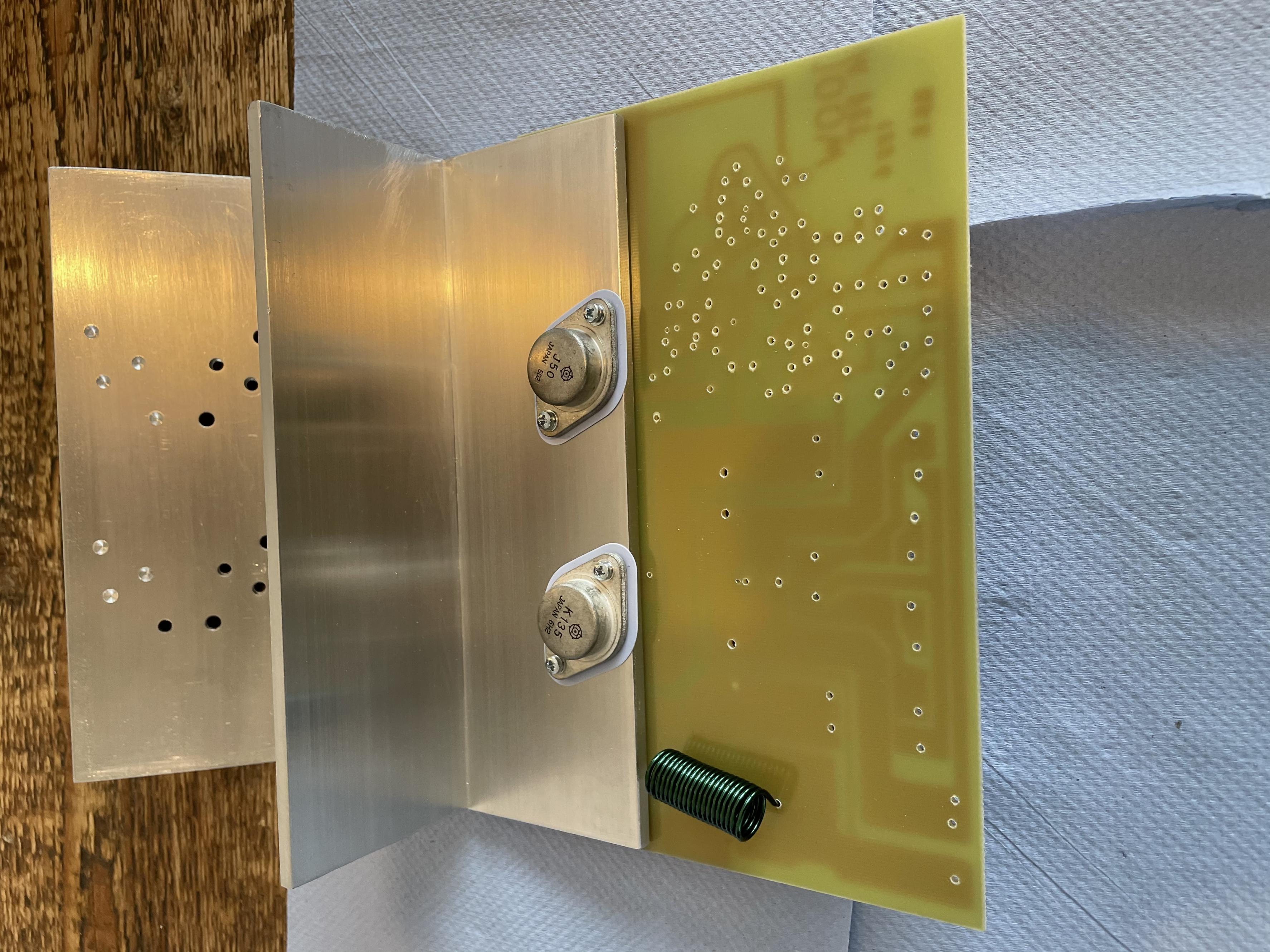

Got it right this time. Should think the heatsink bit over kill but should do the job. Decided to do a new inductor slightly longer but about 3mm in diameter smaller so getting same resistance.
I think also as you mentioned I’ll lose the base plates and run the heatsinks along the middle bit like your rocket ha.
I’ll have to make up a new heatsink for other side. More work ew. Good fun though.

Aw nightmare that really grinds me when that happens. You wait ages and one it don’t turn up or damaged roar. Then all messing around to get replacement.
I bought this one from an UK seller because it was national so quicker to delivery but no it tuck 2 week to get here and on top of that damaged.
I should had gone with the one from China but I didn't wanted to wait...
It probably would have been quicker from China. The longest I've ever waited is 2 weeks that's economy shipping.
Where's all the heatsink goo?
Looks good.
