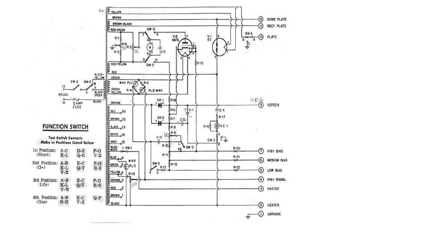

I recently acquired an old B&K model 500 tube tester.
It has several issues, and I am trying to figure out if it is worth salvaging.
It has two loose sockets, which I can replace.
The main problem is every tube I test comes up as "?" on the Gm test.
Every tube lights the neon short indicator very dimly.
The manual and schematic I have shows a 6AT6 and an 83 tube.
There is no calibration procedure.

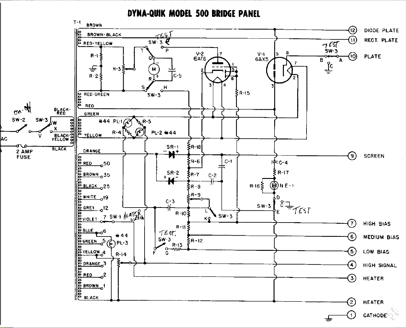

Finally got my hands on the proper schematic, with the 6AX5 replacing the 83 tube.
I have two burned up resistors in the voltage bridge for the bias circuit.
The schematic only lists R numbers, no values.
So we have
R10 - ? 10 M ?
R11 - 1K
R12 - 560
R13 - burned to a crisp
If anyone could please tell me the values of R10 and R13, I might be able to salvage this tube tester.

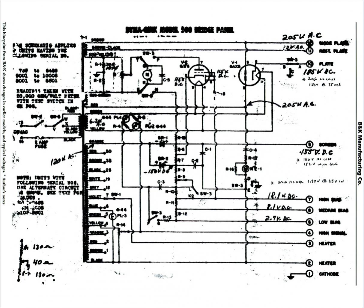

A late reply but just in case someone else finds this thread.
I was going to build my own but life changed all of that and I finished up picking up a B&K 500 that I am restoring.
The schematic for the 6AX5 is almost identical as the one with the 83 tube. It is best to modify the 6AX5 version to one that mimics the 83 version as it is more accurate. Obviously the transformer does not have a separate filament winding for the 83 and the solution is to replace the 83 with attached rectifier schematic. (It took a year for someone else to come up with that solution.) Then add three resistors in the high, medium and low bias connections.
I've also attached the notes that I made while searching for more information, enjoy.
