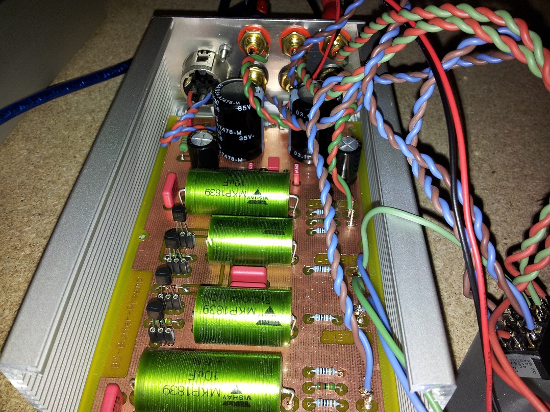

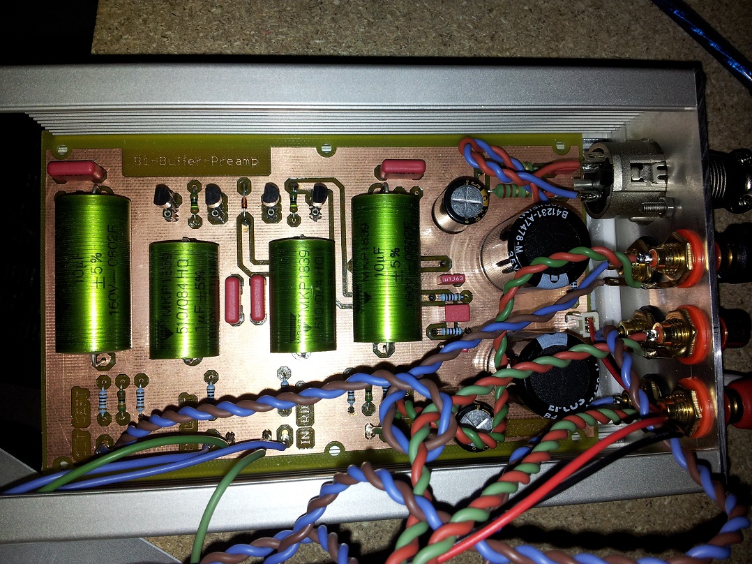

I've just finished my new B1. Schematic taken from Passlabs. But there is only dead silence at the outputs.
Here is the schematic:
Here is my layout:
I can't find any mistake... So please anyone help me with this problem.

Oh... I took some voltage measurements. VCC behind the smoothingcaps is 18,68V. I used 2SK170 as mentionend in the Passlabs article. No matching. I only want to see if this gem is working. But it won't make any noise.

Yes, the photos of the preamp are visible. 🙂
Looking at your layout it seems that you have the signal going to the source of the 'top' transistor. I could be wrong, it's hard to see.
Check your transistor layout.

Hi xandrell,
Is far as I can see, you used the pin layout of the IRF 610 or IRF 9610 were the gate is on the left side looking on the front of semiconductor, where the words are, but Sk170 has the gate in the middle and the drain and source outside.
So check your j-FETs and solder them new twisting the legs!

Yes. You both are right. Had this idea while sleeping ;-) I will try to fix that. So pin1 goes to slot2 and vice versa? 3 stays at slot 3.

If the board was designed for IRF610, then yes, you need to get a bit of teflon tubing and insulate a lead or two and cross the legs. 🙂

Pin 3 to slot 3, isn't then the drain of J-Fet connected to the source place of IRF holes? 😀

Updare... After twisting pin1 and 2 and rotating the hole mosfet... Well... It works ;-) No audible hum at the output... Only that what you give him. But i have one question left: is there a possivility to raise the gain just a bit? Let's say about 3 or 6db?

Here's a pic of it running:
