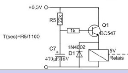

I use this. Runs off any heater winding, but the output is isolated through the relay. Use a good solid tantalum for C3 and the timing is very consistent. Easily settable from 1 second to a minute. Automatically resets upon loss of AC.

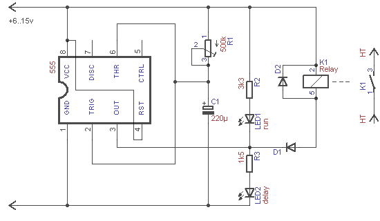

This is what I use, it's very easy to build and reliable.

The 555 timer circuits shown above are clean, noise wise. Firstly the device is a simple analogue timer, and secondly the only possible noise that it can add is at the instant that its output switches (i.e. before the amplifier is able to amplify anything). After that it is an entirely static device in these configurations. In these circuits it will create no more noise than a thermal timer, but with less heat.

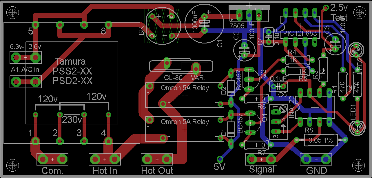

My timer. It switches on the b+ transformer in my GM70 amp. The pic micro is programmed for a 10 second delay on the first relay then 1 second to the second relay (slow start) then it waits 1 second and monitors the current through the GM70 via 0.05 ohm resistor. The voltage at the 0.05 ohm resistor is amplified by the INA122. The INA122's output is varied via the pot and I set it at 2.5 volts for the pics A/D converter. It will shut down in either an over or under current state.

How would a 555 in monostable mode cause any sort of "digital" noise? 😕

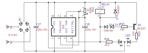

Or this one, using a single dual cathode red-green LED...
Btw, what's the point of all those leds? I mean, you could just wire the output through a resistor to base of a PNP transistor, which acts as a switch for the relay.
You can drop the LEDs, they are there only to show the delay/run status. The extra transistor in the second circuit is for the common cathode duo-LED, which cannot be driven by the 555 alone.
The 555 can drive most relays on its own, no need for an extra transistor. The voltage at its output is 2/3 of the supply voltage - that means you can use a 5v or 6v relay with a rectified 6.3vAC (8vDC) supply, or a 12v relay with a voltage doubled 6.3vAC supply.

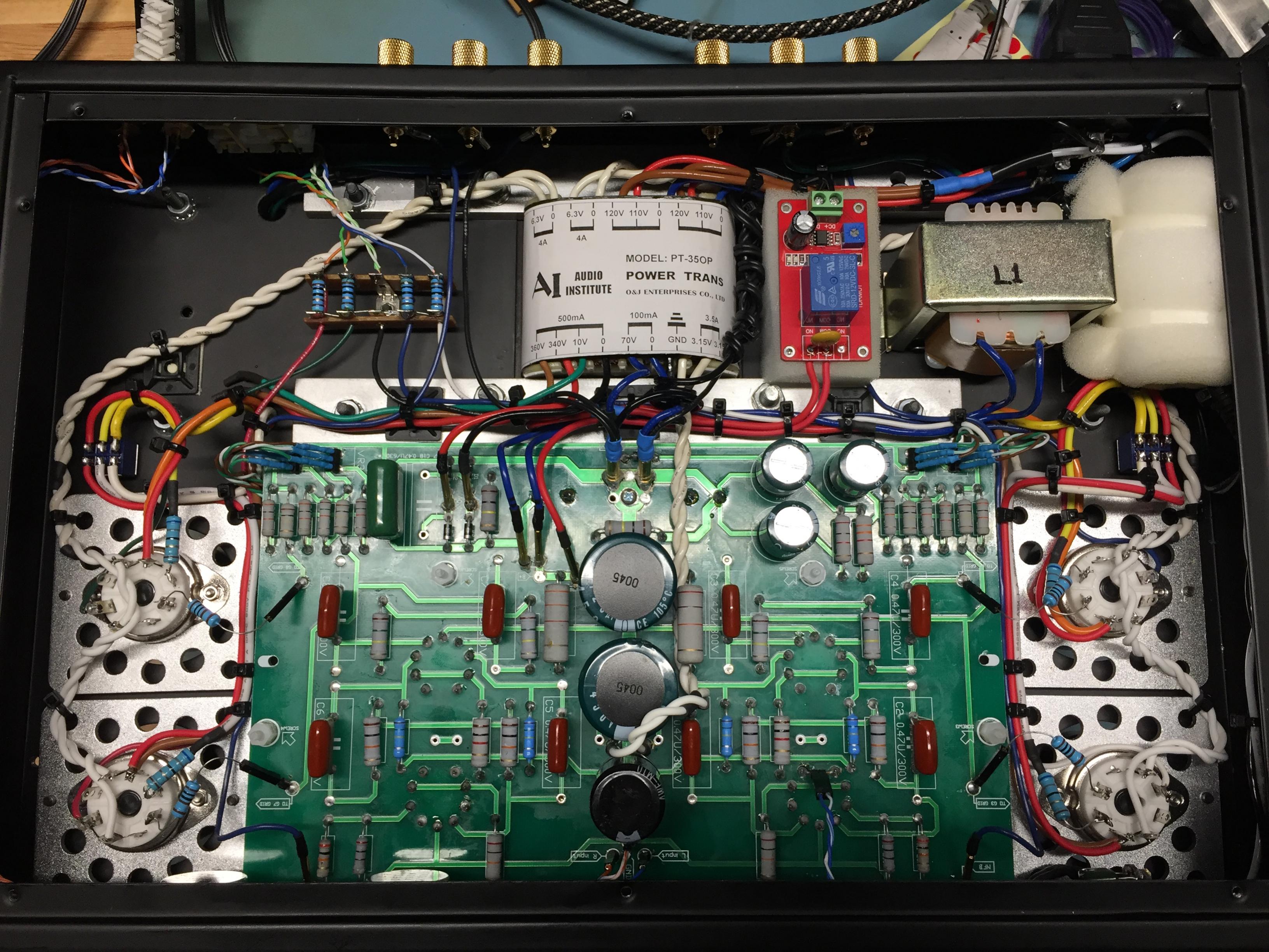

Ive recently retrofitted my VR-110 amp with timer delay circuit purchased from Amzn (https://www.amazon.com/gp/product/B0126WT5QO/ref=oh_aui_detailpage_o04_s00?ie=UTF8&psc=1) and double the cap value in order to extend timer delays upto ~90sec (default ~30sec). For me I wanted to prolong the life of expensive output tube so switched B+ is only feeding to output tranny. Only other modification was adding 0.01uF, 1000v cap for switch from arcing. It's been working reliably for last few weeks so only time will tell how long the relay will last.
