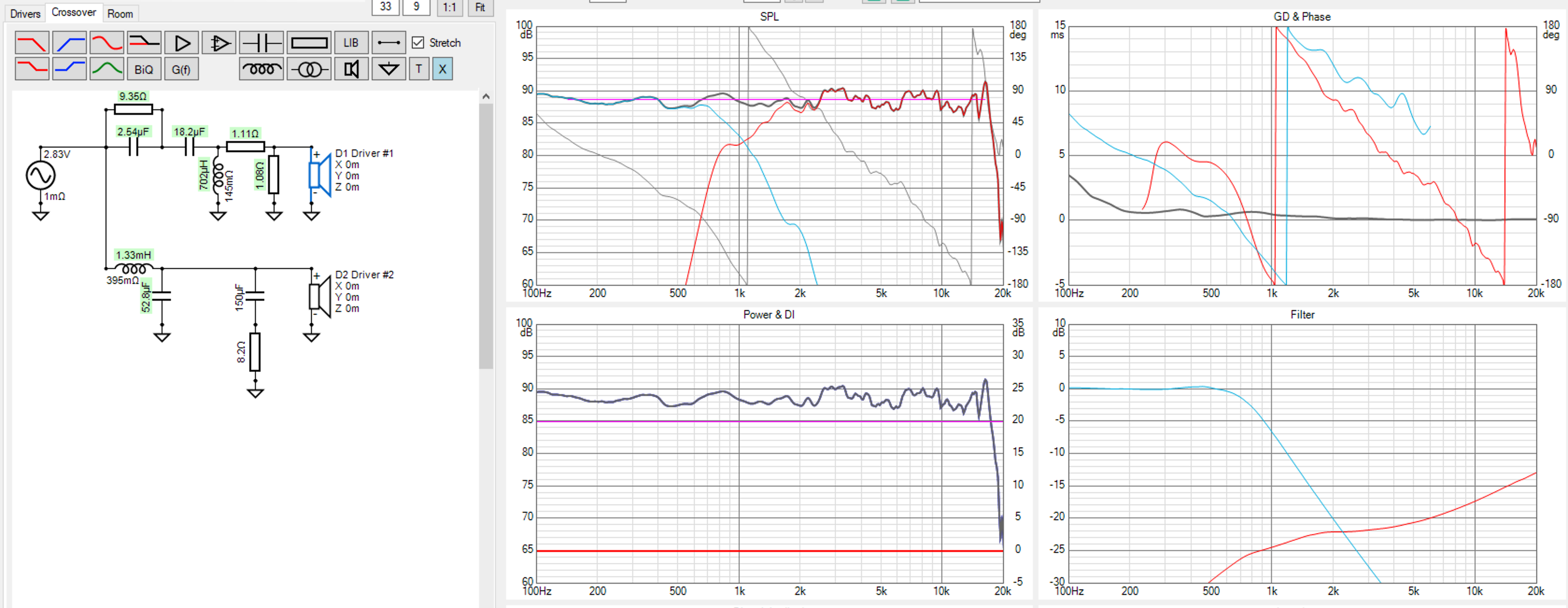

800 Hz is no problem for home use 🙂 That's also where Geddes crosses his designs with the DE250. Here's a smaller XT1086 with much less low end extension crossed at 1 KHz (see attachment). Almost 25 db down at FS

I couldn't find any info from PI Speakers on it. If crossing to a 15" woofer, then yeah it's not gonna hold directivity low enough to match. Looking at plots its about 120 degrees at 1 KHz, so a smaller woofer should work.

I'm most confused by the differences in low end extension. It's down a whopping 14 db at 600 Hz in Michael Chua's measurements compared to 1-2 db in the ones from JustDIYIt. A whole lot more than can be attributed to mounting differences.
