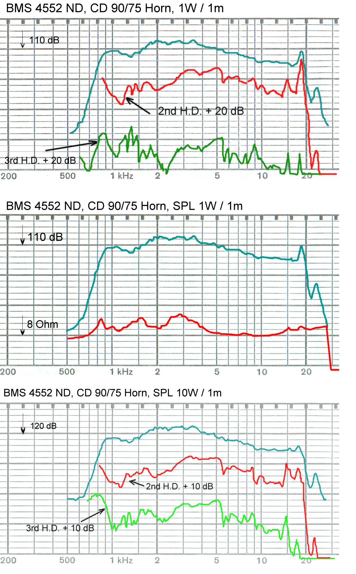

Can this really be a good driver for use on a constant directivity horn?
It's down to 100db/1W at 10kHz on the tractrix horn used for testing. Even with its massive power handling, after the necessary EQ it seems like it would be nowhere as loud as a garden variety compression driver. Or am I missing something?
That's a valid observation. Here's a BMS 4552 for comparison:
We're dealing with the "Magic Triangle" of compression drivers:
1) you can make it affordable
2) you can make it efficient
3) you can give it a wide bandwidth
pick two.
There's an interesting new family of compression drivers from B&C, BMS and JBL that use unusually small throats, and it seems to increase the SPL above 10Khz. For instance, the BMS 4538HE produces something like 110dB at 20khz with one watt!
Whenever I'm building a speaker, the tweeter usually ends up being the weak link for me. So I'm eager to me dated with a set of these.
Unfortunately, there's still no free lunch. Power handling is just 25 watts. But the BMS produces more output above 10khz with 25 watts than the Faital does with a hundred. Of course, the Faital plays lower though.
Decisions, decisions.

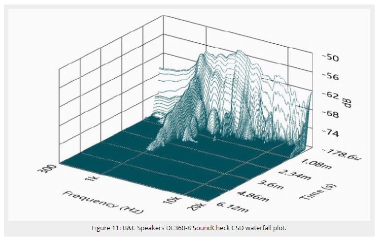

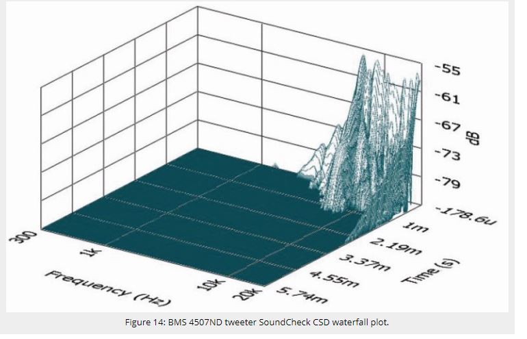

Since nobody is responding to you I'll take a shot at it. Since we don't know much about the B&C DCX464 I can look at something similar which is the BMS 4507ND. The problem has always been with the co-entrant design where the high and mid frequencies have to combine somehow without causing the high frequency wavefront to encounter an abrupt physical change in the pathway curvature. Usually the high frequency sound wave has to "jump" a physical gap. This causes higher order harmonics to form which effects the performance of the driver in the time domain. Evidence of this can be seen in a CSD waterfall plot of the BMS 4507ND compared against a regular compression driver such as the B&C DE360. As you can see the DE360 exhibits much better Spectral decay performance than the 4507ND.
I hope this helps!
The attached images were pulled from the following links...
Test Bench: BMS 4507ND Dual Diaphragm Coaxial Planar Wave Driver | audioXpress
Test Bench: B&C Speakers DE360-8 1” Exit Pro Sound Compression Driver | audioXpress
