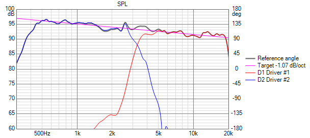

Hey guys, just wanted to say the issues I was having with the dcx464 being crossed at 3kHz, vs the 4594he at 6.3kHz....appear to be solely about my fledgling synergy attempts.
As I'm slowly ironing out the synergy build, the dcx464 keeps shining brighter and brighter🙂
I'm almost ready for trying to find crossover sweet spot....I think I saw in Voice Coil, that Bennet P. mentioned it being around 4kHz.

Nice first cut...especially with passive.
I started at 3.2kHz and moved to 3k, due to off-axis measurements on synergy attempts.
None of the measurements I've made would seen to support 4kHz over that range.

I'd guess Bennett's suggestion is based around a full DSP solution. That would simplify the design significantly and maximise driver output, which is paramount in prosound. My design is for a commercial domestic HiFi system.
My first cut at a passive X/O came out a bit lower than that.

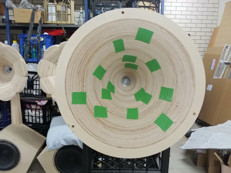

William, what waveguide you used?
This:
It's 480mm dia and 250mm deep, CD.

Whats the XO used for this!?!
Designed specifically for the horns pictured above. The key component and the trickiest to get right was the notch filter on the top end of the mid drivers response. I spent quite a bit of time finessing that area to get the phase response at crossover correct.
This is not a driver to learn passive crossovers on. If you are not experienced in passive crossover design stick to DSP.

Pretty hard distortion spike on midrange at 2k
