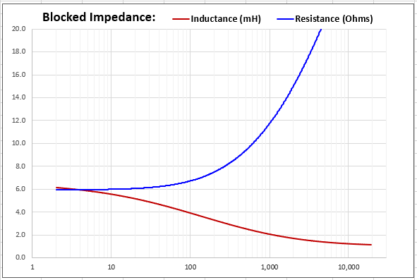

See attached. The red line shows how the inductance of the 21SW152 varies with frequency (based on extracted impedance data from its published impedance curve).
Good find Brian!
I am going to save that graphic .... I have been trying to find more good examples of inductance curves ...
Once the manufacturer publishes an impedance curve, it's not that difficult to use a tracer to generate a ZMA file from that curve, and then the semi-inductance spreadsheet can be used with that data to generate the inductance curve.

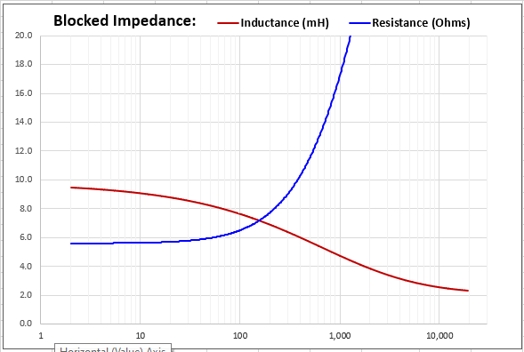

..and here's the curve for the 21DS115. The inductance is significantly higher than that of the 21SW152 at lower frequencies.
Brian Steele: Yes. I used semi inductance parameters. Compared 21DS115 with 21SW152. 21DS115 was affected more, but basically, it didn´t do much to the simulation, which would push one to consider that 21DS115 is less efficient or has weaker motor.
I certainly do not disagree on the presence of inductance. But its effects on efficiency are not significant enough. Or at the moment it seem to not be the case.
