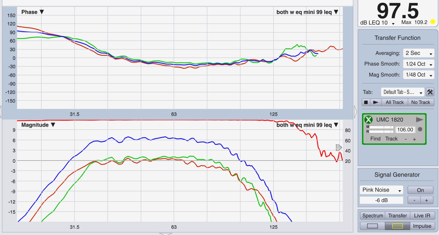

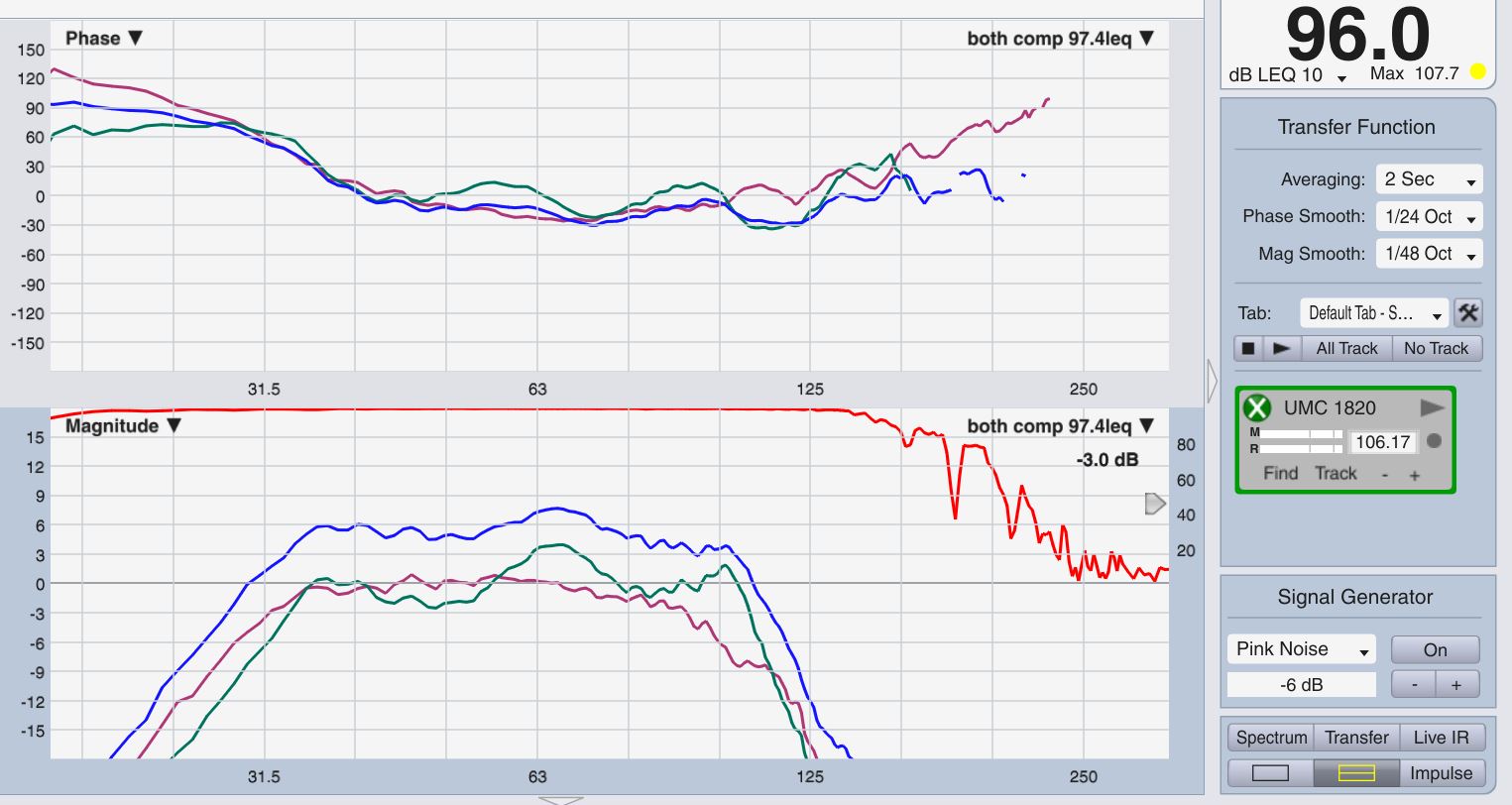

I've had very good luck mixing subs with different drivers, and even different box types...... sealed, reflex, and FLH.
But I always use a crossover at 100Hz and wavelengths are long enough to accommodate phase variations and still provide good summation.
If crossover was higher I can see how different subs might not work so well together.
I also use the same crossover topology...that is, the same electrical LPF to the subs.
This seems to matter the most on the high end of the subs' band-passes, dominating driver/box differences.
On the low end, where the HPF's are in place, it sometimes takes a little juggling to get things right...but the savior is the really huge wavelengths that provide a lot of tuning room.
Bottom line imo, is how well do they sum... how close do they sum to +6dB through the pass-band when measured side by side outdoors, both separately powered.
Indoors? I'd mix drivers/subs in a heartbeat....
The second you put a sub indoors, you've already mixed multiple subs... with all the virtual subs created from room reflections.
This soooo dominates drivers, parameters, even box types etc, ime.
Below is a couple of different subs measured outdoors for an example...
green trace is a really high mass prosound single 18" in a FLH.
Red is a single 18", lower mass, in a bass reflex.
Blue is their summation.
Same linear phase HPF and LPF on both.
First plot is with no EQ on FLH sub or reflex
Second is with EQ on FLH sub to make judging summation easier.
