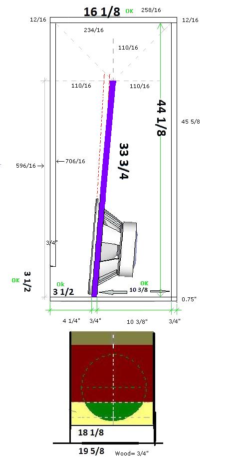

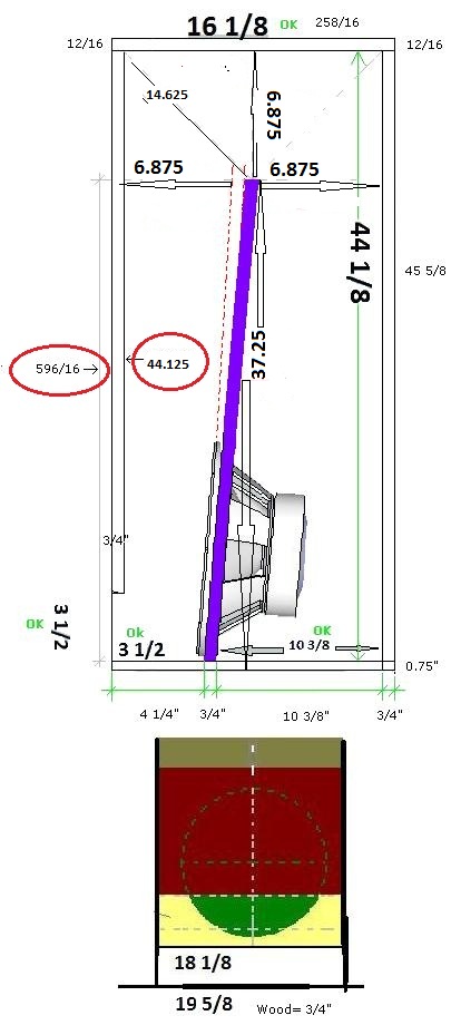

i would also like to draw up the measurement for the double driver cabinet. Some of your example please.

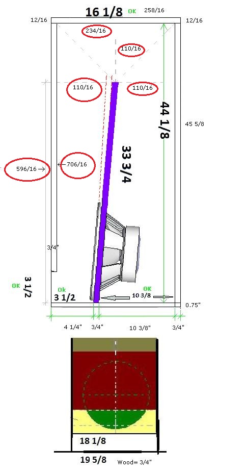

What does these circled measurement represent.

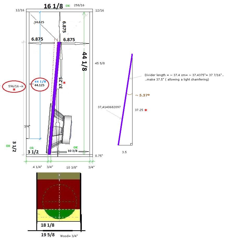

Bjorno can you tell me what are the circled measurements for is it 110/16 or 1 10/16
Hi,soundhead,
Admit this is confusing. All numbers are in 1/16" notation ,i.e. 110/!6 is = decimal equivalent to 6.875" or 6.875 x 2.54= ~17.5 cm
No danger to round up your built numbers an 1/8" off or even 1/4" wont be noticeable affecting the final performance.
