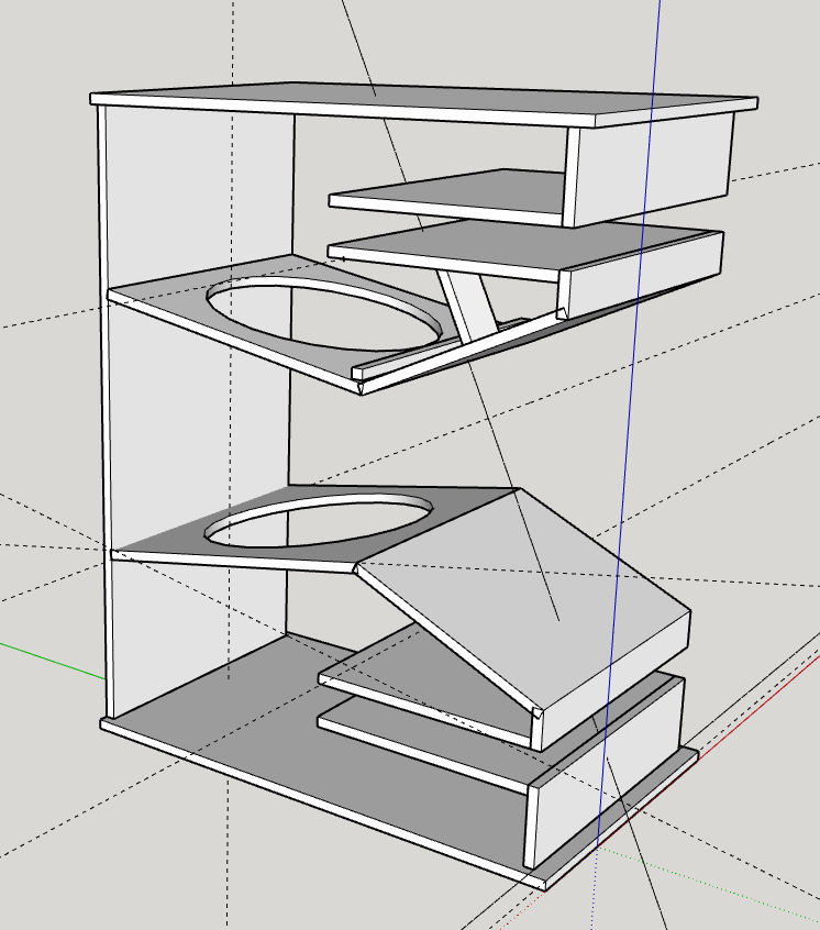

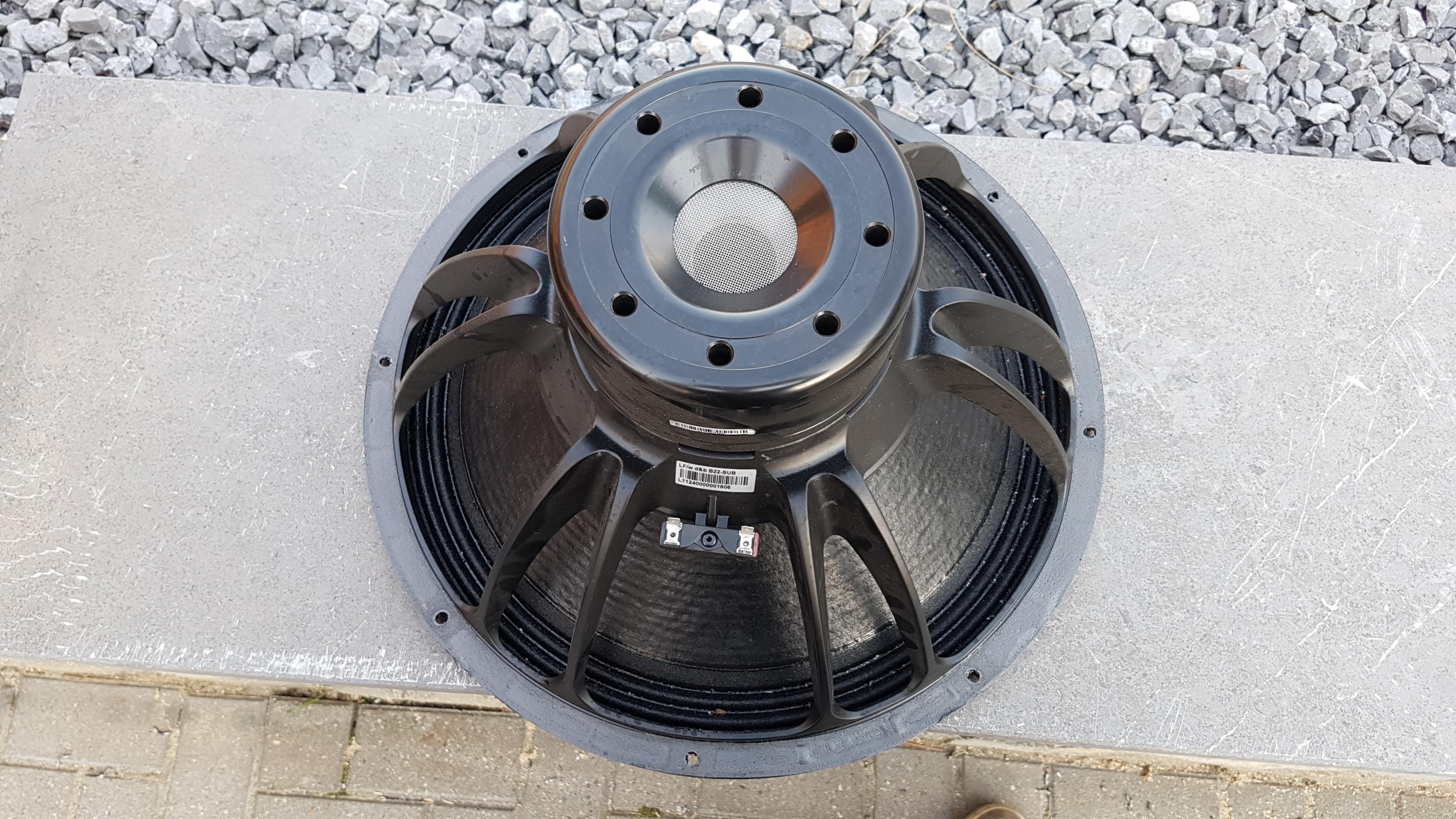

Hey,
can you take a look at my design?
it is a D&B B22, in my opinion there is original a B&C 18SW115, 8 ohm, 18 inch in the case. (maybe Custom one)
Do you happen to know if that info is correct?
Now I saw that there is a new speaker from B&C.
namely the B&C 18DS115, 8 ohm, 18 inch
according to the B&C site, this would be an improved version.
Can I order and install it?
Or better buy the 18SW115, because that's what the speaker cabinet is designed for.

Remy,
I don't know if the D&B B22 uses an actual B&C 18SW115, or an OEM driver that looks similar.
The B&C 18DS115 had not been released in 2016 when the D&B B22 was.
Although the B&C marketing department says the 18DS115 "high energy subwoofer is a significant step forward from similar models in the B&C range", though it has a longer aluminum voice coil, it actually has less Xvar than the 18SW115, and a number of TS parameters different from the 18SW115 that may not be an improvement in the big bandpass box.
I've yet to hear any reports of actual comparisons of the different drivers in the same box. B&C shows the 18DS115 in a smaller box with a higher tuning on the data sheets.
The DS has a significantly more motorstrength, it is a diffrerent solution compared to the SW, not sure if part of the difference in Bl stems from that the SW has a variable winding density to flatten the Bl curve and the DS does not, either way, being a SW user my self (15") I could not be happier, very detailed and precise low end, perhaps the DS is even more of the same, but the results are of course also hugely impacted by the loading type (enclosure).
The 18DS115 is rated for the same power as the 18SW115, and has only slightly more Xmax, but less Xvar.
