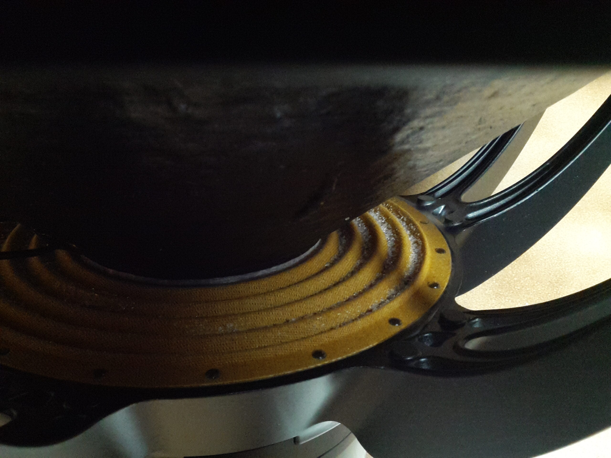

Hello,
i acquired a new B&C 18SW100. In the attached picture you can see the colourless substance in question (probably silicone). It is unevenly spread, being mostly in the grooves of the spider. I assumed that coating should be a smooth surface instead of this sprayed-on mess of spots. I would like to know if this is normal.
Thanks for taking your time and kind regards,

As EPA noted, the silicon bubbles seem to be apparent on another B&C driver.
I only have a pair of B&C18SW115-4, don't recall as many bubbles as in your photo, but I doubt they would make much, if any difference in performance.
Do some free air tone sweeps starting conservatively and up to around Xmax in the 30 Hz range to make sure there are no buzzes, if there are, submit for warranty repair/replacement.

it IS silicone. A few other manufacturers are using silicon doped spiders to help achieve their desired stiffness. It likely is "evenly" applied, except the part that seems to be missing is probably on the underside within the rolls that appear "upward" in that orientation. Upside-down, the peaks then become valleys.
Looks to me like they spray coated the spider. Once side A was done side B was sprayed forming bubbles between these two layers. It's more of a cosmetic issue more than anything. I don't doubt they have addressed this Q already through QA, simply so people would stop asking 😉
That is their special technique which they expertize in. Not only them, RCF & 18 sound too. They call it the "double silicone spider". They do it in- house. It has a vital role in the overall build design of the speaker. Visit their site to know more.
That arrangement has a vital role to play in the overall compliance, dc-offset & voice-coil rest position & also in the cooling system of their voice coil and gap. 18 sound has gone further and introduced triple silicon spiders in some of their current drivers.
The uneven distribution of silicone which you see across the spider top surface has nothing to do on its behavior. The real area between the spiders has that required uniform coating. The outer uneven silicone you see is the excess silicone which leaks or pop's out from the spiders fabric mesh.

The silicone is mainly used to dampen the spiders. In the past non-hard resin (not sure if this is the correct English word) types were used but these suffer from aging, are not heat resistant and can be anoyingly sticky. By impregnating you increase the contact surface between the fibres of the spider-fabric and the silicone, which result in better damping properties compared to (surface) coatings. Chinese attempts to copy these Italian drivers have silicon coated spiders among other cut-off's.

thanks for all the responses! It did turn out to be quite the interesting topic. I contacted B&C tech support for a clarification and the response was:
"the spider is ok since the silicon glue must flow through the cloth frame. Even if it does not look very attractive, this kind of spider assembly is very effective and mechanically very strong.
Each assembled speaker is tested before shipping, so compliance and resonance frequency is therefore continuously checked during production to assess its conformance to the QC accepted tolerances ( for example Fs must stay within +/- 15% the reference value)."
